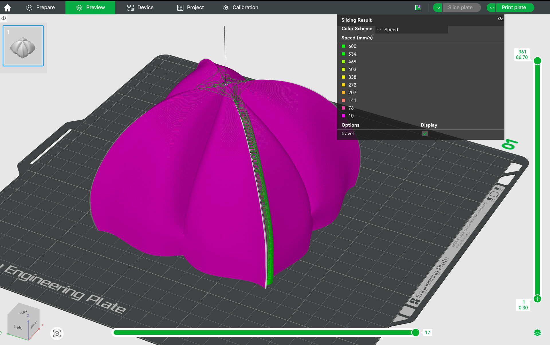

I am pretty new to this print world but not new to making. I have run in to this issue intermittently over the past week or so. thought it was a plate adhesion issue. so CLEANED like crazy! did nothing. oringally it was heavier texture on the right half of the plate so adjusted the level on the bed it helped but did not make it go away. tried a engineering plate with liquid glue and the first print was fine the bottom layer on the second print has the same issue of rough texture. As you can see in the images the center and the shell lines are smooth. the entire surface for this print is 125mm. the effect only gets more inconsistent if I move the scale of the print up to 200mm covering more of the print bead. or if I move down in nozzle size to .4mm. seems to me that I am getting some sort of build up of hot filament at the nozzle and it is dragging that around the print plate?? the subsequent layers are print fine it is only the first layer that does this.

Can you post the 3mf file ?
Can you share the slicer previews using the different views related to speeds?

I am more interested in seeing what the sliver shows to see if that provides more information.
Just so you know, the fact you are printing something now, doesn’t mean you can’t do as I requested. Make sure you have saved your current project and then load the original one up to slice again.

Thanks for you help, I was able to repeat what I did in the slicer is this what you were asking for?
I have never thought to open more than one window in the slicer. seemed obvious once I did. I knew that I could work on slicing at the same time as printing, however did not know if I could fine the exact file from that failed print.
just the first layer

Hey Rusty35, 3MF file as requested. sorry to sometime to get back to this and find that file.
