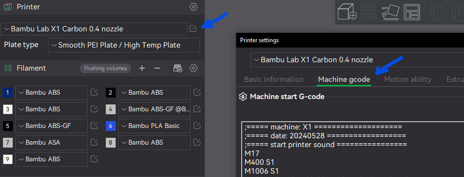

Where do I need to go in Bambu Studio in order to replace the start & end g-code?

I am very new to custom gcode - so new that I don’t know how to send these codes to a machine for print…I can preview it in Bambu studio with layers and paths, but not able to print. Can you provide me some advice how to send it to print?
