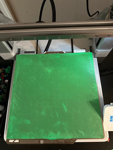

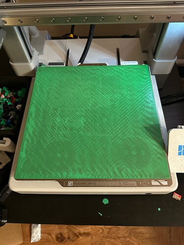

I printed 2 first layer test sheets shown below (one on each side of build plate) using the PETG HF, the filament was freshly dried and came out of the dry box at 23%. Both appear to have good adhesion on the bottom of the print, however the top is very rough with almost a sand paper feeling.

Thank you for including pictures as this is really helpful.
This is generally cause but two factors, poor adhesion or improperly calibrated filament.
Your first picture shows signs of both.
The red arrow points to a very common area to have issues as this is generally where you grab the plate and your fingerprint is left. The other “whitish” areas are also areas where adhesion is a problem.
Your second picture looks better adhesion wise but there is pretty sever over extrusion. To remedy this you need to manually calibrate your filament. Bambu has a wiki article that will walk you through this using Bambu Studio.
I tried the filament calibration. It seemed to help when I reduced it -2.

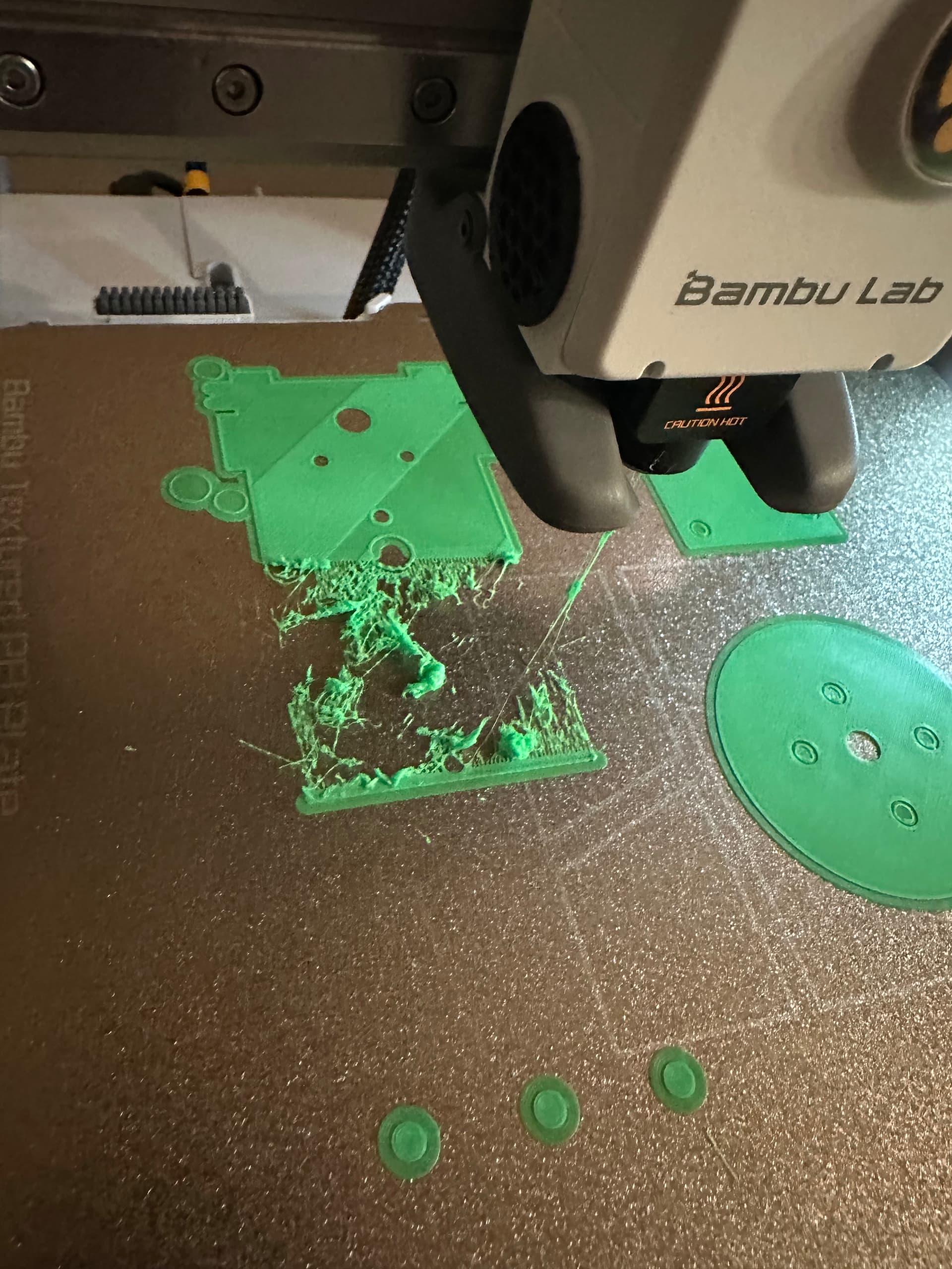

I went back to the print I was struggling with before. Everything looked good for the first 2 layers, which is better success than I was having previously. When I got to the third layer I noticed it clumping up and failing, as shown below.
Between the bed tests in the first post and this I put the filament back in the dry box and ensured it was dry, so I do not believe this is a filament specific issue. Additionally, I cleaned the bed again scrubbing with a sponge and dawn.
The issue seems to occur on larger parts. Specifically more on the left half to 2/3 of the bed. So perhaps I need to try tramming the bed again.

To me the last pic points too nozzle temp issues, causing clumping around the nozzle and then dragging of the laid filament.
