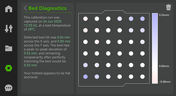

No rules, just preferences.
I always level as part of normal maintenance, typically every 3-4 months. I check the level using the X1Plus bed calibration tool for easy, precise, adjustment. X1Plus also records the calibration history for comparisons, and the very tiny changes over time have never moved beyond whatever is considered to be “flat and level”. I have no reason to think a bed properly trammed with standard methods would change any more.
I will then allow an automatic level on the first post-maintenance print before disabling it for future prints, to save time.
I might also allow an auto-level as a precaution before large prints, or medium-large prints with expensive filaments, after preheating the bed as needed. Usually I forget.
Some users level every time the power is turned back on.
Some users level for every print.
Some users level every time the plate is moved.
Some users level every time a different type of plate is installed.
I don’t find it necessary to level that often, and have never had a print failure because of poor levelling. I power cycle, remove plates for print removal, switch between cool, engineering, smooth PEI, and textured PEI, and do not re-level.
