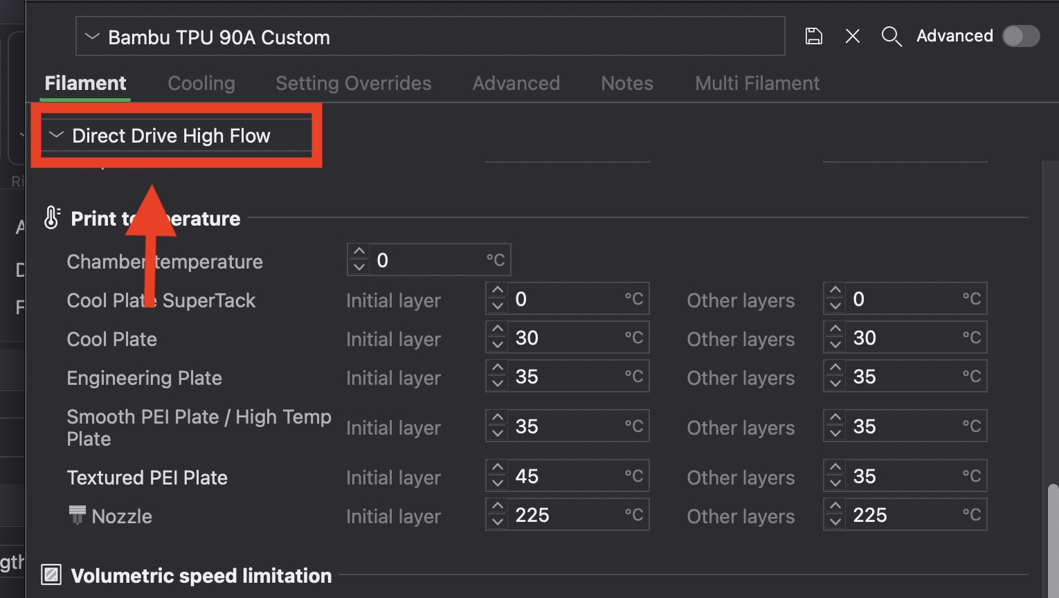

I set my PLA filament profile temps to 60° initial layer and 55° other layers for plate and 230° initial layer and 220° other layers for nozzle. After the first layer the nozzle temp went down to 220° but the plate stayed at 60°. I waited until the 6th layer to see if it was going to change after the bottom shell layers for some reason but it didn’t so I changed it to 55° manually. I was wondering if anyone else is experiencing this.
Today I forgot to manually decrease it to 55° and checked the print at 46% and it was 55° so eventually it does go down apparently but not after the initial layer. Will check next time to see when exactly it does.

Btw I was talking about the setting/destination change not what temp it is exactly after 1st layer:
Untitled01
I also started another print now and the temperature setting decreased as it’s supposed to at the beginning of 2nd layer. So I don’t know , either I did something wrong or I don’t know what was wrong yesterday.
Check to make sure you are changing it on the correct nozzle type as the setting for standard and high flow nozzles are separate even for plates.
