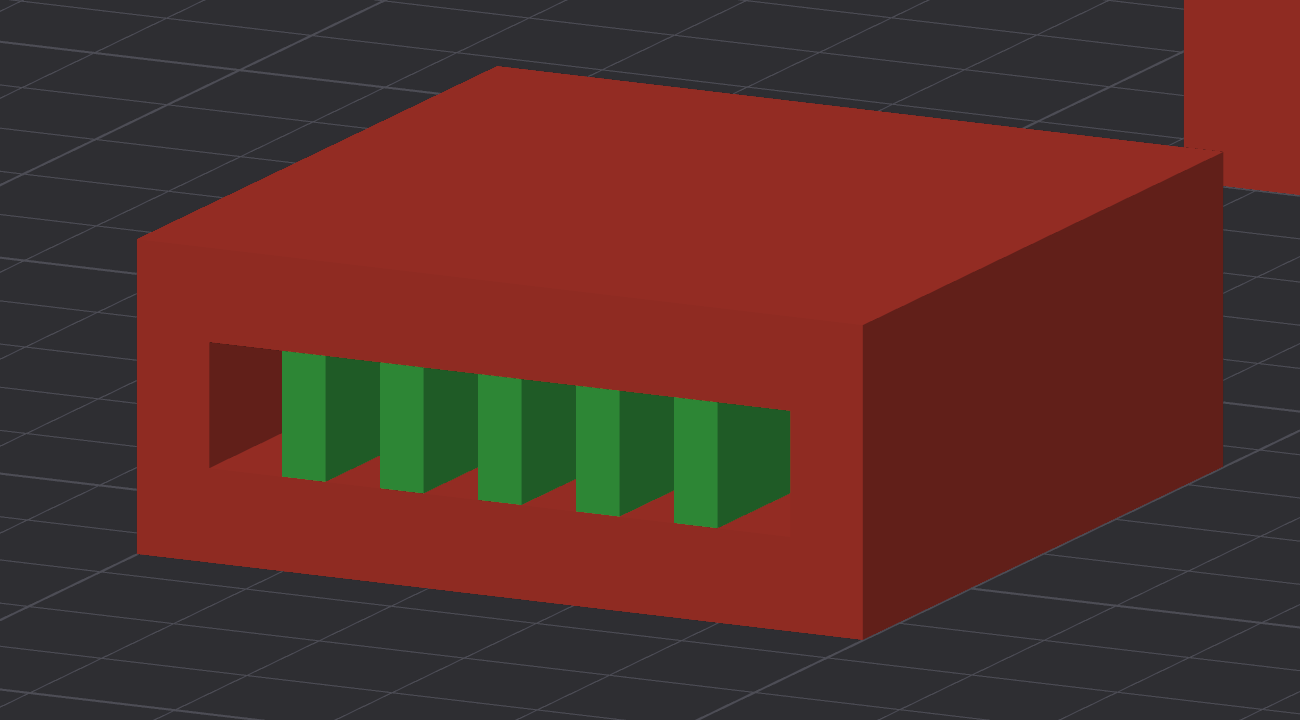

If I print a model in PLA and use PETG only for supports, the bed temperature is automatically set to 70 °C, even when the entire first layer on the build plate is PLA.
I understand that I can manually override the bed temperature for PETG in the material settings, but logically the bed temperature should only match the hottest material that actually touches the bed.
If the PETG support never contacts the bed, the bed shouldn’t heat up to 70 °C. This looks like a slicing logic issue.
This image is a simple test. Red is PLA, Green is PETG. Bed heat to 70 °C. So the PLA is melting on the bed…

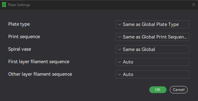

In the plate settings you can define the order of the filaments for the first and other layers.

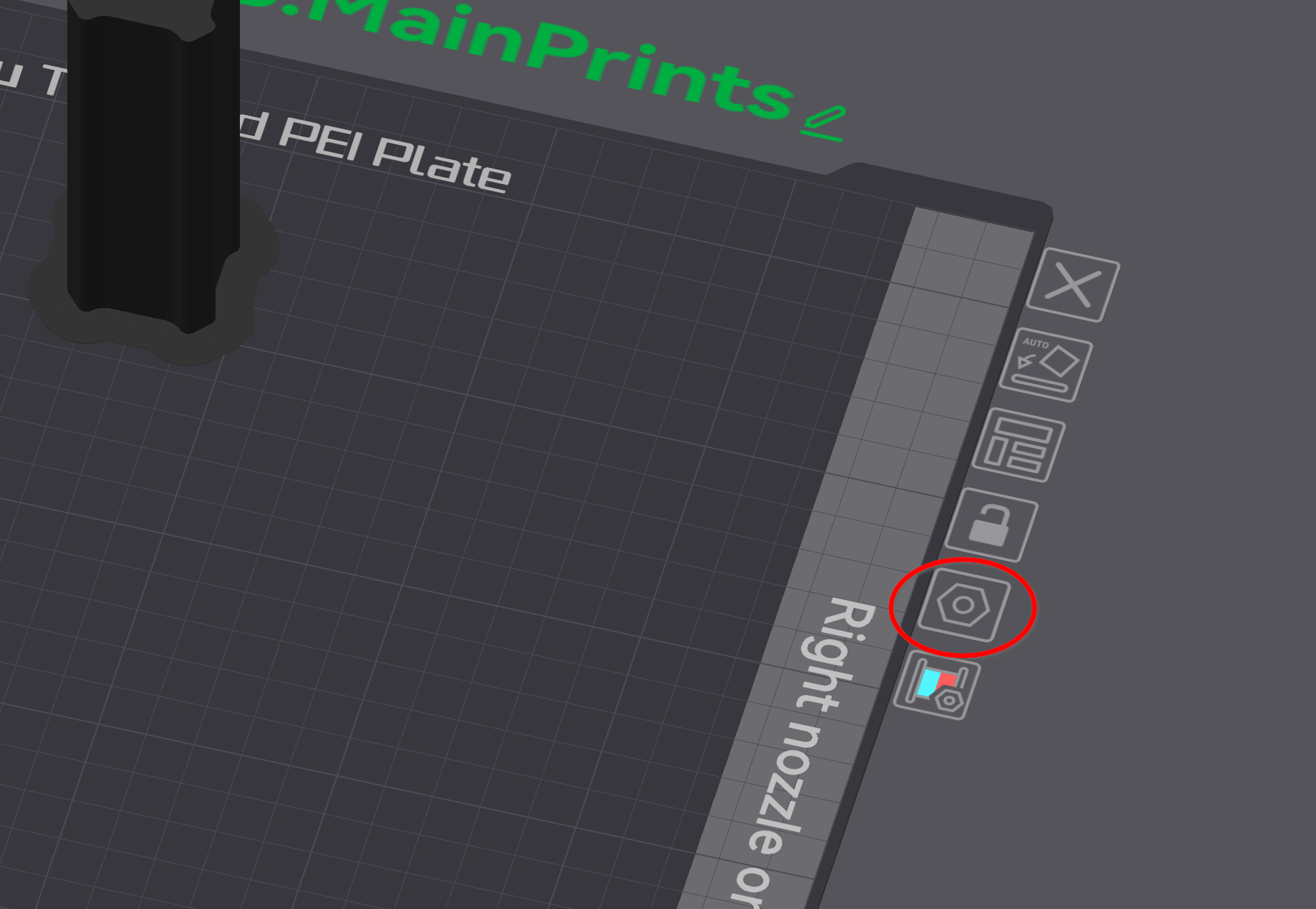

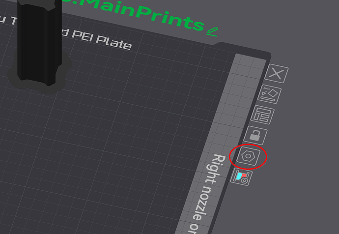

You can find the plate settings under the gear on your plate:
Then the window you show appears.
