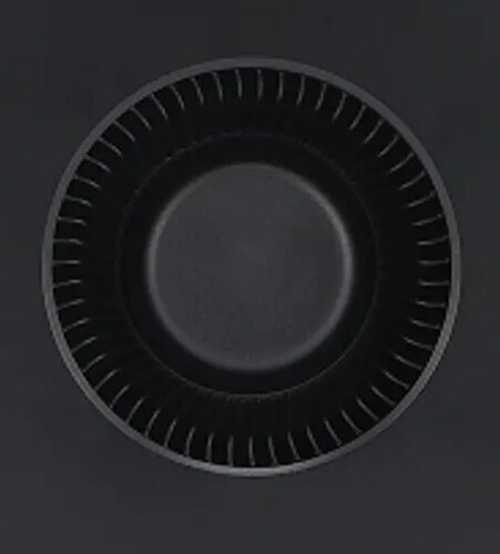

Haha I’m looking for options and I was just on the store to see that the P2S left side fan is sold out :frowning:
Is there a difference between the fan for P1s and P2S? The P1S is available
Im gonna guess it’s minor difference like a bit of foam tape between the fan and duct. I saw a 4 pin fan like this on Aliexpress, that might be worth the risk
I take that back, looks like the fan itself may have differences
