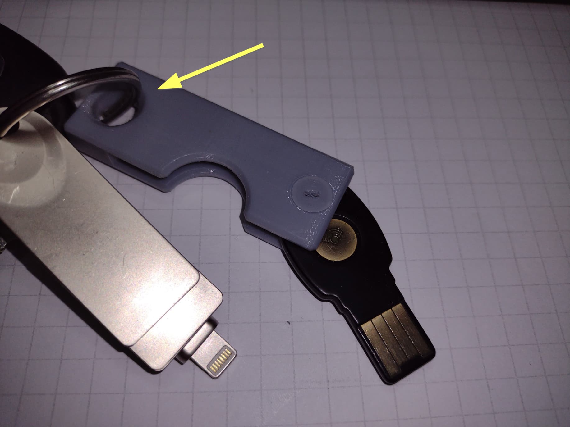

I had a similar application, but it was for a USB security key that was on my keychain. For the first naked USB key, the key ring eventually wore through the plastic of the USB key due to wear. So I printed a holder out of CF, which I thought would be ideal because of its strength. However, it was so abrasive that it ended up wearing a hole through my pants pocket. Additionally, the abrasiveness turned out to be its weakness because it was abrading on the metal key ring. The second holder I printed out of PLA, but it was so soft that it quickly broke, even though I had the wall thickness set at 100%. I finally tried out PETG, and that was the Goldilocks zone. It was durable, smooth, and non-abrasive. The only thing I would recommend is to set your infill to zero and your wall thickness to something like 500 to ensure 100% wall thickness and make your top and bottom layers 10. This will give you a near-injection-molded feel and strength. It will take longer to print, but the results speak for themselves.
