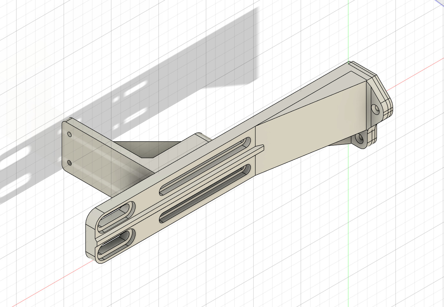

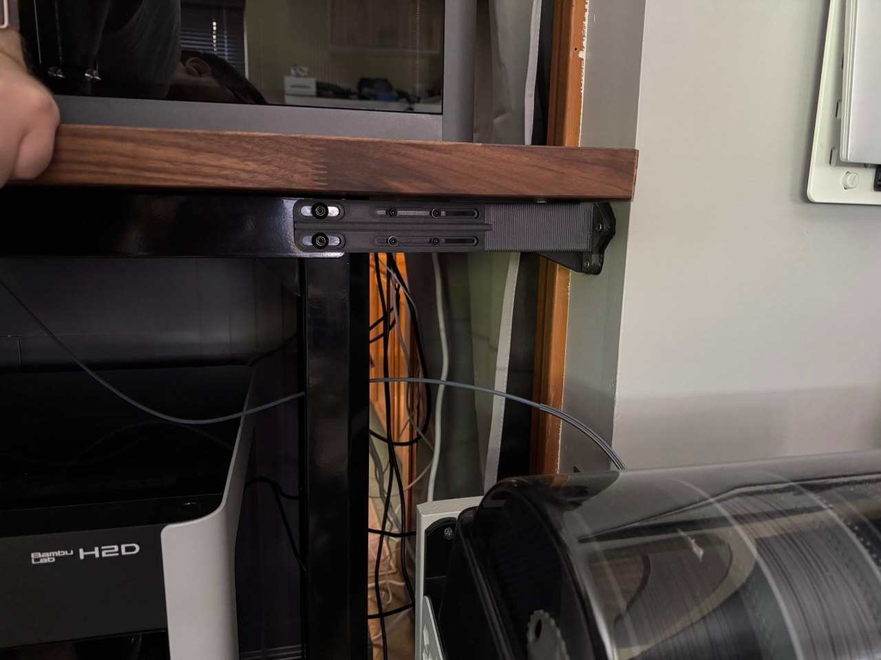

Metal frame + Ikea countertop + designed a reinforcing bracket that bolts to the stud. That thing ain’t going nowhere.

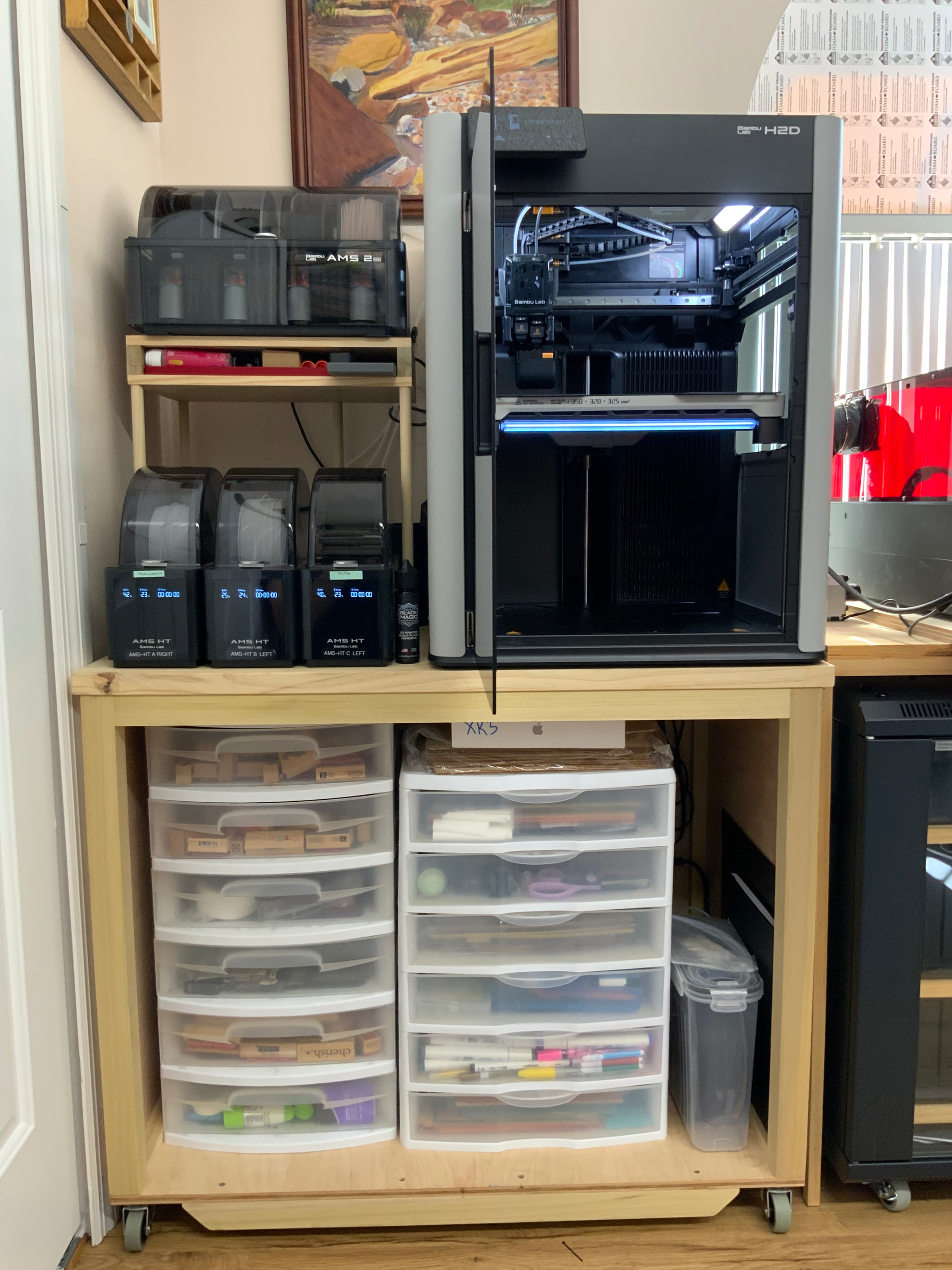

Here is my home made rollout cabinet. The top is 36” wide (91.5 cm) and 22” deep (56cm).

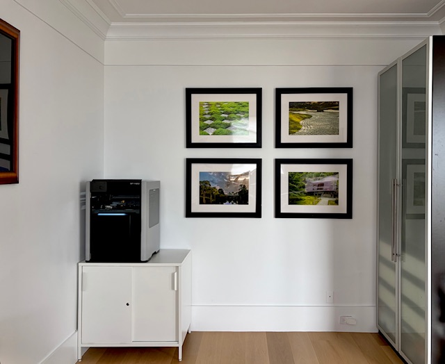

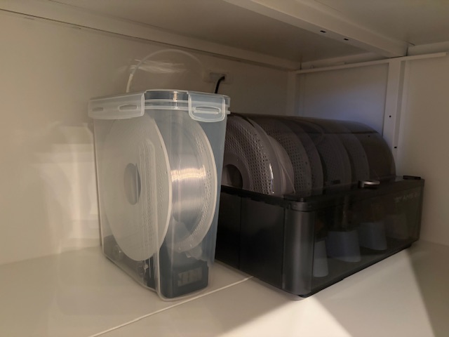

this definitely doesn’t qualify as “most sturdy” nor does it offer a lot of extra space for anything, but if you’re not frequently tinkering with your setup and are going for minimal, this ikea cabinet is working well for me.
it’s steel and weighs about 50lb. no wheels, fairly small leveling feet. I put my AMS and cereal box inside it, and had to make a hole in the (also steel) back, which of course I cleaned up with a 3d printed snap together grommet for smooth edges :slight_smile:

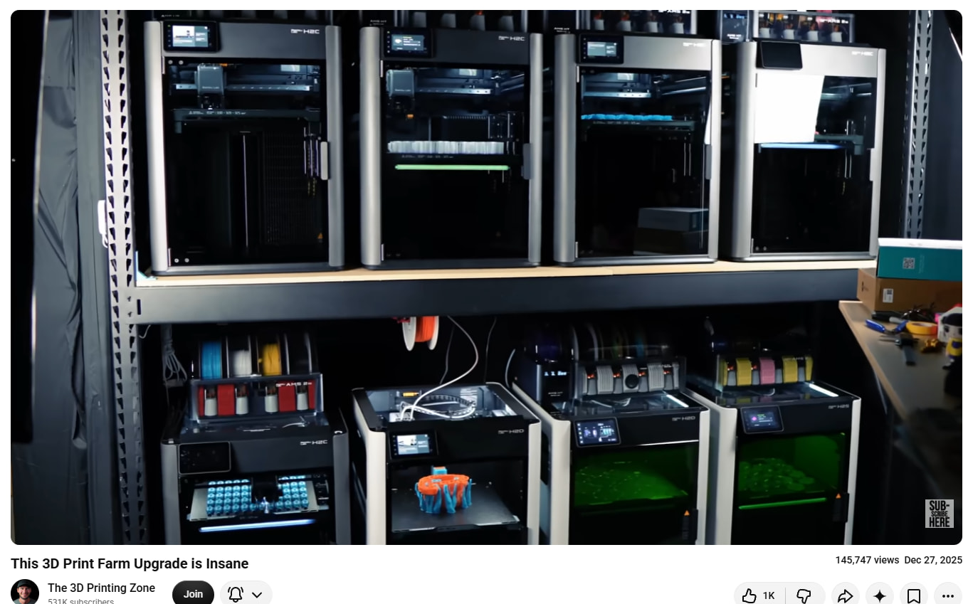

For those of us with more than just a single 3D printer, one of the early forks in the decision tree is whether to support each printer individually, independent of one another, or whether to leverage the same stand to support multiple 3D printers. When I formulated the OP title of this thread, I was biased toward separate standalone stands, on the theory that by physically isolating each 3D printer would prevent any chance fast herky-jerky printer motions causing interference among the printers.

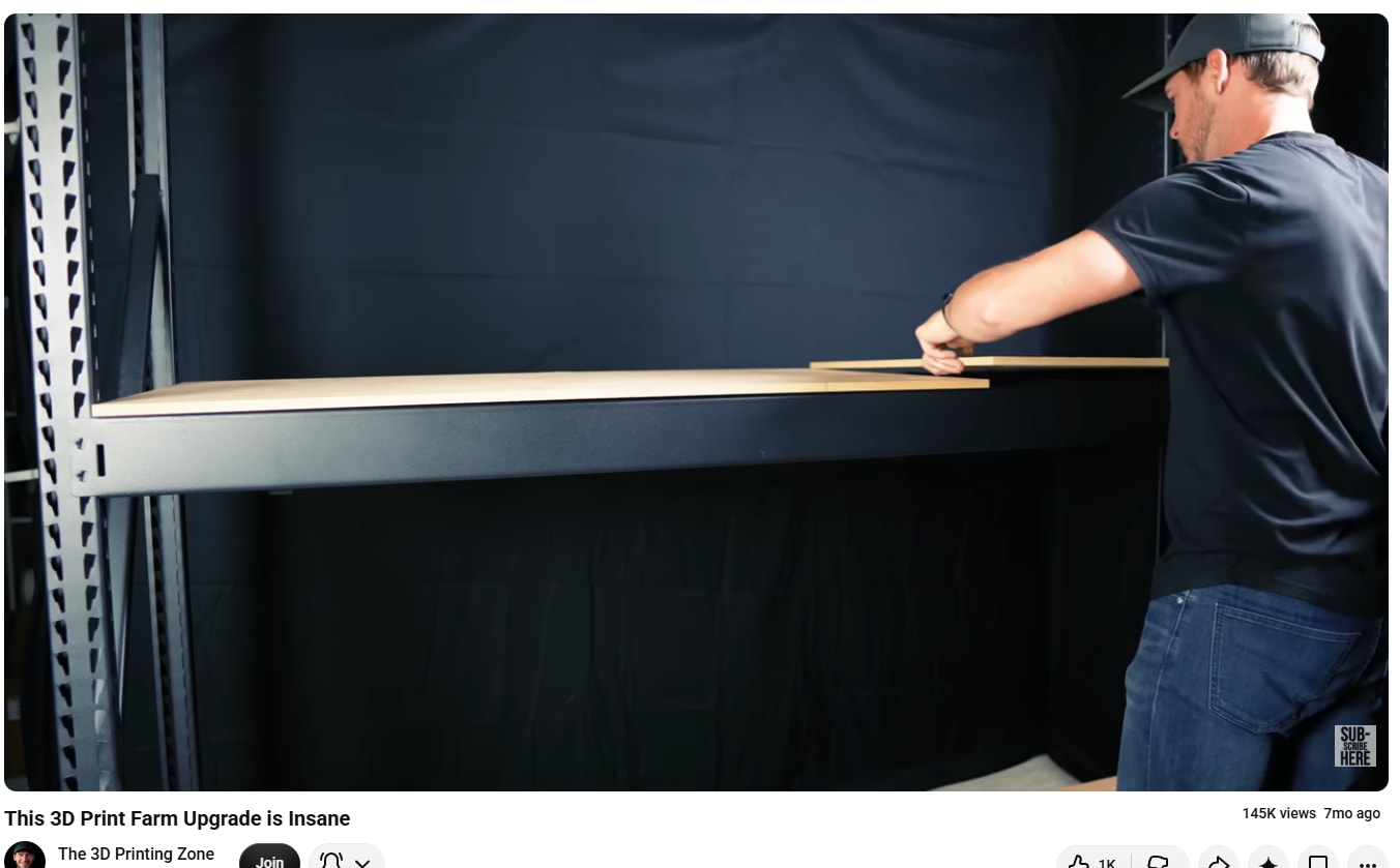

However, maybe that theory is a fear that never materializes. Why do I say that? I very often see print farm operators bunching up multiple printers on a COTS racks or shelving units. If it were causing problems, it stands to reason they wouldn’t be doing that. Examples:
where the print farm operator did little more than install MDF first:
Here’s another different farm operator who it looks like may have used plywood instead of MDF:

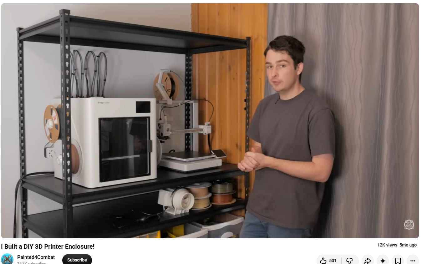

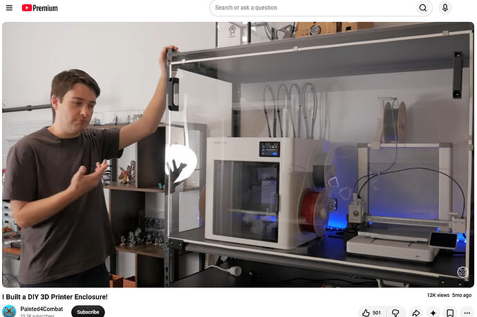

Moreover, it makes enclosing your 3D printer quite easy:
Easy because you already have a frame, so you only need to attach panels to it with screws or bolts or other methods
And the advantages of that are better control over the print environment (possibly avoiding huge temperature swings that you might encounter in, say, an uninsulated garage) and/or facilitating containment of VOCs and airborn microplastics that can arise during printing and so that you can collect the pollutants and vent them to daylight outdoors.
I share your skepticism about the motions of one machine impacting quality of its neighbor. I think the guys who use a single freestanding rack are asking for trouble, but the guys who have 100s of printers along long, connected in multiple segments and ground anchored pallet racking, makes a very good and solid structure and I wouldn’t worry.

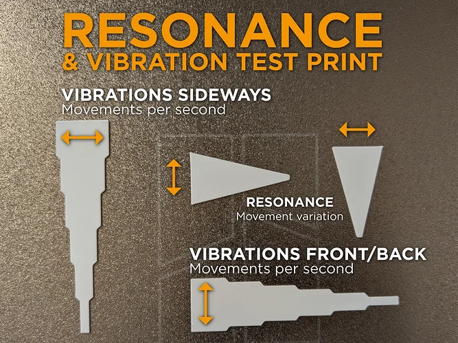

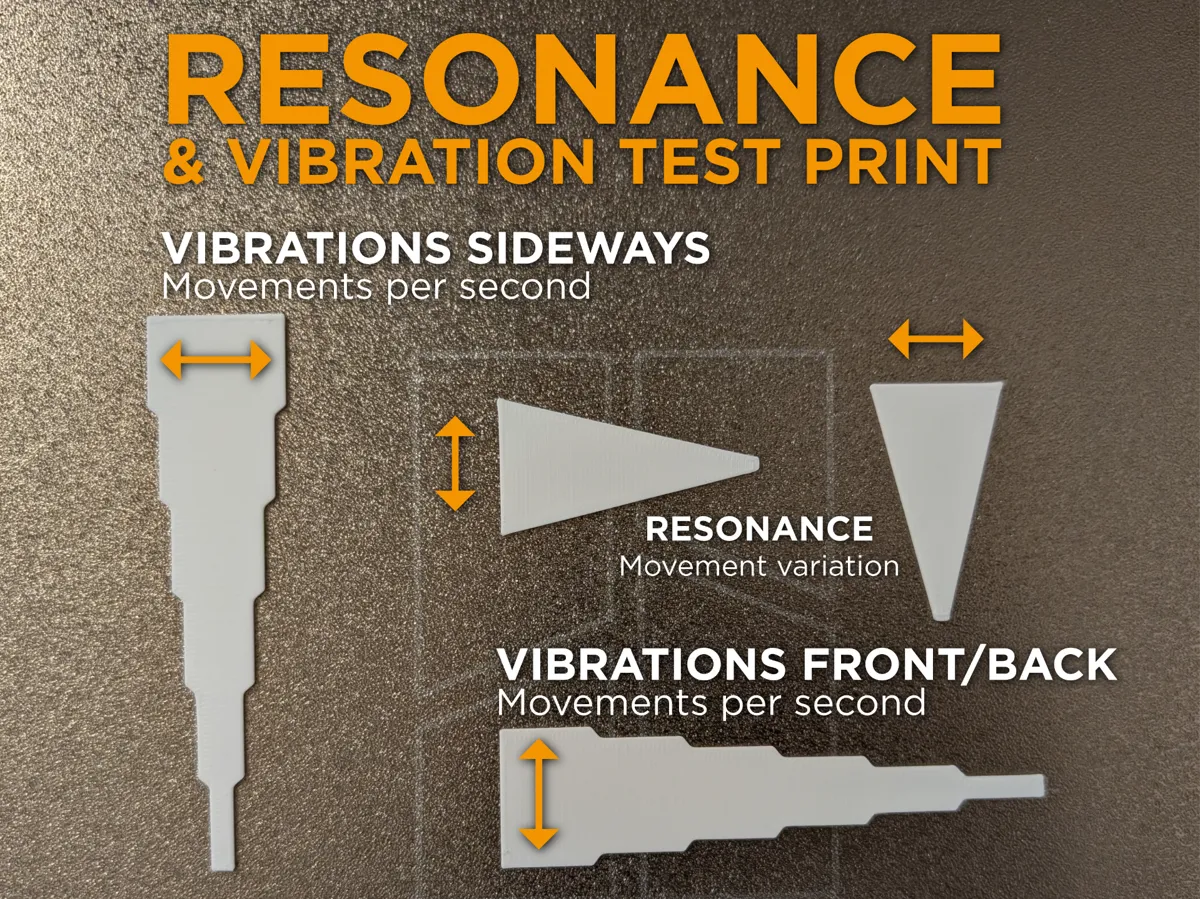

Here’s a diagnostic print to help you decide whether or not your support stand might be affecting the quality of your prints:
If anyone knows of a better test, please post. :innocent:
