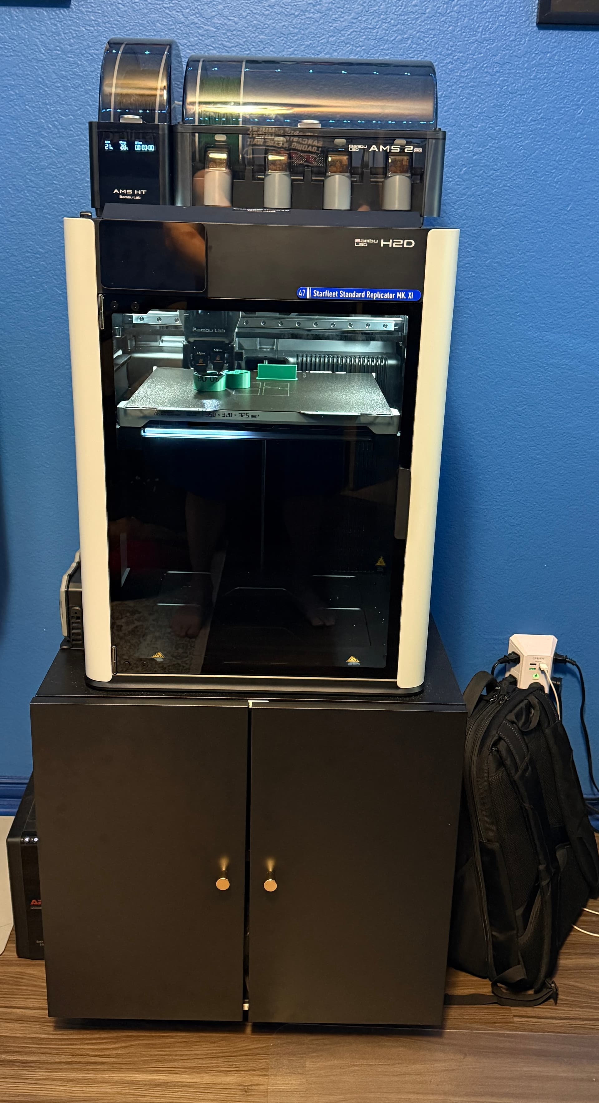

I purchased a stand from Wayfair for mine. It’s very sturdy, has a ton of storage underneath and is sitting on very strong wheels for easy movement if I need to get behind it, etc. (It’s also under $100 [as of this post] which is a great deal for the build quality in my opinion.)
https://www.wayfair.com/organization-storage/pdp/hossejoy-2362-w-printer-stand-with-wheels-iixr3901.html?piid=112215632%2C90571125
