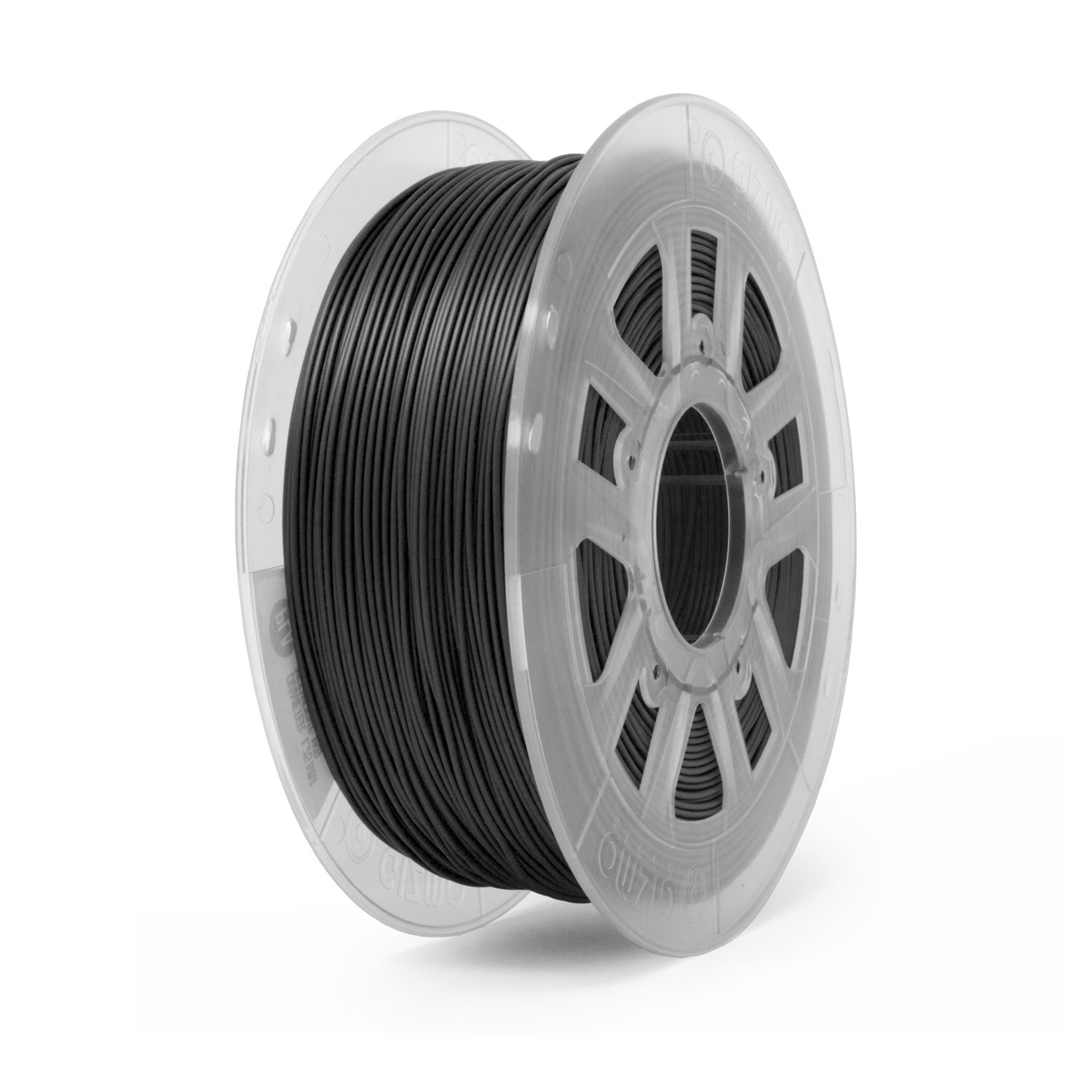

Hands down HIPS. The slicer will whine about printing medium temp filaments with high temp, but you can just ignore it.
Here is the exact stuff I’m using, and I just use BL studio default ‘generic HIPS’ profile.
https://a.co/d/7QPZhvE
