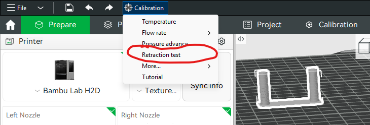

I hadn’t noticed until now that the Orca retraction test had been re-integrated back into the Bambulab slicer:
That happened in July 2025. I guess I never noticed because I wasn’t looking for it specifically. A textbook example of inattentional blindness. I point it out here for anyone else who may not have noticed for the same reason.

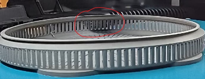

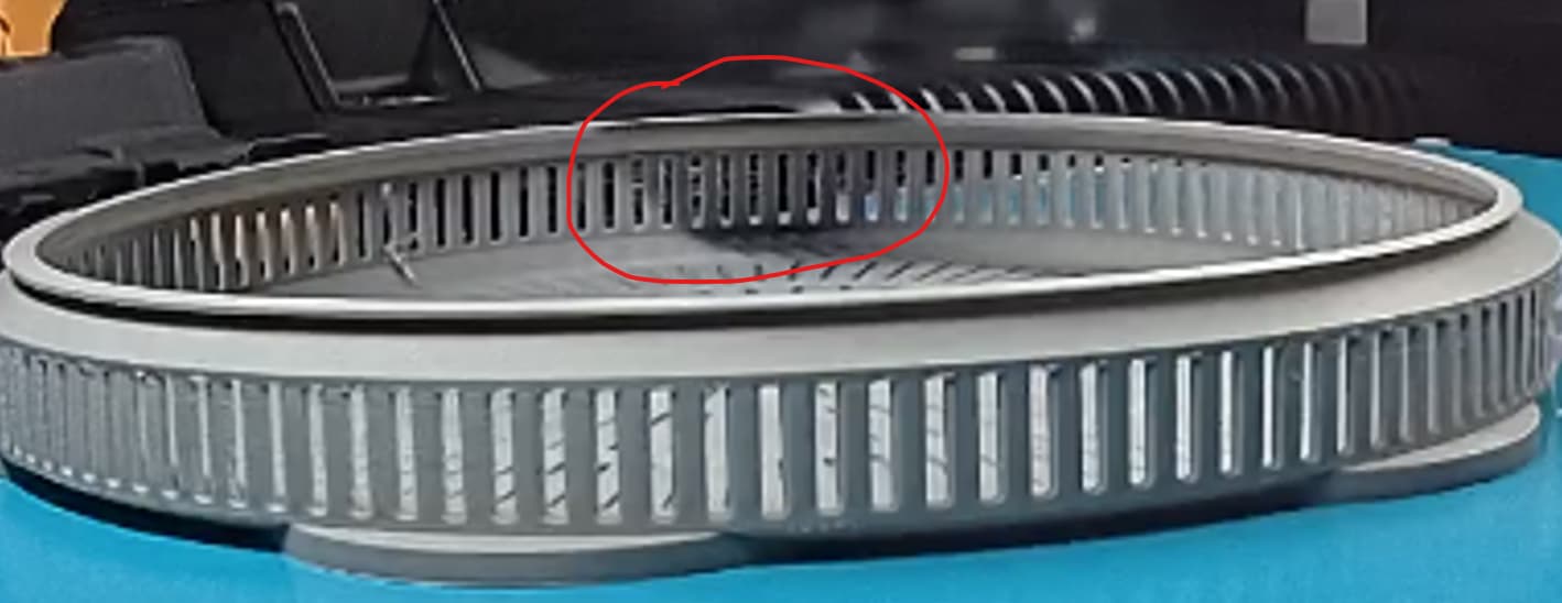

In my case, I notice it happens much worse on one side of the print as compared to the other:
This is not a one-off. I’ve noticed the same now over many prints. So, plainly unevenness in cooling (or something) is a factor. I’m guessing the auxillary part cooling fan just isn’t effective in this region, because the print itself is blocking/impairing the breeze from reaching that part of it. I’ve never understood why these machines have on auxillary part cooling fan on only just the one left side, as it would seem to invite this kind of problem. The usual super simple stock retraction test doesn’t measure for this effect, because it’s too small to create any meaningful self blocking.
Well, as part of the troubleshooting, I’ll re-orientate it to the center and see if that helps. I expect it will help at least some.

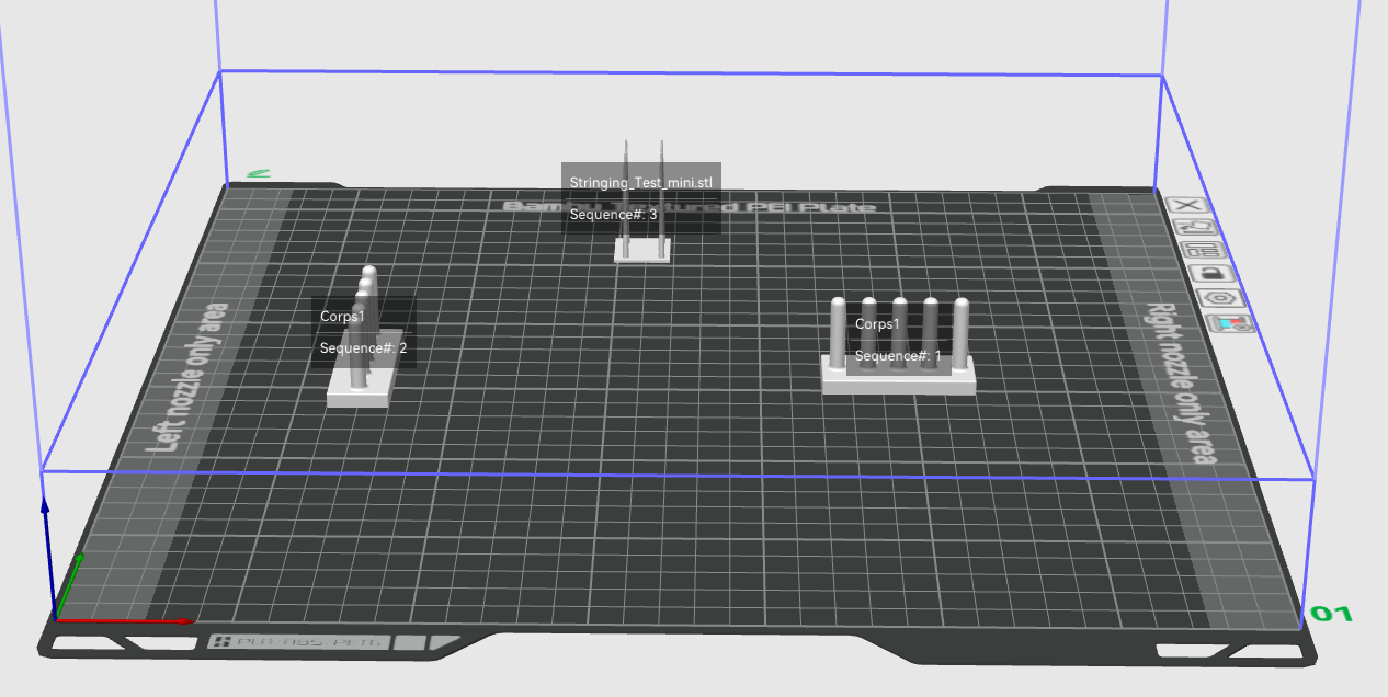

Strangely enough the retraction test for stringing that’s built into Bambulab Studio slicer barely produced any wisping, and then only at the very top and the very bottom. So, I just now downloaded a couple other stringing test models from makerworld and am printing them in serial sequence now to see if they’re more sensitive to stringing/wisping:
One of them I oriented a clone at 90 degrees to itself to see whether the auxiliary fan orientation might be affecting anything.
The unexpected success (non-wisping) of the Bambulab Studio retraction calibration model has given me a hunch now as to what the problem is, but I want a quick-to-print test model to iterate on. If it turns out these makerworld models also aren’t able to summon the stringing/wisping demon, I’ll chop off a chunk of the model I was printing above and use that as my test print to force the issue.

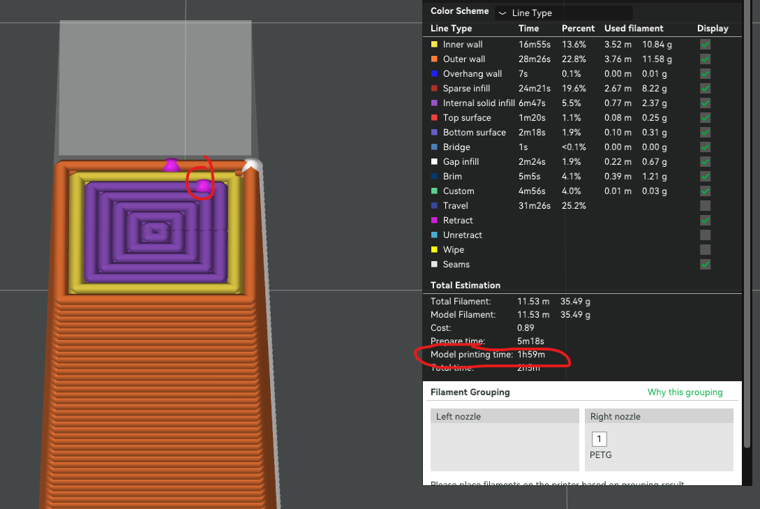

I found a bug in the Generic PETG and Generic HF-PETG definitions that might be contributing to the problem. The “Metal stickiness” parameter is set to “None” in both–an obvious error when you read the definition (see below)–whereas in the Bambulab HF-PETG, it shows the correct value which is “High”. The definition specifically refers to “oozing artifacts on outer walls” that may arise from an incorrect setting, and perhaps wisping is such an artifact.
Oh wow, Thanks, I just glossed past those new fields assuming they were informative
That stickiness tooltip is interesting. Sounds like it modifies “Something”© in the retraction decisionmaking. Something akin to the difference of monotonic and monotonic line.
@Bullocks
The slicer visualizer shows the same retraction point on the infill no matter what the “metal stickiness” parameter is set to, but on a print model I found that the total model print time is 1:59 when it is set to either “Medium” or “High”:

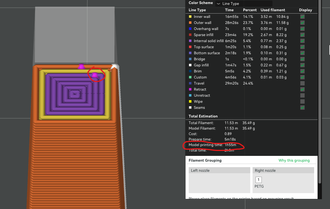

and 1:55 when set to either “None” or “Low”:
i.e. a difference of 4 minutes on a 2 hour print. If it were just retracting less depending on the stickiness, it’s puzzling that “Medium” time isn’t between those two numbers. So, maybe “Medium” and “High” are full retraction, and “None” and “Low” are no retraction. Who knows? We’d have to compare the g-code to see exactly what effect that setting is having.
