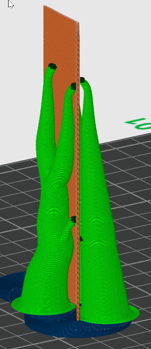

I’ve used painted-in supports and had good results. It just blows up print time if you add a lot of them. I was printing a similar kind of plate type print that needed to be printed on edge. Overall it worked pretty well.
Not telling you anything you don’t already know since you mention painting supports. Maybe a couple of tiers? Might add a brim on the side that touches the build plate?

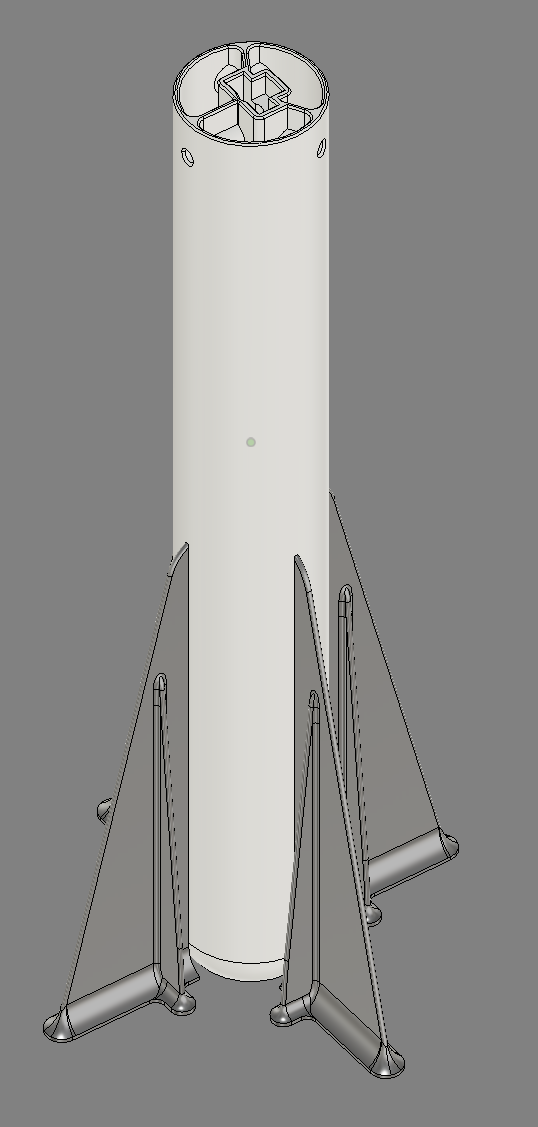

I’ve been exploring custom support meshes more for models like this.
In your 3d authoring program, you could use the part to cut/boolean the needed shape out of the support object, push that face in a little too, to create a slight gap.

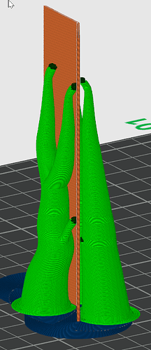

I think painting on supports is another good option because you can keep it small, just helping add some rigidity to some key areas.
I would paint small dots of support on opposite sides to stabilize the model. Tree Slim or Tree Hybrid usually works best. Set Support/object xy distance to a small value; 0.05 mm has worked for me, but you might be able to go lower without actually touching (and scarring) the object.

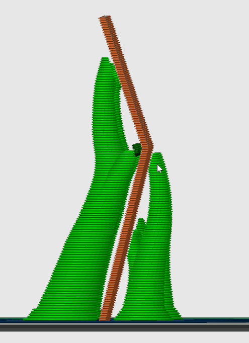

Supports cannot go past vertical. In that orientation, you can’t support both sides at the same height except near the angle.

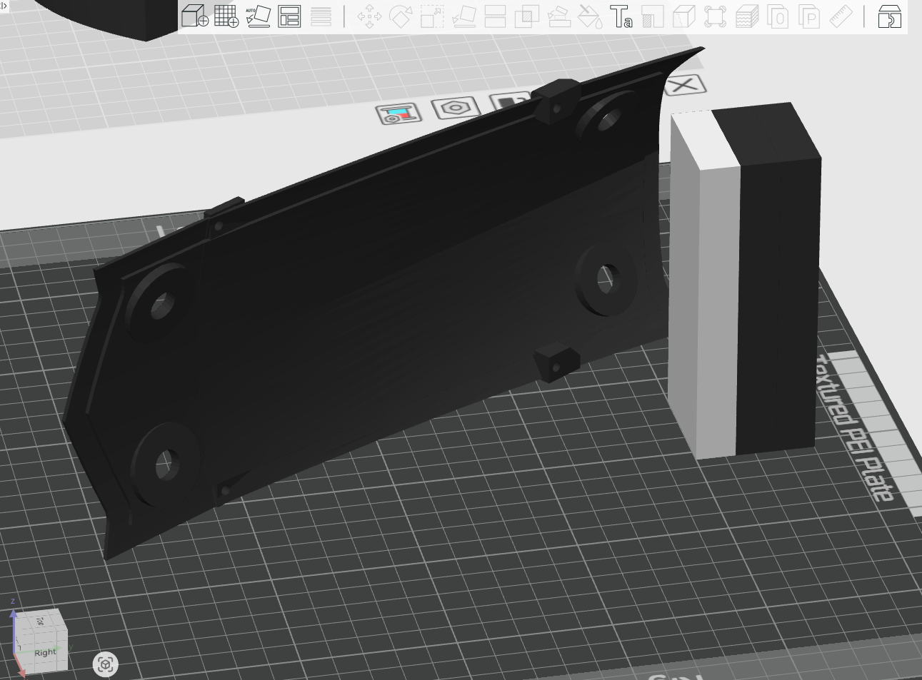

If the short end is straight, placing it on the plate might allow for better stabilization, at the cost of larger supports.
Thanks, Ill try this first. My support xy distance was probably too big. If that doesn’t work Ill give @Josh-3D ‘s example a go. Side wings sticking out of the main support triangles might also help. :folded_hands:
