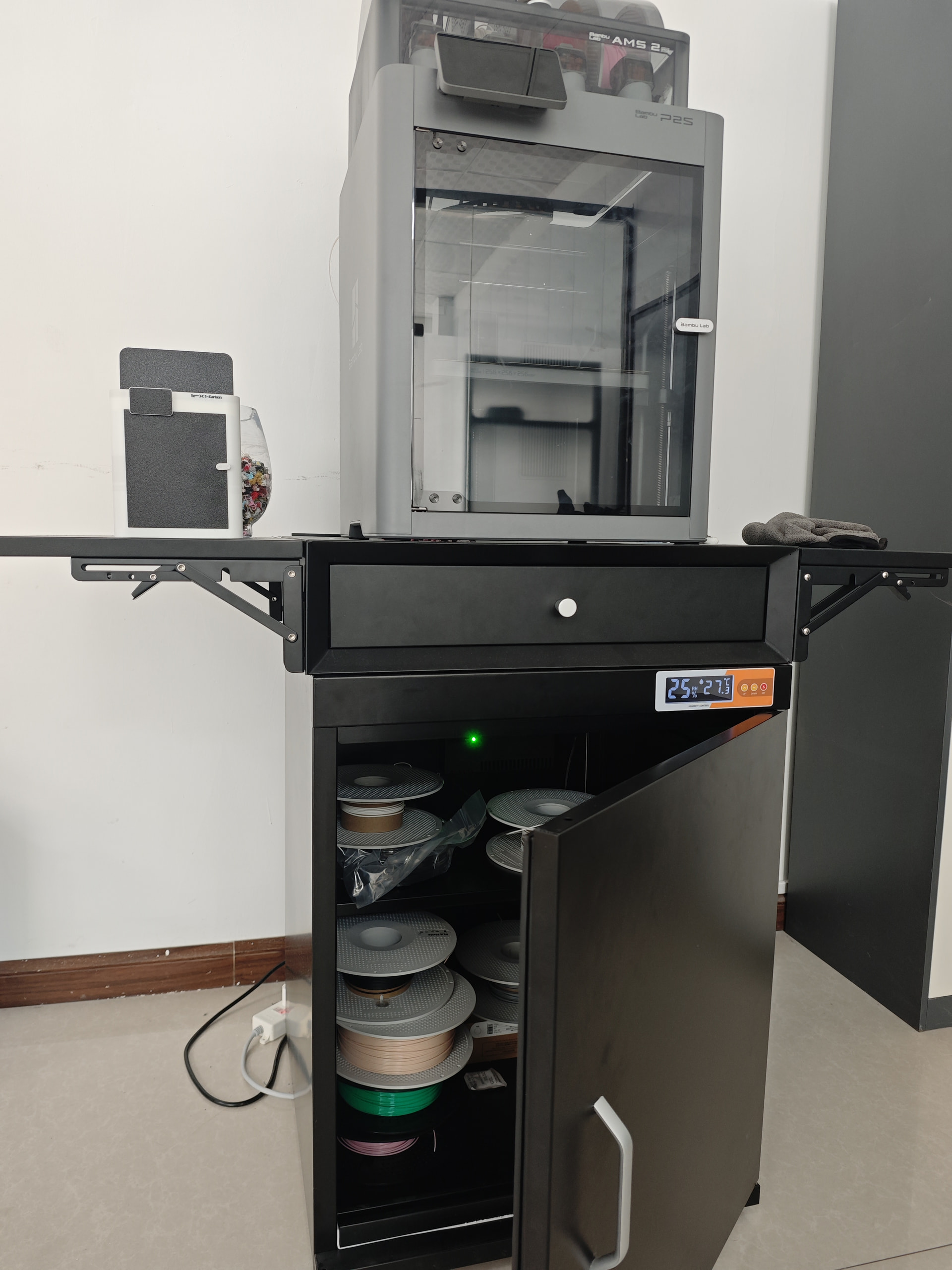

Since we’re sharing setups — here’s my current corner. Printer on top of the sealed cabinet (top’s solid, zero wobble while printing), 40 spools inside, and the display has been sitting at 25% RH / 27°C all week. Prints have been boring in the best way since I set this up. Anyone else running a cabinet + printer combo?

a setup you’ve had for a week, but posted about 3 hours ago.
I’m having trouble keeping up with exactly what your setup is.
Haha fair catch — the timeline reads worse than it is. I’ve genuinely been cycling through methods — small sealed boxes, bags, you name it — which is exactly why that comparison thread was all over the place. The big cabinet only just arrived a few days ago; when I consolidated everything I found way more than the ~15 in active rotation — unopened spools I’d forgotten about, a few stashed in drawers, and a buddy also sent a batch over around then. Once it all came out of the bags it was 40 total. The “all week” was loose wording — the display’s been steady at 25% since I sealed it up a couple days ago. Setup’s still evolving, so I get the confusion. Appreciate you keeping me honest!
