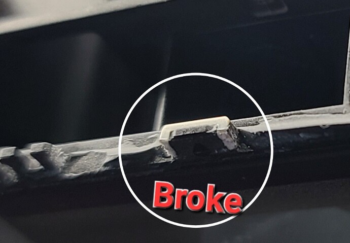

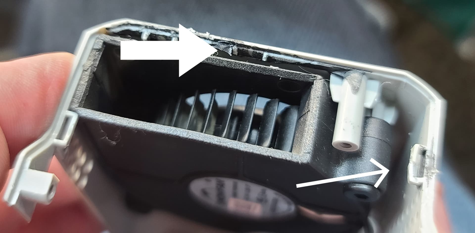

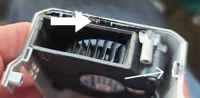

“Latest version of the fanduct on the P1/X1 series printer is glued onto the front cover. Use a flat cutter or X-Acto knife to carefully scrape off the glue to avoid damage.”
In reality, the “glue” is inside the mounting brackets, along inner and upper walls at a 90° angle to the gaps. It’s impossible to remove without breaking parts — I ended up breaking two mounting points following their instructions.
