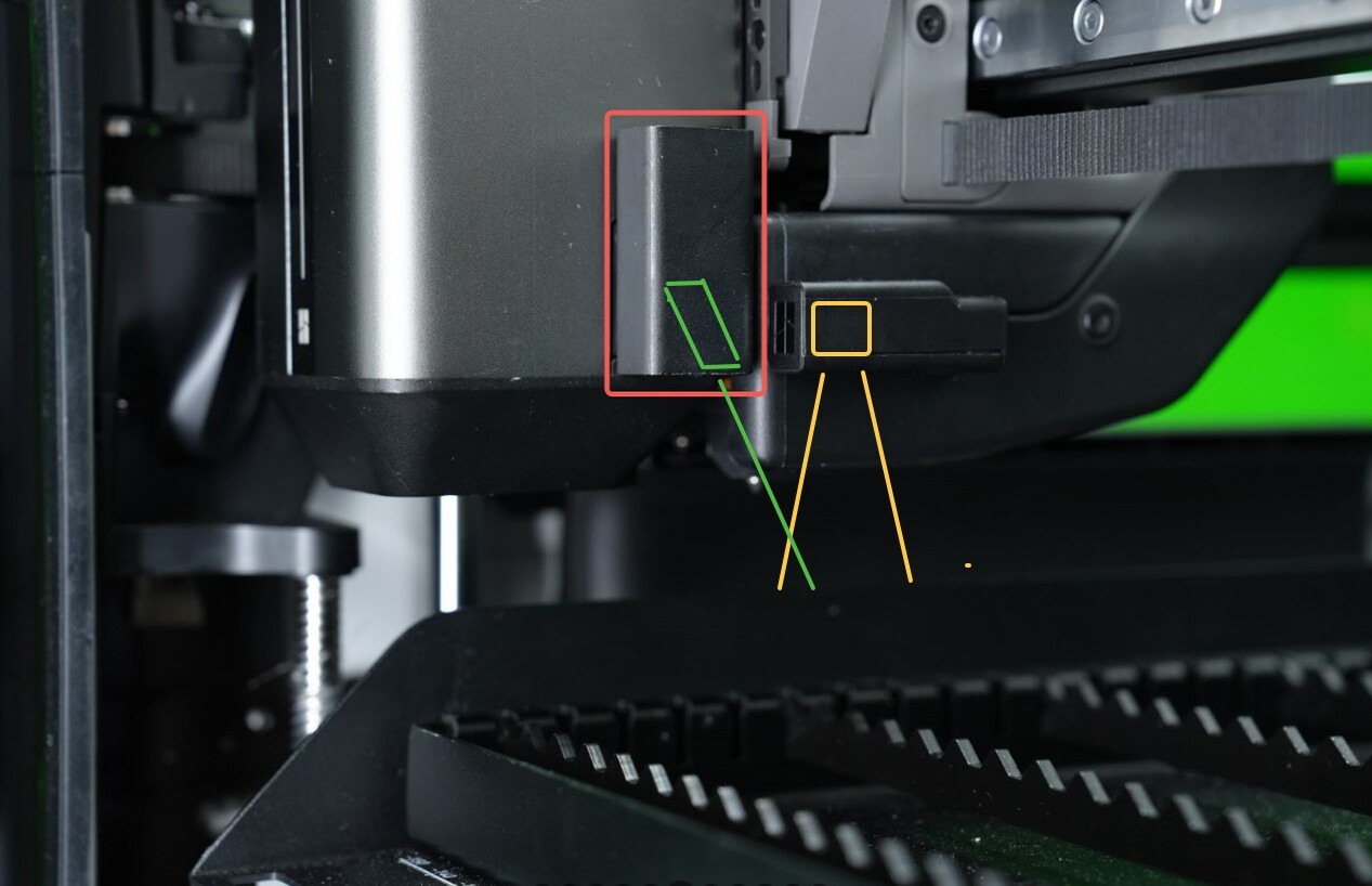

I just ran into this issue adding the laser upgrade to my H2C. i opened a support ticket and here is their reply -
Dear Customer,
Thank you for contacting us.
We would like to explain the issue as follows:
As shown in the image below, the green line represents the height measurement laser, and the yellow area represents the camera field of view.
The current issue is that the green laser line is close to the edge of the camera’s field of view. Either component needs adjustment so that the green laser is positioned more centrally within the yellow camera view.
Thank you for your cooperation and support."
There were no notes as to how i was supposed to adjust either component but by looking at the photo i realised if i raised the laser module this would move the yellow line further to the right. I went too high to start with and got an error saying it wasnt clamped. i kept dropping it until the error went away and then it calibrated ok.
Support say this is just to calibrate the birds eye camera and I can drop the laser down now and it won’t affect laser calibration.
I hope this helps someone
Thanks, I had the same issue and you’re solution worked for me too
