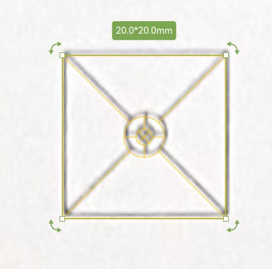

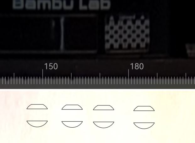

I have a drastic error of a few mm in the alignment of the laser with the Birds eye camera.In the pictures below you can see the positioning of my pattern and the result in the background.
The deviation is approx. 3-4mm
Unfortunately, the image is not sharper, so the lack of focus could also be the cause.
But I can’t find anything to adjust the focus.

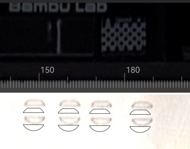

I have now recalibrated the camera according to the instructions.
The result has improved but the camera still shows very blurred images. Can you please describe in more detail what was wrong with your camera and how you fixed it
not much you can do, it’s the flaw of the lens, including focusing and to alignment from it to sensor.

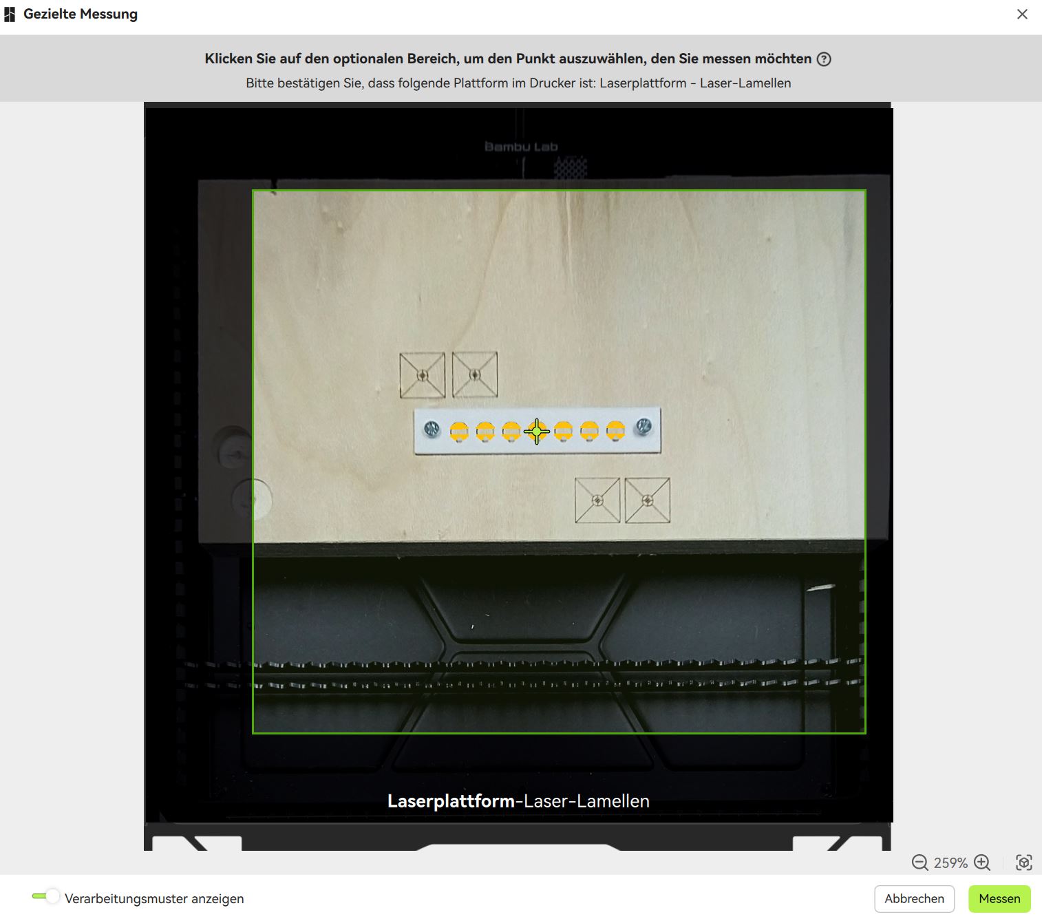

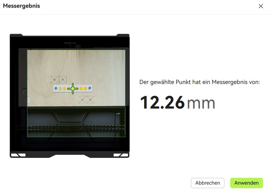

I was able to solve part of the problem by carrying out the manual height measurement.
This significantly improved the positioning of the camera.
BUT
with 5 repetitions I have 5 different results with a tolerance > 0.6mm. Unfortunately, this has a considerable effect on the result.
Unlike 3D printing, the print bed is NOT measured automatically but only manually at a single point.
So it is hardly possible to process uneven surfaces exactly
