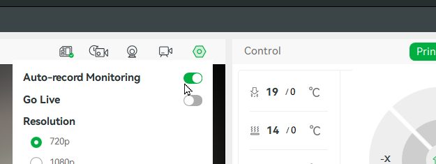

I won’t attempt to disassemble or replace the camera myself. I want to record a timelapse as they requested since they said the warranty will cover this. So I enabled timelapse and recorded a 16 minute print and the timelapse video came out 3 seconds long only. I’ve never used timelapse before. Does it only work well on long prints? Is there a way to record a normal video? I bought a 64 GB SanDisk USB flash drive just for this so hopefully someone can help.

A timelapse is just a series of snapshots taken at widely spaced intervals, so being much shorter than the print time is to be expected.
You can record continuous videos from the Studio Device tab by activating Auto-record Monitoring.
