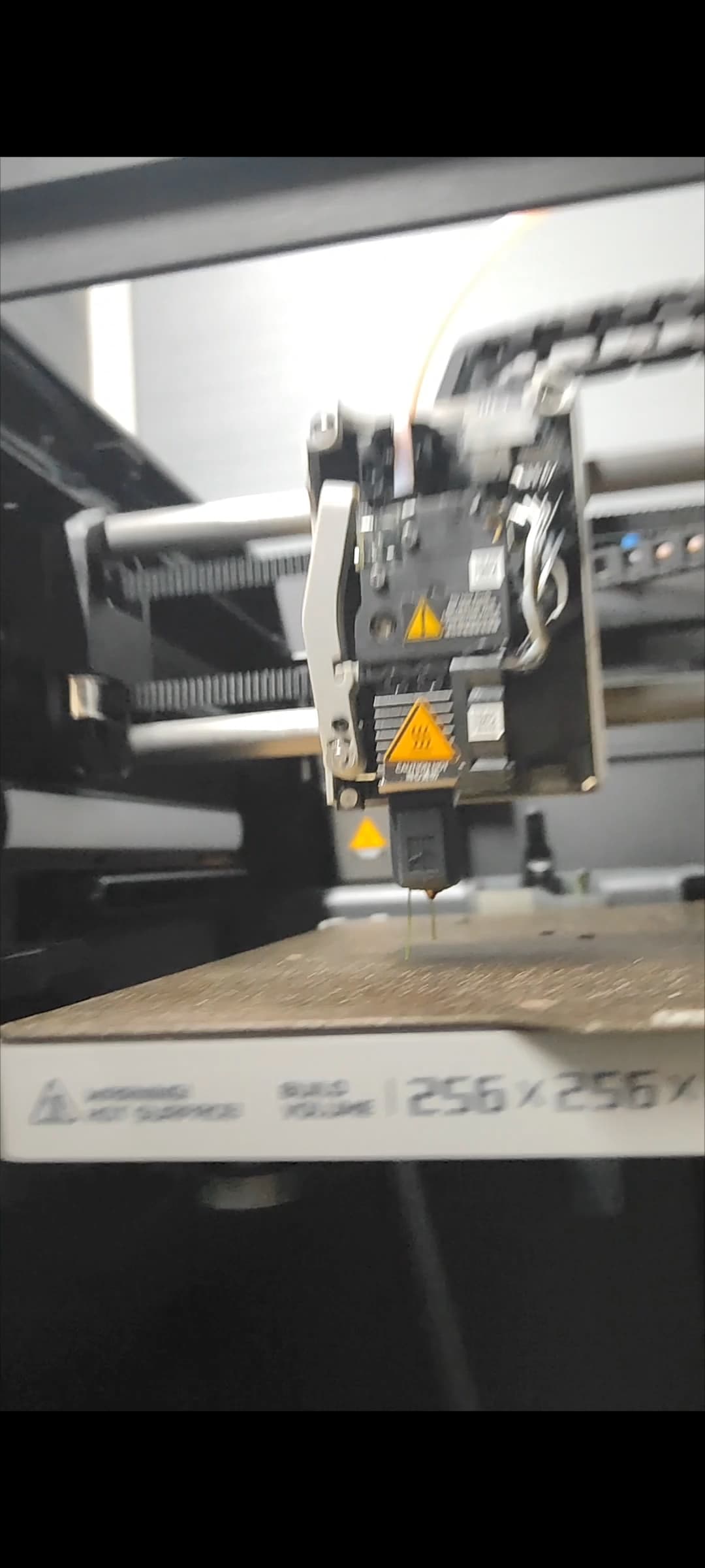

Good morning, I suffered a material jam in the extruder due to a temperature error, but now the blade is stuck when changing the filament. I attach a photo so you can see what happens.

I have done a thorough cleaning of the extruder right now, brushing all the gears with a toothbrush and cleaning all the gaps well, unfortunately the same thing continues to happen, I even tried with a new blade, I have tried the lever without the blade and it doesn’t work. I know it gets trapped, so it must be something from the blade hole, I will continue testing and if I can solve it I will post it here.

Are you sure the cutter lever was correctly installed after reassembling the print head? From my perspective, that part seems flawed because it’s possible to damage the plastic if it’s installed incorrectly. Additionally, improper assembly could result in losing the cutting function or other issues. It’s also quite easy for the blade to come loose from its mount during reassembly, which could cause further problems.
If the cutting arm is getting stuck, try loosening the screw that keeps it from popping out completely. If that screw is too tight the arm will jam.

He conseguido solucionarlo aflojando varios tornillos, no solo el de la palanca de corte, si no también el del muelle del extrusor, así he conseguido que la cuchilla deje de atraparse en el interior. Estoy muy agradecido por vuestras respuestas y haberlo solucionado.
