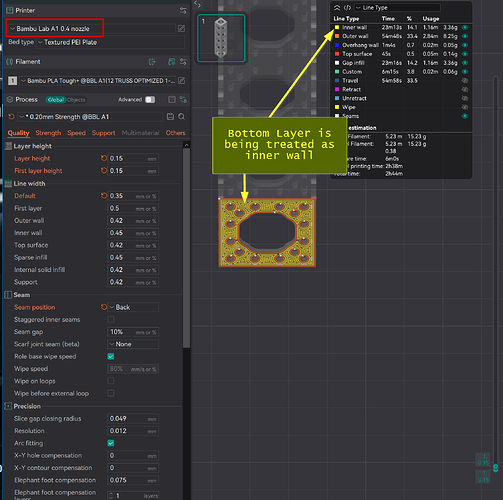

Hello!
Having this slight issue on this print where it’s not recognizing the bottom layer as the bottom surface but instead as inside wall. I’ve tried changing bottom surface thickness and wall counts and other bottom surface settings but nothing is changing. Even if I cant make it be a bottom surface, how can i change the pattern to rectilinear rather than the spaghetti pattern it is?
Trying to print it with the raft, just showing without the raft it still prints as inside wall.

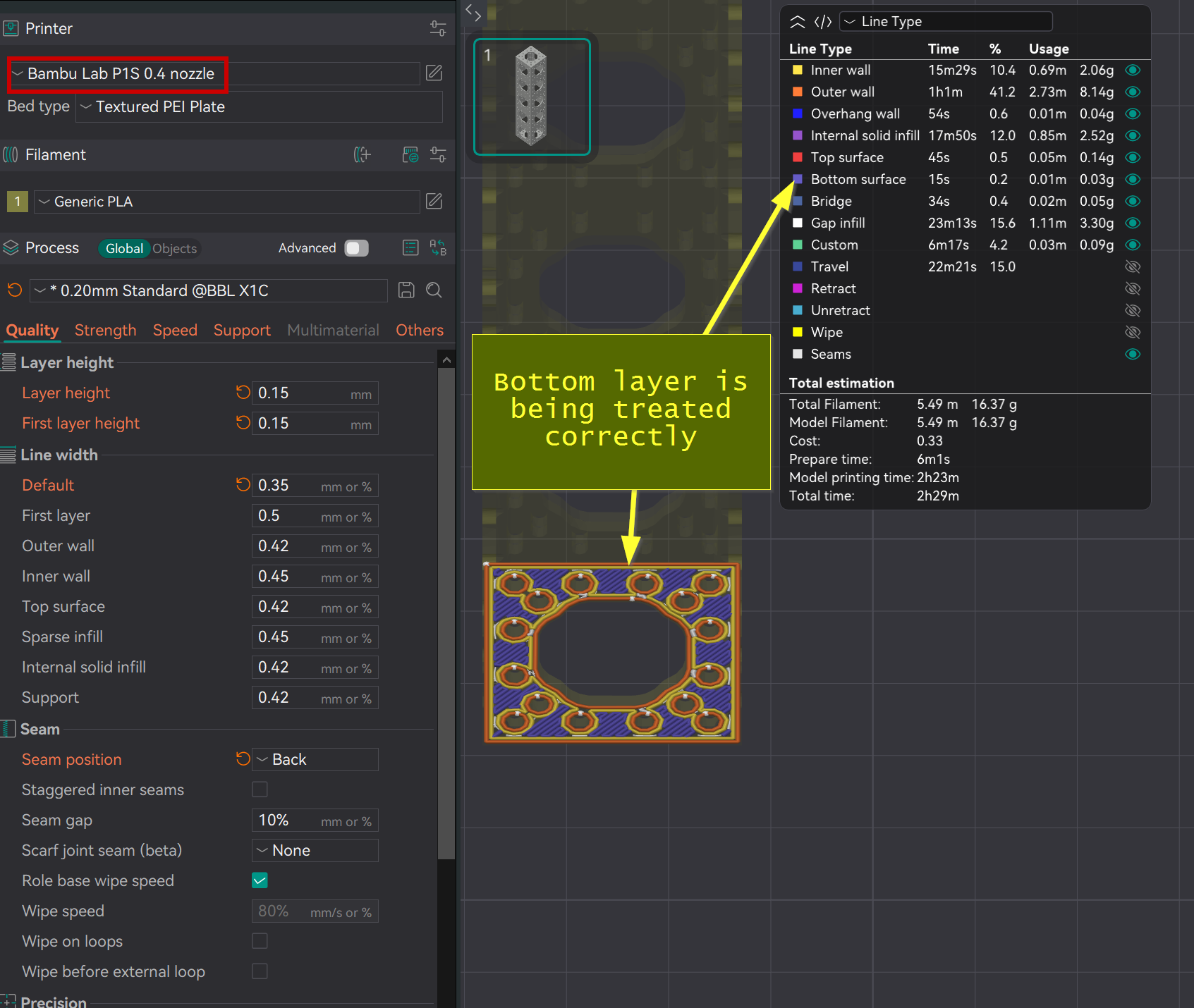

My friend, I think you have uncovered a legitimate bug in the slicer software or A1 firmware. I tried this with Orca 2.3.1 and I was able to reproduced the exact same issue and I could not find a workaround. However, when I took the same file and this time changed the printer preset from your A1 to the stock P1S preset with the same nozzle, low and behold, the bottom layer is treated correctly.
Here’s the evidence.

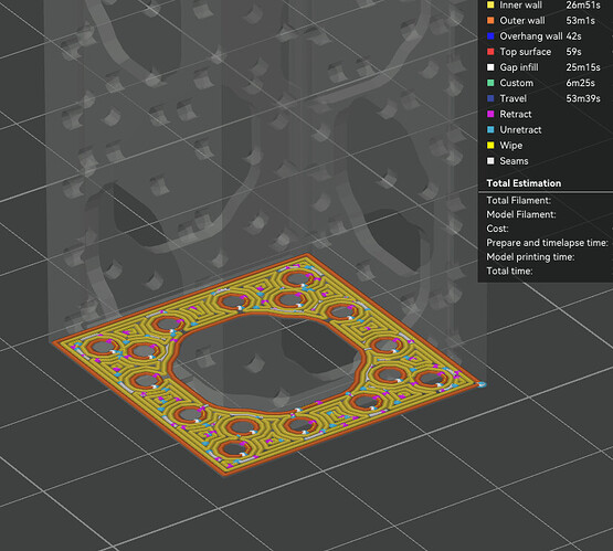

My perspective from Orcaslicer nightly
Open 3mf
Change exactly one thing - one wall on first layer
Slice

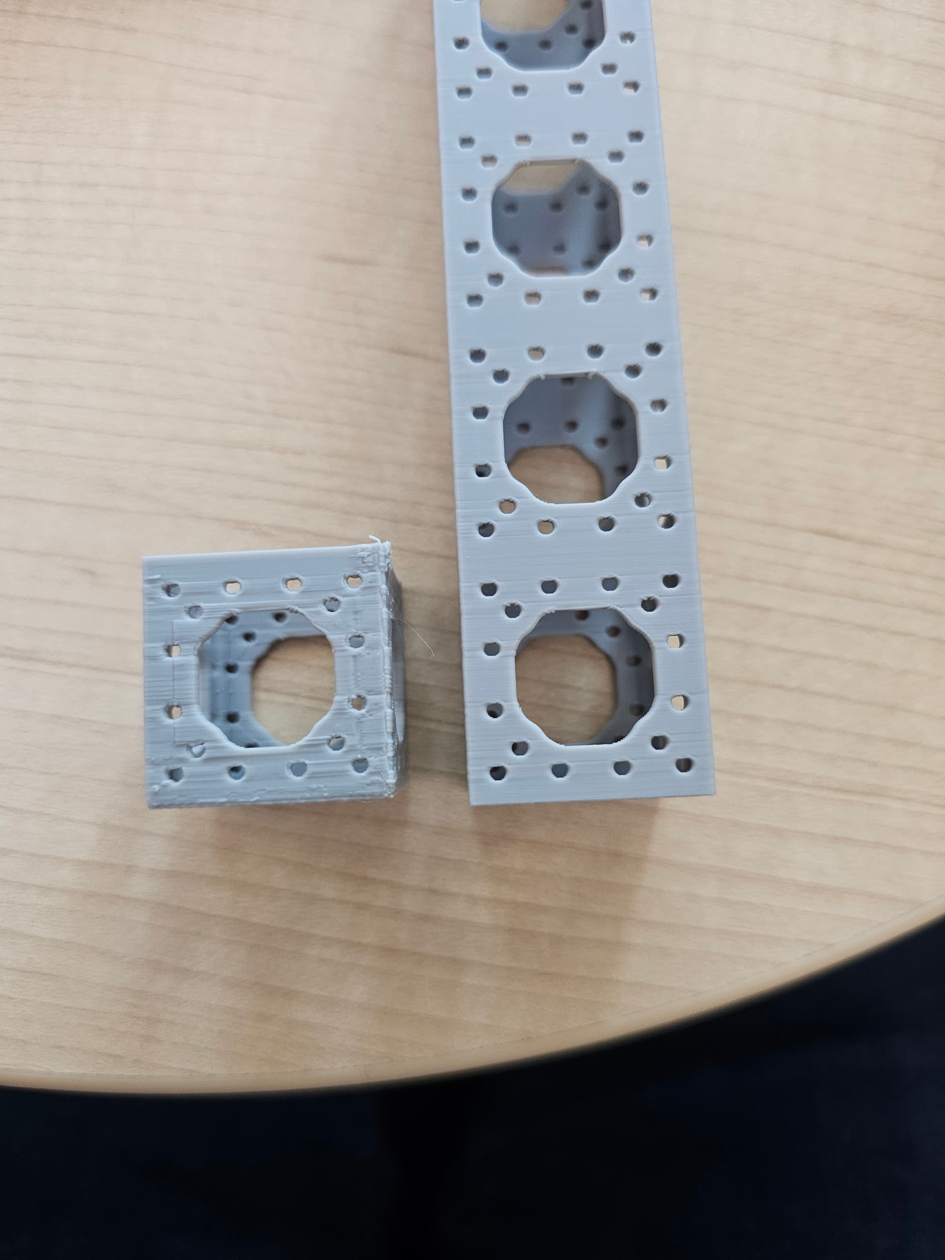

Reducing wall did fix the bottom layer, but now quality is greatly decreased. the cube on the left is with just 1 wall, taller one on the right is with 6 wall. Any thoughts on how to clean it up?
I would agree, dont modify the wall count from what you want, thats for the whole model. There’s plenty of levers to pull for first-layer-only.

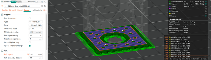

If i load that 3mf, add one wall on first layer, then add 4 layers of raft:
hmmm. I did same exact thing, I re-opened the one i sent, did the one wall on first layer, and added 4 layers of raft, but am getting different results.

I was able to get my hands on Orca and it was able to do it just like you said - import, first layer 1 wall and add the raft. Which would give more reason to believe that could be a bug in Bambu Studio.

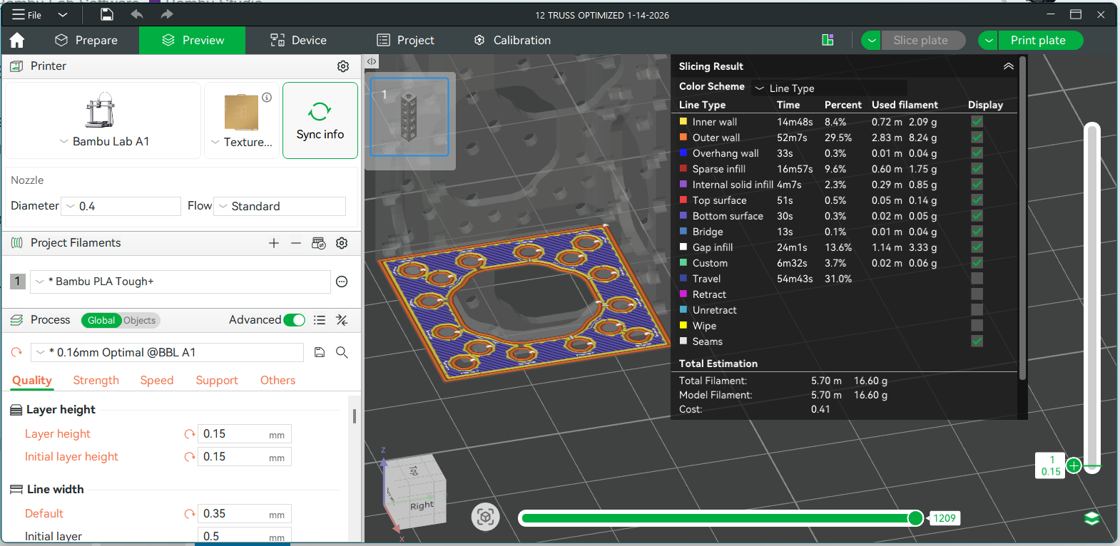

Studio and Orca are both choking on the combo of a 0.20 process and the 0.15 mm layer height.
Change to a 0.16mm process and 0.15 layers work. (What’s wrong with 0.16mm layers?)
No rafts, modifiers, etc.
