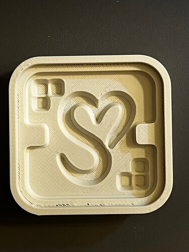

I’ve noticed that I don’t get very consistent bottom or top shell layers, and that often they are quite bad. Way out of the realm of normal (my A1 Mini did not have this problem).
Have gone back and forth with Bambu support. They are helping, but the 3-day cadence is just awful. If I had just gone back to Microcenter within the first month of ownership, I could have swapped out the printer and called it a day. But now the return window has closed.
I’ve attached a photo of a recent print. This was printed at .12 Fine layer height with a .04 Hardened Steel nozzle. Printing official Bambu Matte PLA filament using Bambu’s settings. Usually via an AMS Lite sitting on the left side of the printer.

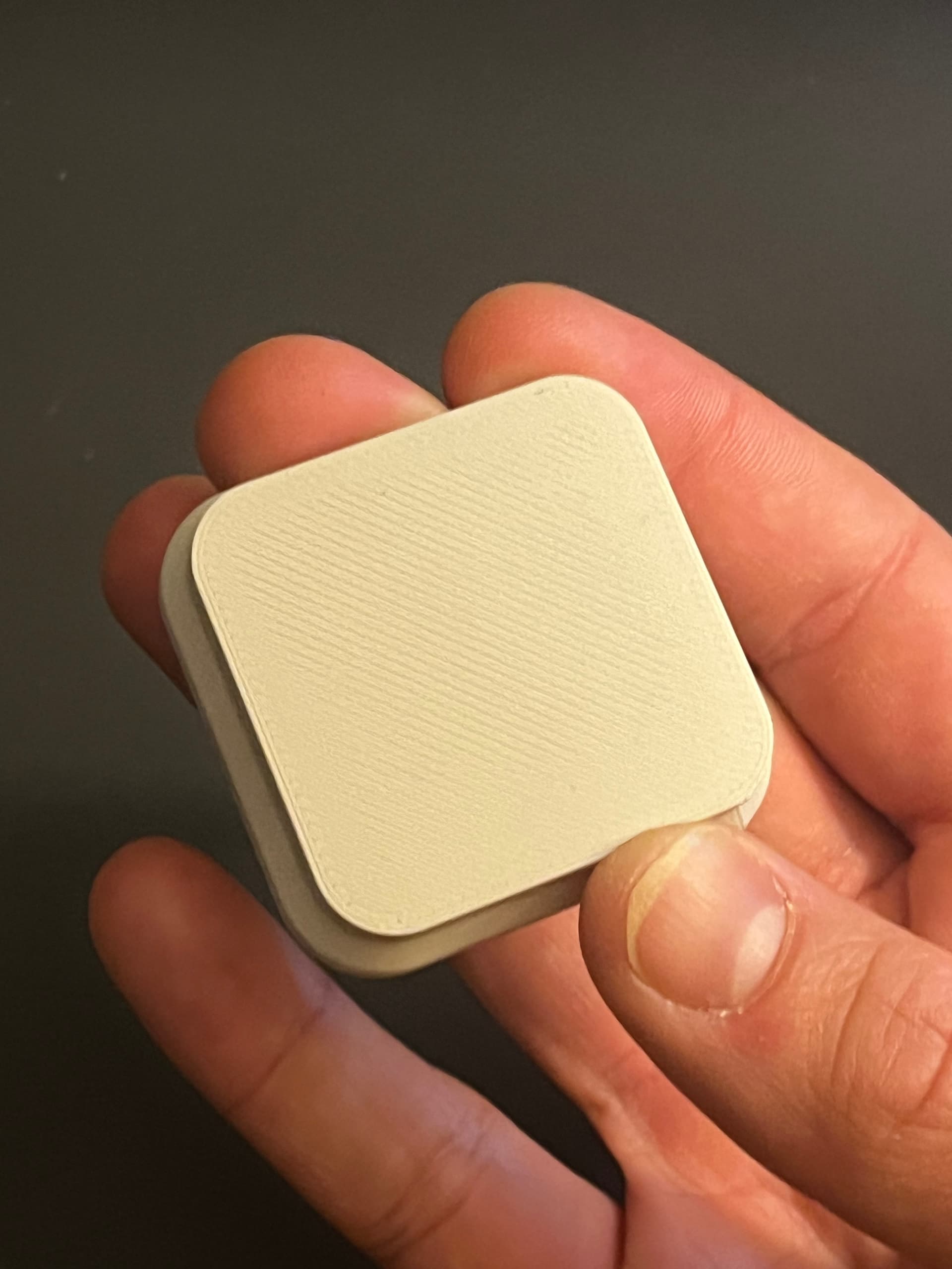

Top surface:
Bottom surface:
Here are some things that have already been tried:
-Ensured nozzle was properly seated and clasped.
-Ran machine calibration (several times).
-Manual flow rate calibration. Improved gaps but causes raised surfaces where extrusions meet. Also, this should not be necessary when using Bambu-brand filament (this is clearly stated in the Bambu Wiki).
-Tightening screws in and around the hotend.
(Added since posting:)
-Bypassing AMS Lite, using external spool instead
-Tramming build plate
Does anyone have some ideas?
Note: I am operating under the assumption that this is not expected behavior from the printer. As such, suggestions to change settings such as temperature, flow rate, etc.—while helpful for getting a decent-looking print—aren’t what I am seeking. I am instead looking for some help troubleshooting, because I suspect something is wrong.
Thanks so much and happy printing!

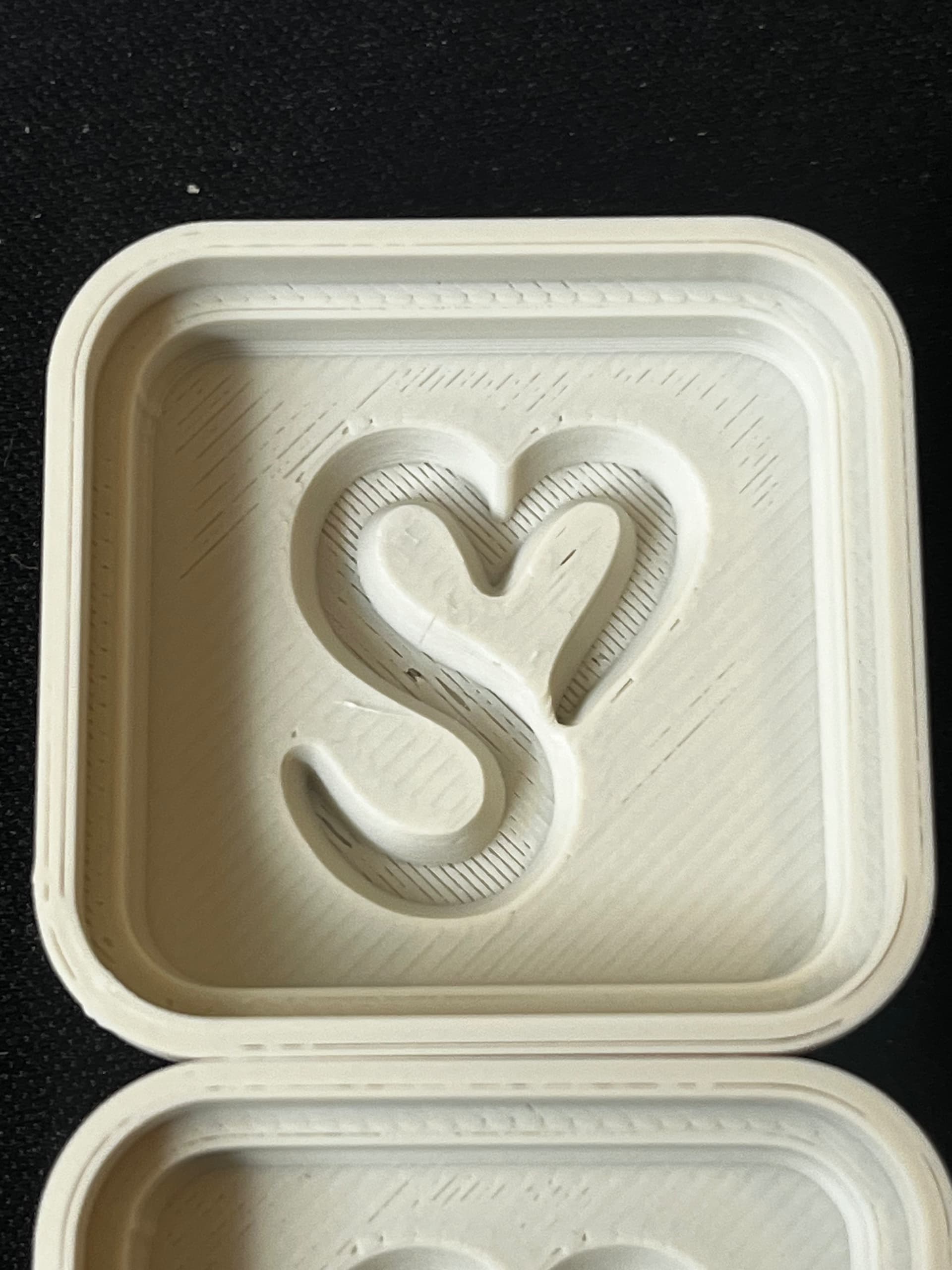

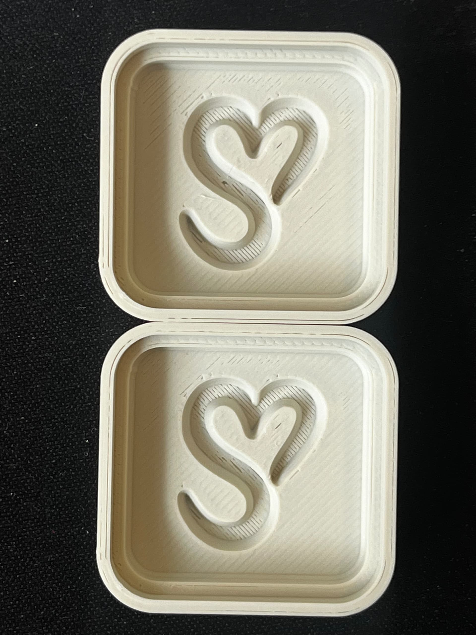

Update: I manually trammed the bed according to the Bambu Wiki. Here are the resultant prints:
Still looks quite bad.

Hi I sometimes have this issue too but it usually happens on prints that are really thin that doesn’t have infills. Which side is facing the print bed?
Thanks for your input, @Glooploop
These prints are on the small side, but have infill and I’d not call them thin.
The second photo I included is the side that contacts the build plate—everything else (with the heart insignia) is facing up during printing.
After checking again it could be due to under extrusion, could you check if you’ve calibrated manually
That’s what this post is about. If you have something specific in mind, I’m all ears. Do please check what I’ve done above in case I’ve already covered it.
Did you read Flow Rate Calibration | Bambu Lab Wiki ?
Yes, and I adjusted flow rate as mentioned above. But manual flow rate calibration should not be necessary while using Bambu brand filament. Bambu is clear about that in their wiki.
The point of this post is to figure out if something is wrong with my machine.

Marketing says one thing and reality on the spool sitting next to you says another, imo you need to adjust your flow rate or some other combination of settings that hasn’t been discussed. Sometimes filament can get ragged like that at max extrusion rate right before it fails, so it could be speed/temp too. My guess is flow rate. In the range of 2-6%
Make sure you aren’t conflating words with flow dynamics. Rate and dynamics, two diff things.
Thanks, Bullocks. Future readers will appreciate the flow rate / dynamics clarification, but I am already aware of it.
On your point about filament at its maximum extrusion rate: I get a similar result even if I set printer speed to 50%, so it does not appear to be an issue of teetering on a max extrusion rate. Unless I am misunderstanding your point?
Bumping up the flow rate 2-6% as you suggest reduces the gaps but causes over-extrusion in other places.
My suspicion remains the printer itself. I previously owned an A1 Mini and never had it this bad. And I did all sorts of wild stuff on that old machine, including a lot of custom g-code.
