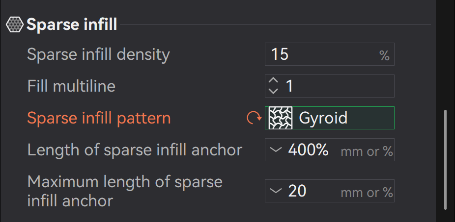

Just to ask in advance: Which infill do you use?
I have tried a few infills now, the one i have been using for these prints in support cubic and as i said, its always printed perfectly. I have now tried gyroid, rectilinear and also cubic.
I will try google drive but im honeslty brutal with computers lol
Read this: There are some infills that intersect, causing them to repeatedly collide with the 3D object and resulting in it being knocked over. That might be the case for you.
For example, Gyroid does not cross itself and is therefore ideal for preventing knockovers.

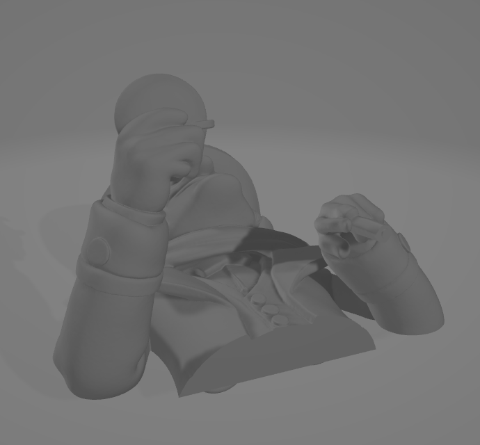

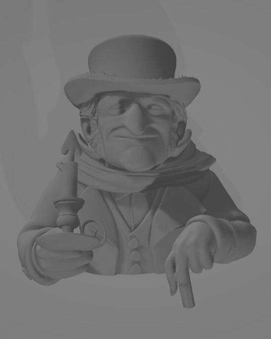

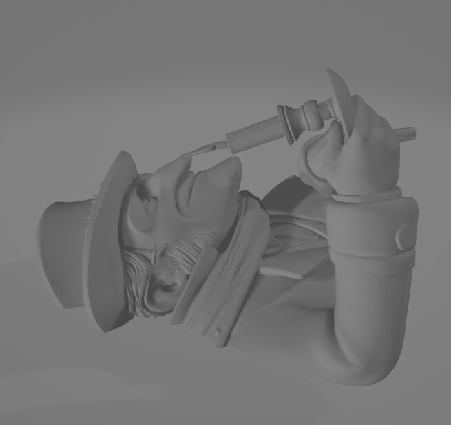

The 3D model is attachment i make for my sister, they fir in the centre of a wreath, the one in qestion is a model of scrooge. Settings, excuse the noob response but which settings are you referring too? build plate has been cleaned as i do with the other printers. When i remove the failed print its pretty well on there and i heard the crack from the support being broken.
I did read about infill choice having an effect on support stability but again i have used the same infill on this model at least a dozen times over the P1S, X2D, U1 and my old creality (which its printing in just now actually) so im thinking its not an infill issue. I bought the A2L as i wanted to make the prints a bit larger.
This is the print

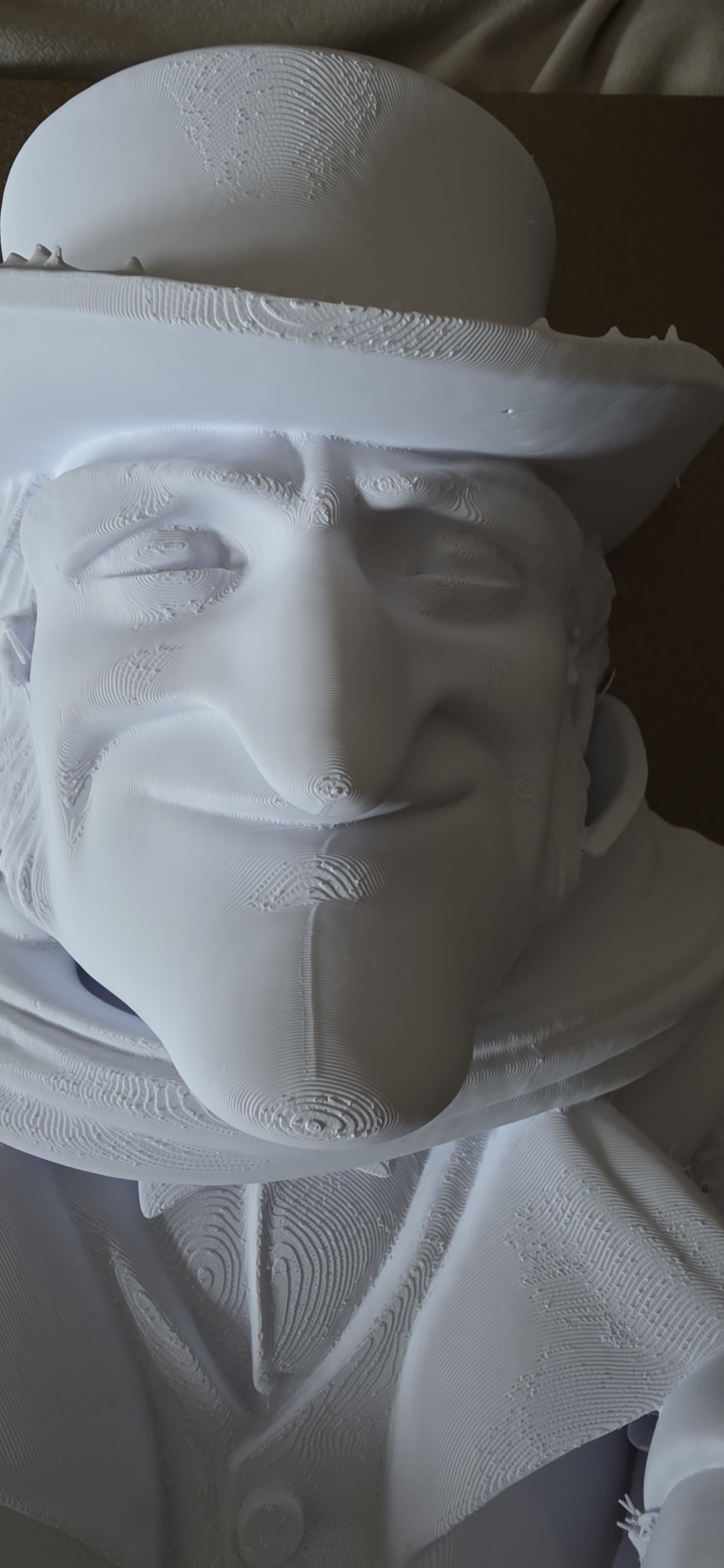

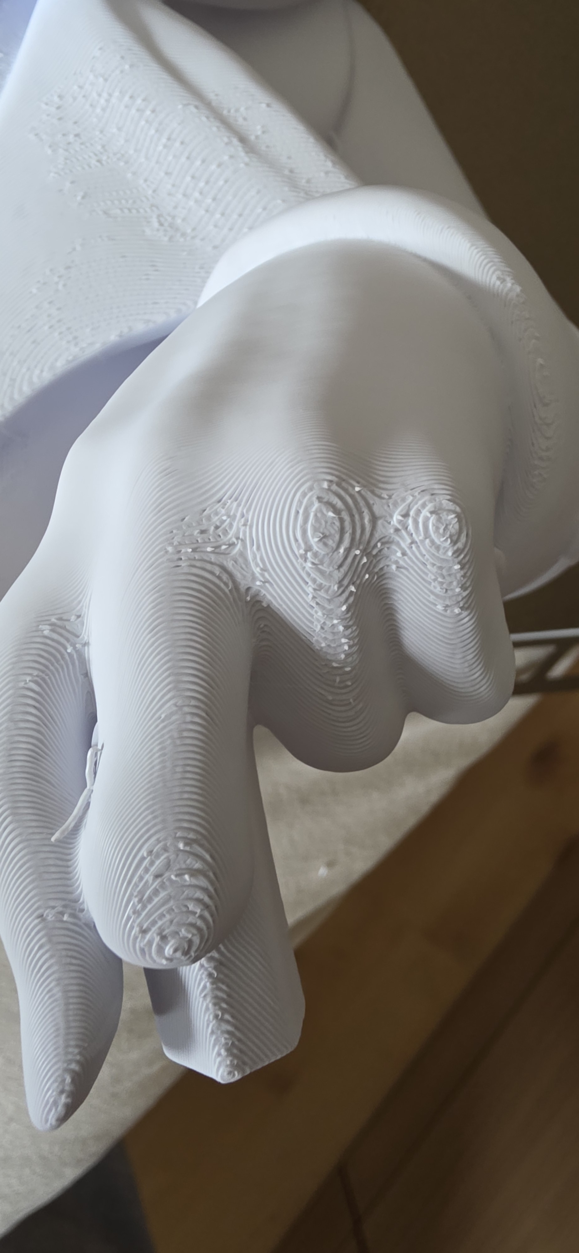

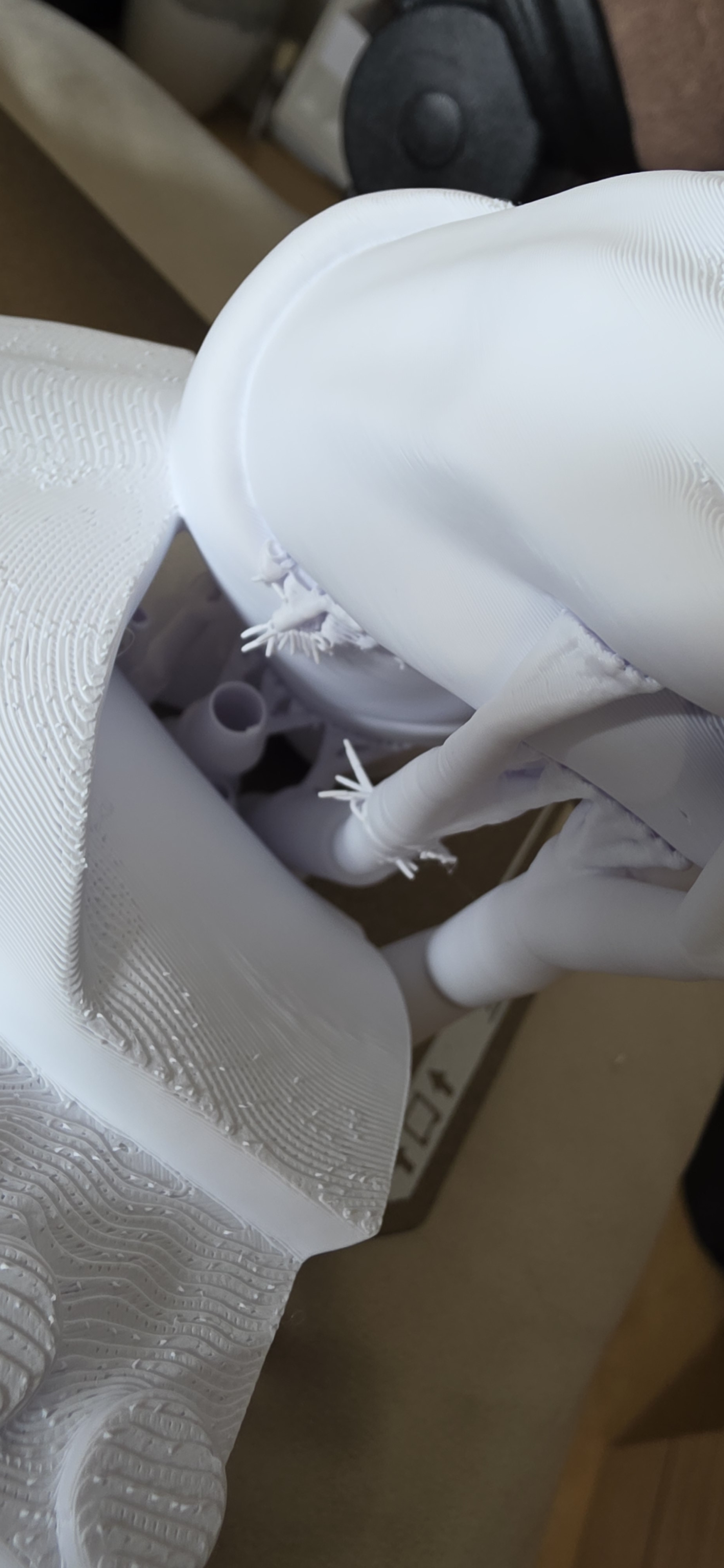

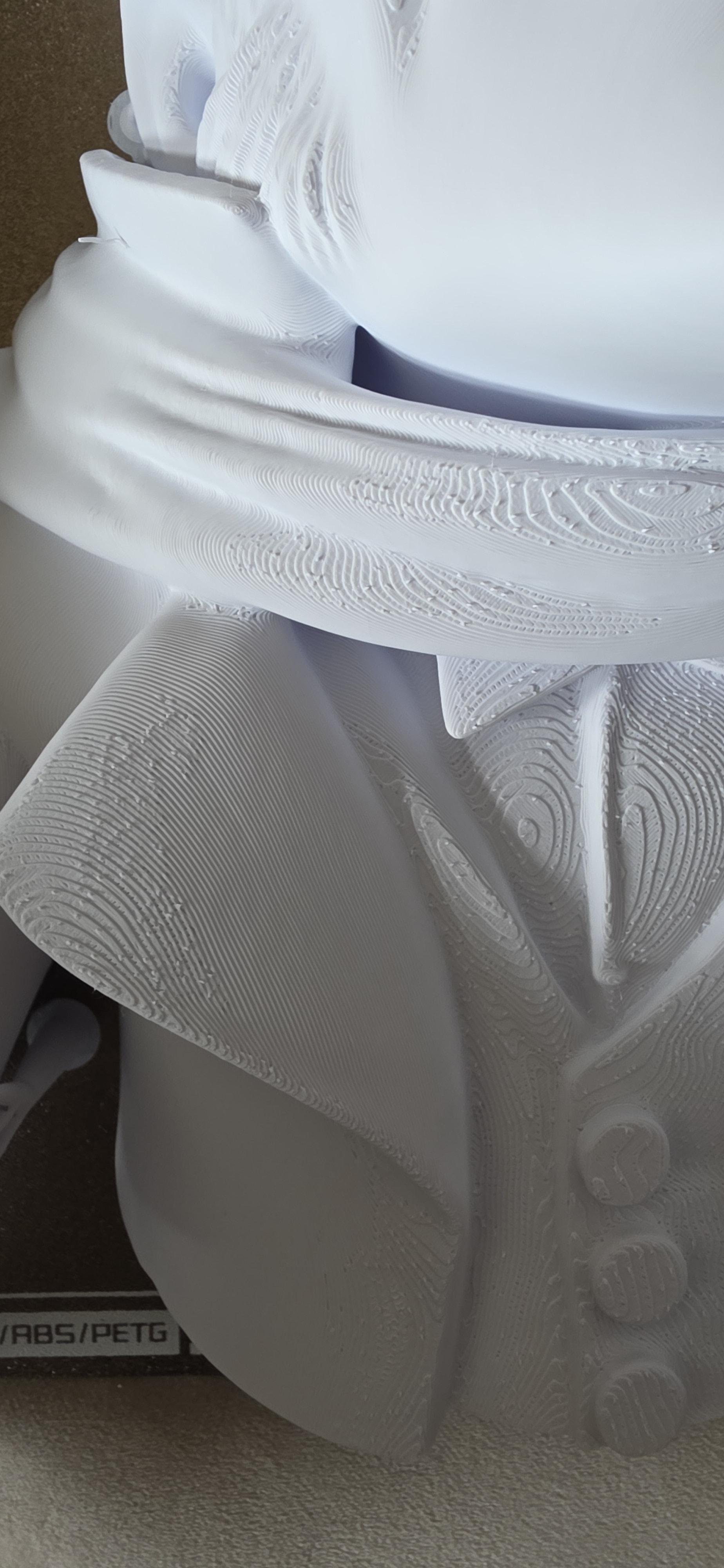

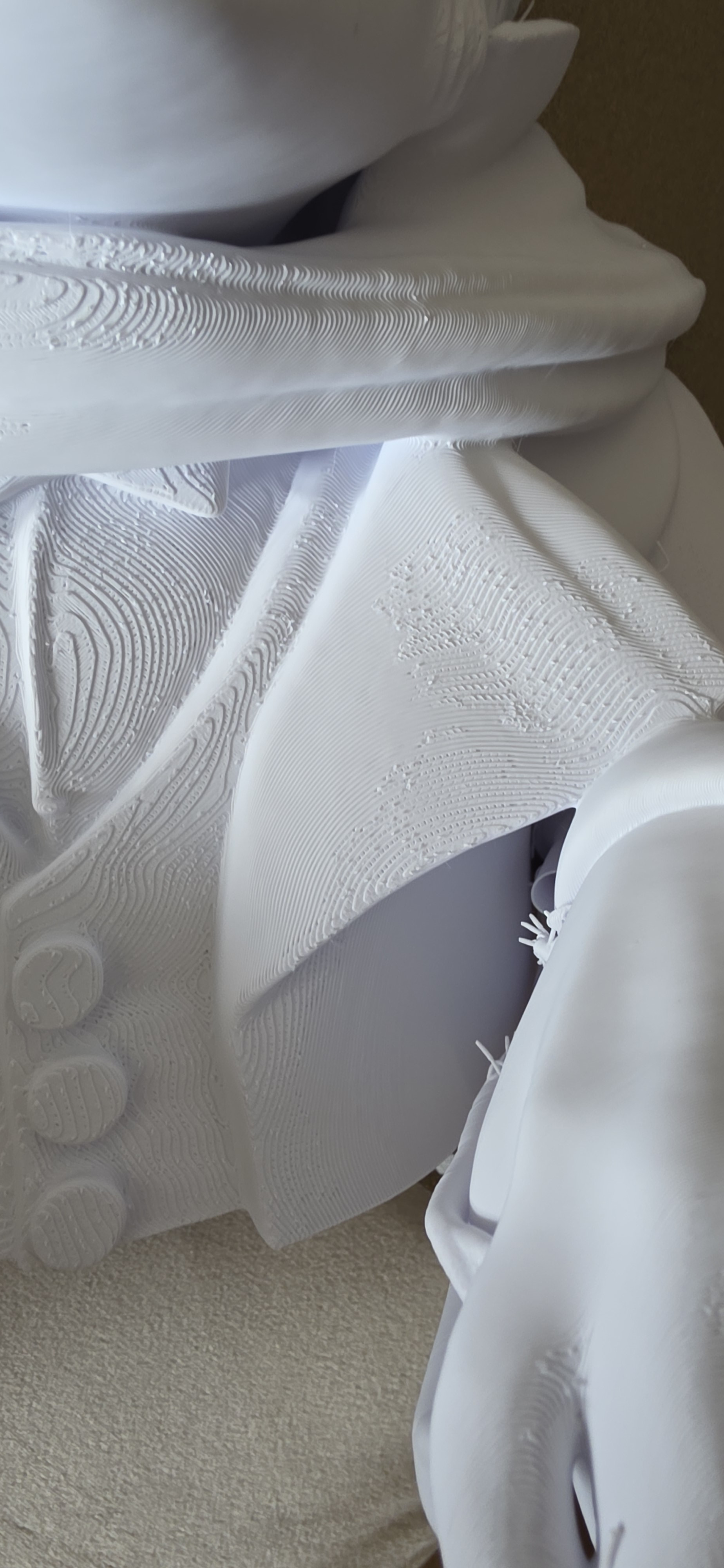

Hi, I’ve managed to get some photos as it did happen again but I decided to let it run. The print did finish but it’s very rough indeed. I decided out of curiosity to run the same file again on the old creality (which has printed it twice already) and had no issues apart from a poor print due to the machines age I’m gathering.
Not sure how much help that is but it’s the best I could show. I’m now currently printing a section of the file on the U1 just as a test but again the U1 is looking flawless
Looks like some sort of retraction or overextrusion problem – Little hersheys kisses wherever those occur.
Done flow rate calc?
Default profiles or something you customized?

Hi, I’ve done flow calibration etc and I’ve tried my own profiles and also generic and bambu. Still getting the same result :man_shrugging:t2:
Just annoying every other printer I own has printed this file with no issues yet a brand new machine is giving me so much hassle.
