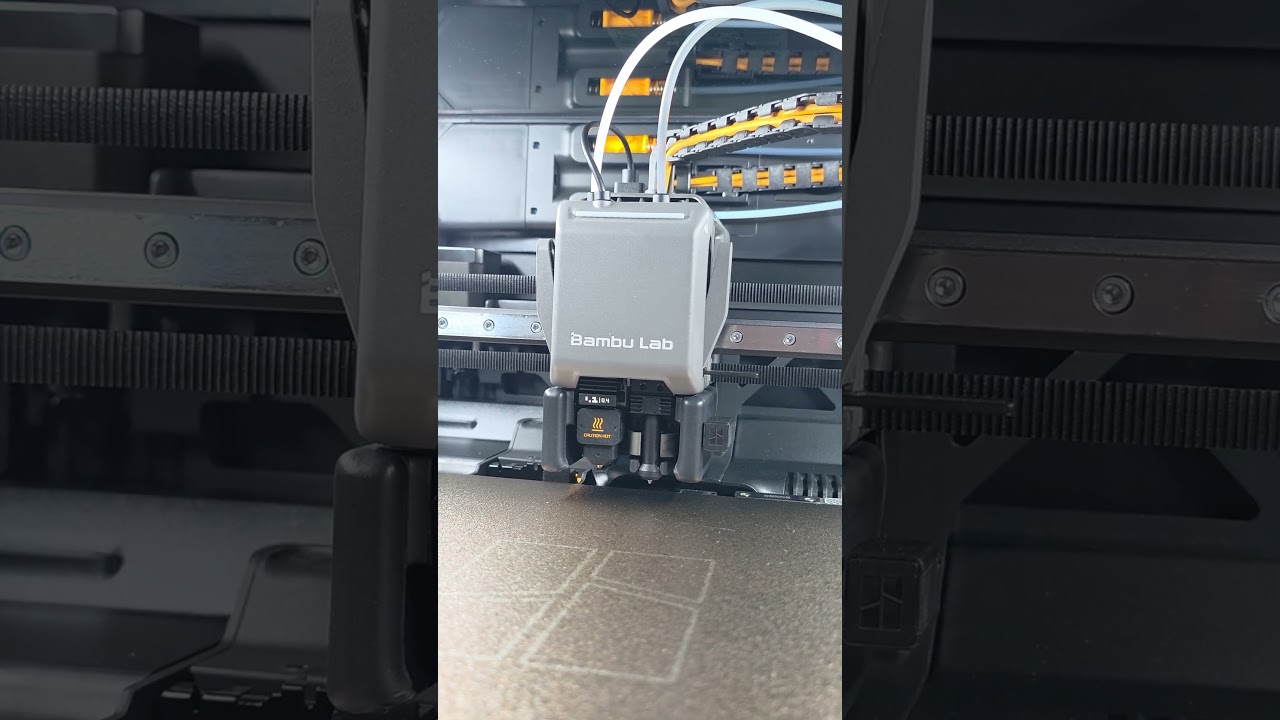

I just got and set up my brand new H2C today. I did the full 1h:30min calibration, and I can still notice a weird humming/buzzing noise or coil whine when the tool head is in certain positions. It is very noticeable after the homing procedure when the printer is just idle. Sometimes it is accompanied by some electrical crackling noise.
It is always present right after homing. But if I move the toolhead even 1mm on the x/y axis it goes away. What is this?
Here is the video:
This is very annoying and you can hear it even from a few feet away with the door of the printer closed.Is this something to be expected? What should I do? I got in touch with support, and they told me it is indeed “a little unusual” and they will get back to me. They gave me a support ticket number.

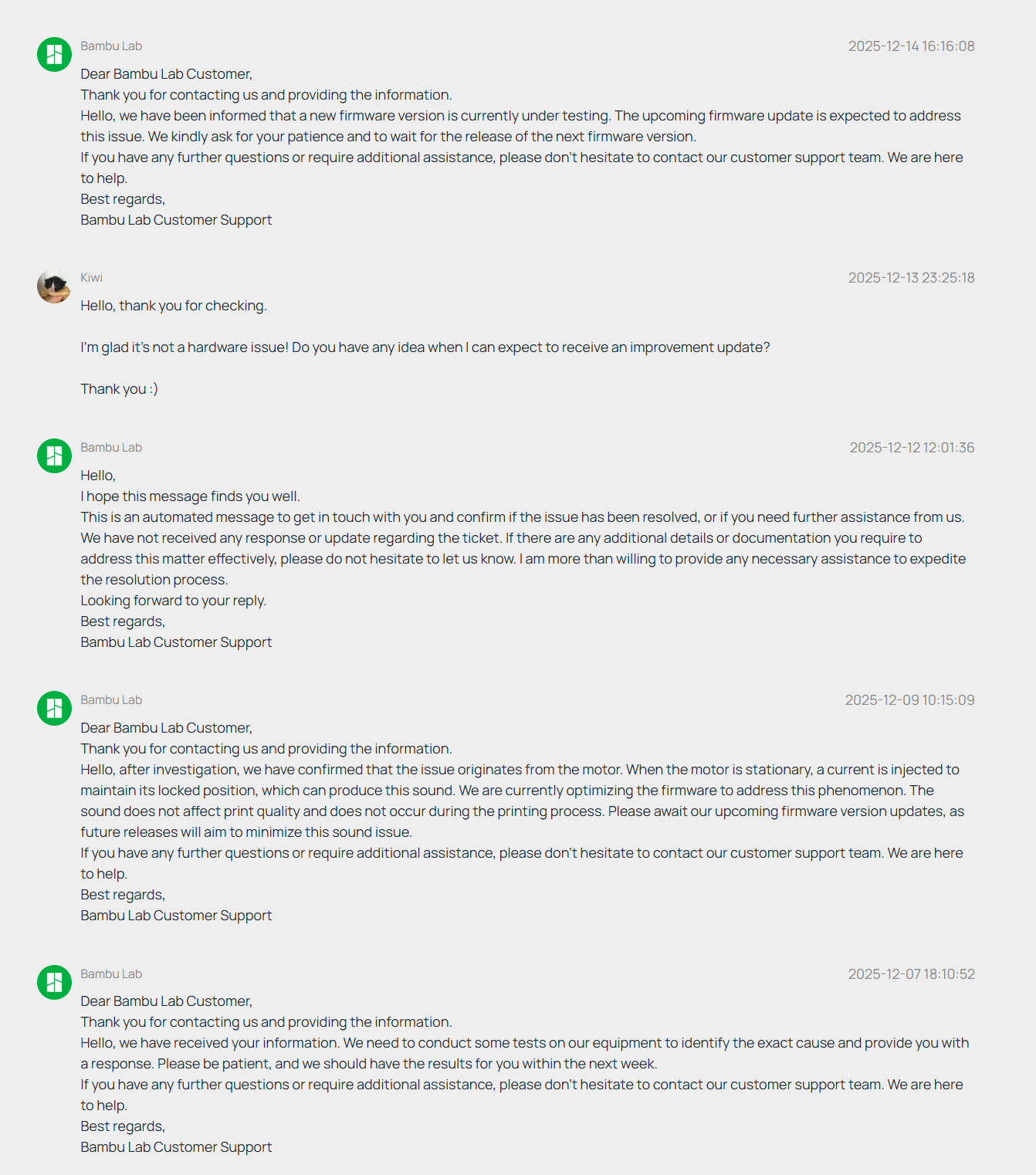

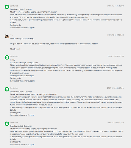

Fortunately, it’s not a hardware issue, and Bambu Lab is already aware of the problem. I reported this issue to Bambu Lab in December 2025, and since there’s been no response so far, it’s likely the problem still hasn’t been resolved.
The ticket number for my inquiry about this issue is US251206562001. When you contact the support team, passing along this ticket number may help them look into the problem more easily :smiley:

Unfortunately, at least in my case, it does not seem to be from the stepper motors. If I power on the device, the head is in the home position, no coil whine, no hum. I then proceed to home the printer again. I can hear the coil whine starting. A fan-like humming noise also starts.. The printer stops the homing procedure. The coil whine and the hum are still there. You can watch the homing procedure of my printer here:
https://youtube.com/shorts/NEhGsFyelmY?si=Y1BhrdxiXl2Krq6e
If I turn the LED strip light indicator off, the coil whine is still there but much, much quieter. (Also, when the LED is on, the coil whine corresponds to the LED blinking - goes away when LED is off, comes back when it blinks on). With the LED strip light indicator off, you cannot hear the same coil whine loud buzzing as before during the home procedure or after. You can still hear the hum noise.
Here is a video with the LED strip light indicator from under the heat bed turned off:
https://youtube.com/shorts/vbYI-nDNdp0?si=3sBlzjOz7GBY2IPb
What’s interesting is that after this second homing procedure with the LED turned off, I can move the tool head manually from the screen and in certain positions everything turns quiet (you can see this in the later parts of the last video linked in this reply). This leads me to believe it is a combination of whatever rail on the PSU the LED is pulling from, as well as the servos and the PSU. This sounds like an electrical issue to me. The printer is brand new, and I only completed the setup yesterday.. This should not be happening. I did compare and consult with a bunch of guys in the BambuLab Discord channel and they confirmed this is not present on their H2 machines. A guy even shared a video of his printer (also a H2C) and it was dead silent.

Depending on the device, hardware variations that occur within the normal range during the manufacturing process may cause some units to produce more of this hardware noise than others. To compensate for noise caused by these hardware variations, Bambu Lab provides a motor noise calibration. However, the noise currently occurring is not noise generated during motor rotation, but rather noise generated during the current supply that maintains a static position. This is likely why the current motor noise calibration feature cannot correct this noise. :thinking:
