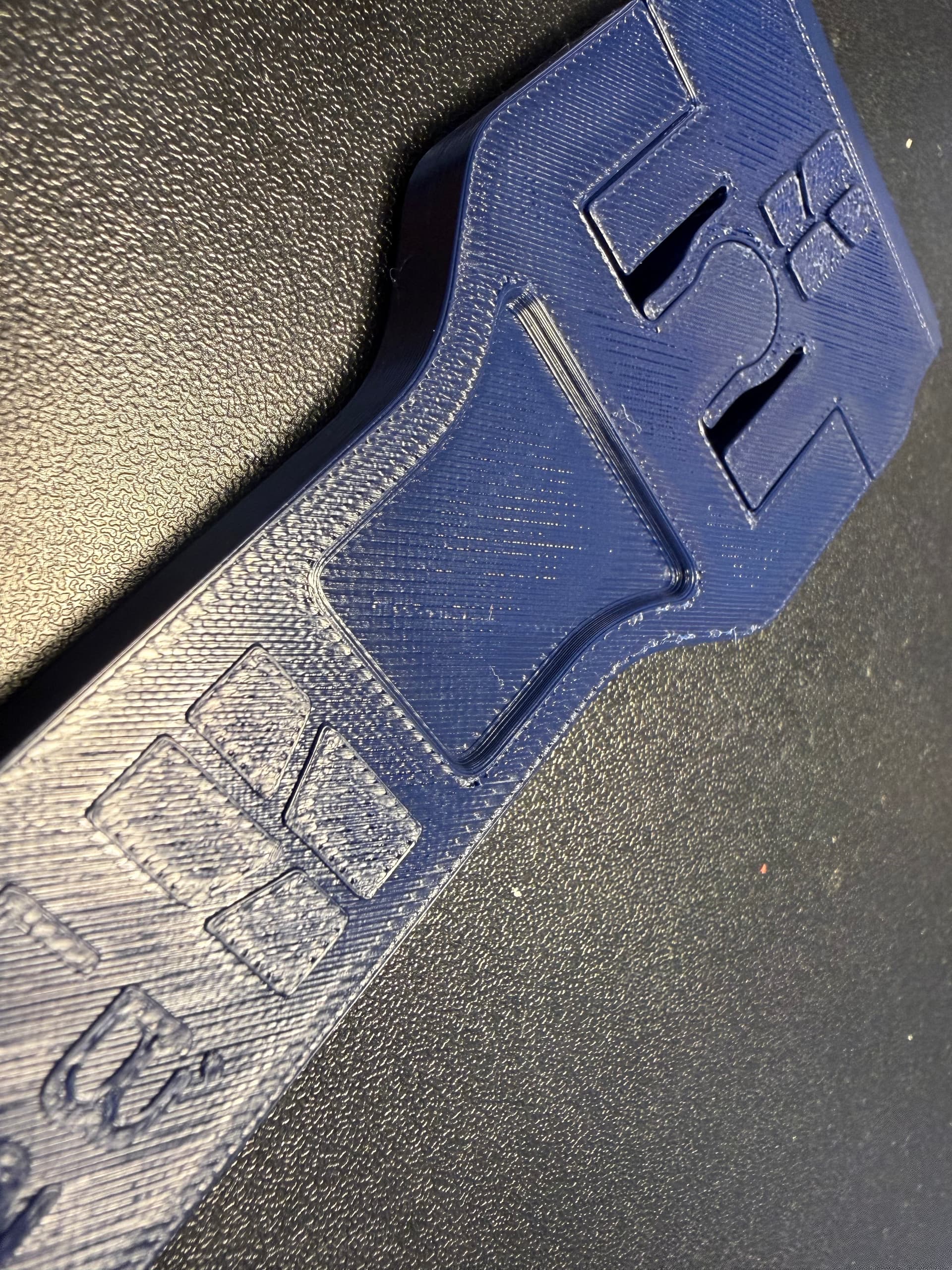

And to prove my point on the problem being material independent, here’s a scraper printed in ABS on stock settings.

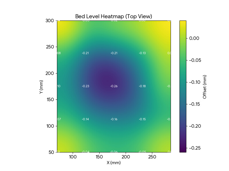

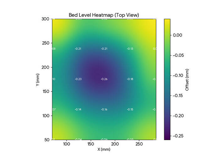

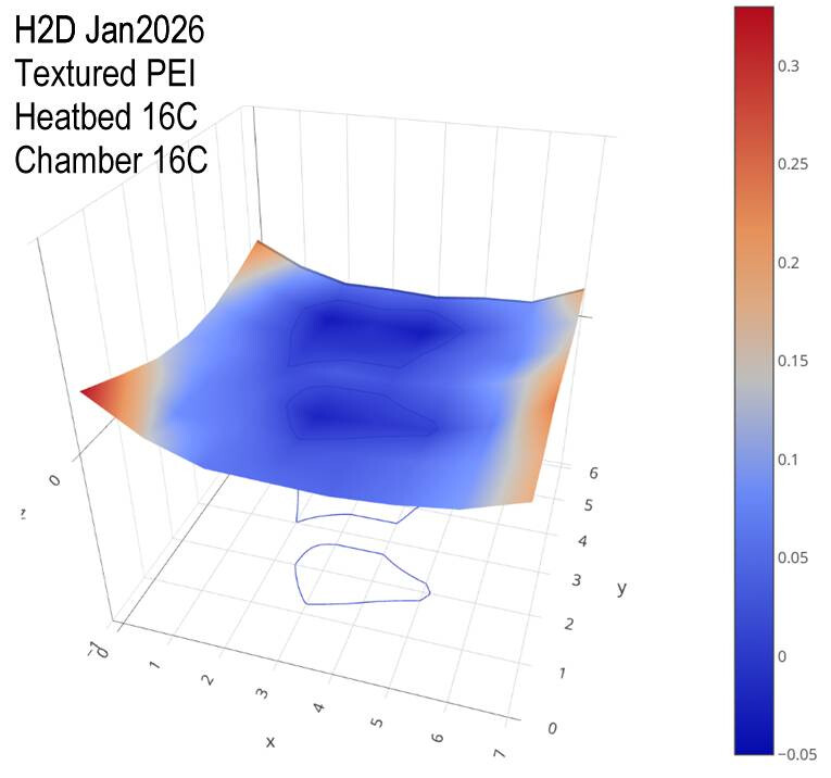

Another week of back-and-forth exchange with Bambu Support. Despite hard evidence, they still refuse to admit there’s a problem with bed evenness (0.26mm bulge compared to the corners as measured with the gauge - process analogous to the one described here).
At the same time, 0.26mm seems small enough that I’d have expected the bed leveling calibration to deal with it no problem. Yet, the first layer is utter crap.

Trammed the bed 6-7 times. Removed the front screw as well. The bed is level according to the instructions, but it is just not flat - look at the picture I attached :wink:
Calibrating stock bambu filament should not be required - they say it in their wiki. And besides, to fix my problem I’d have to bump by 10% which is just way too much to be considered normal.

FYI: Bambu Support decided to send me a heatbed replacement (which is a good news, I think), even though they think my current heatbed unevenness should be compensated for by the leveling algorithm.
I will keep you posted once I get it and replace it.
Mine is exactly the same as yours (and I think they are about all the same from different user’s measurements) and I have absolutely no issue, ABL works and compensate as expected.
Is there any automated way to get the map of the bed? Or if this manual measurement and pasting the numbers into a tool?
Unfortunately, you have to do it yourself.
I posted a guide here: Process to get your bed mesh data plot with a dial gauge
Thanks for letting me know. Sounds like my problem is likely caused by something else - time will tell.
I think it’s quite unfortunate that this information is not exposed by the printer itself. Would have saved us tons of time.

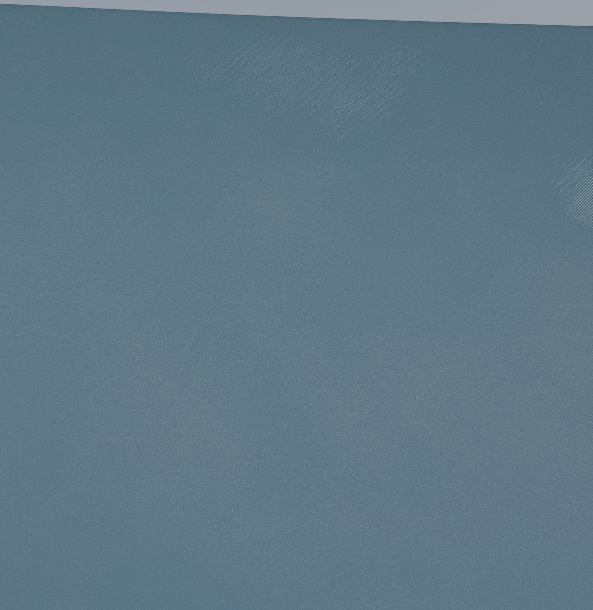

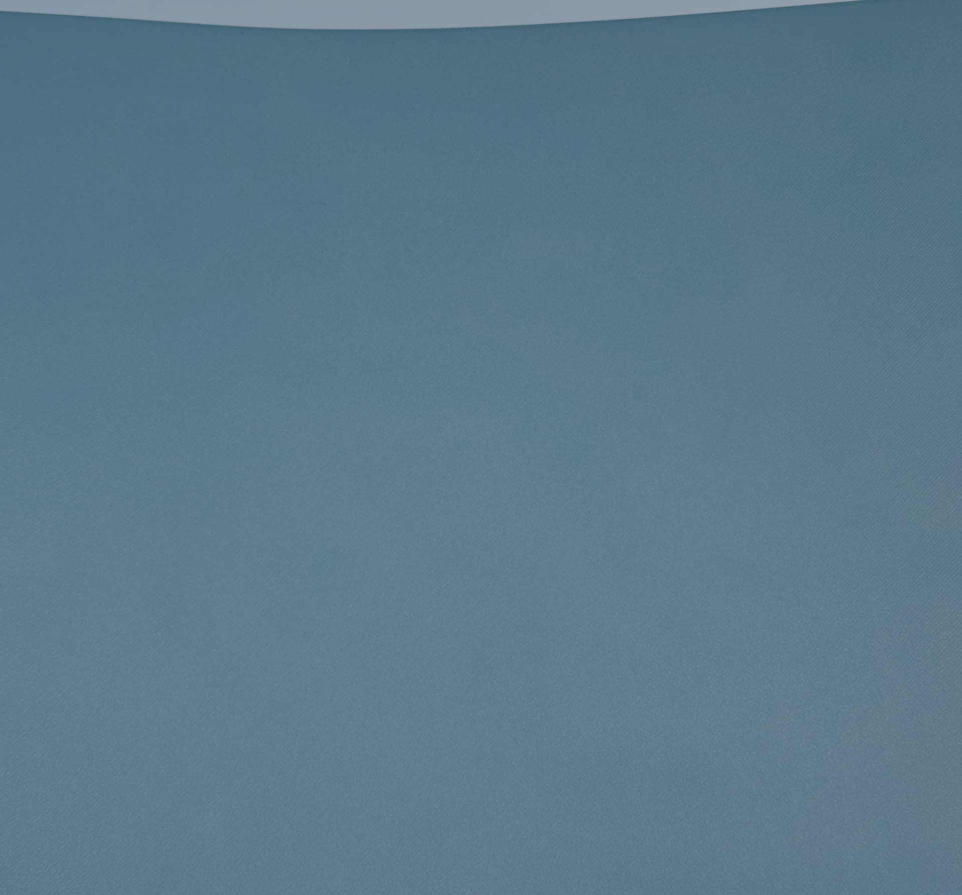

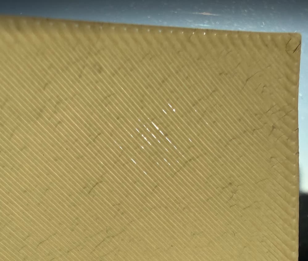

I return with some good news. Although the story is more nuanced than I initially thought.
  1. The heatbed Bambu sent me is significantly better - roughly “twice as flat”. Previously the height differences (taking front left corner as 0) were ±0.26mm, now it’s around ±0.15mm. It does seem helpful that the differences are now smaller, but it wouldn’t solve the original problem alone.
  2. I bought a brand new Bambu Textured PEI and printed the first layer on it to compare against the plate that arrived with the printer to eliminate any weird effects that a poorly produced plate could have. Funny thing here is that the new textured plate is… quite different - the grainy texture is stronger and more coarse than on the stock one which somewhat explain why on the stock one I had to lower the Z by 0.1mm to achieve any kind of meaningful quality.
  3. Yes, even after bed replacement, the original textured plate has significant impact on the resulting print quality.
All in all, to achieve the perfect first layer, I had to combine both bed replacement + textured plate replacement. Pictures below.
Before replacement, stock plate (awful)
After bed replacement, stock plate (better, but still bad)
After bed & plate replacement (perfectly perfect)
