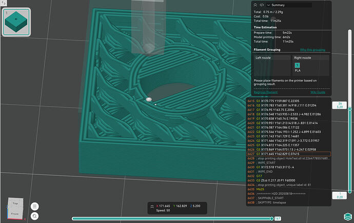

Im looking for a solution to print counterbore holes properly. I found the Bridge counterbore holes setting, and set it to Partially bridged. That didn’t work, actually the result is empty. Looks like a bug, but could be i misunderstood the setting.

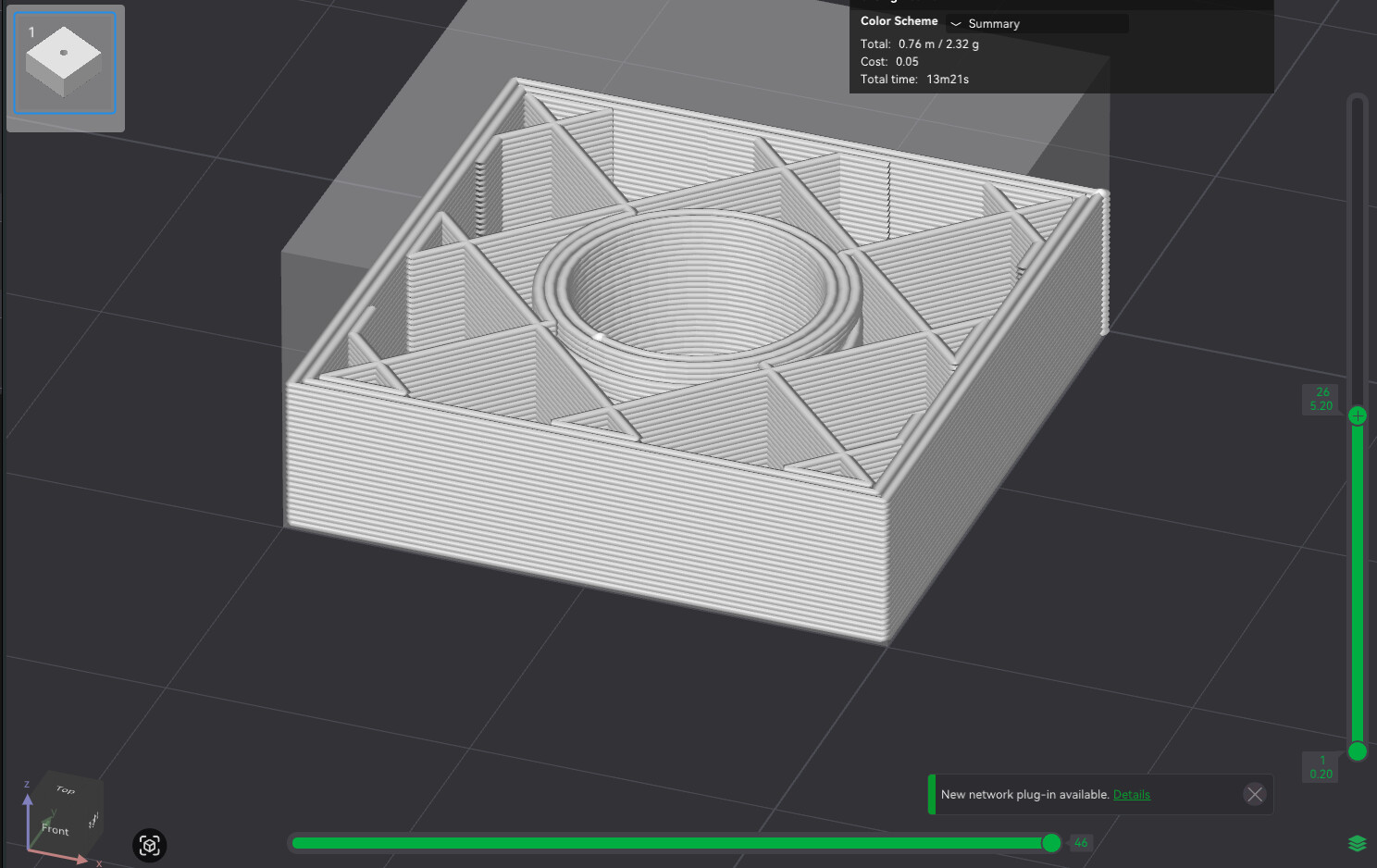

I compared the setting with Orca slicer, where it works. Also setting it to different setting looks like it is working.

export to STL and imported it into bambu studio (orient big hole to plate). Set it to standard 0.20mm setting. Only changing the Bridge counterbore holes = Partially bridged.

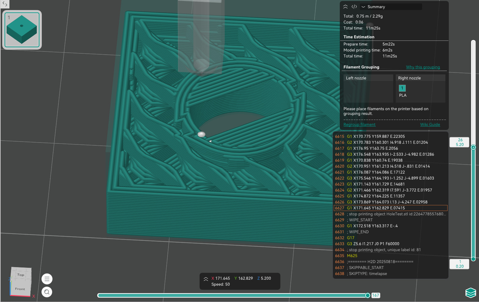

I would expect layer 26 to have some bridges above the hole, but it is empty at layer 26 above the hole. I checked with other settings and with Orca slicer, and there it works as expected.
Result it Bambu Studio:
Result in Orca Slicer:

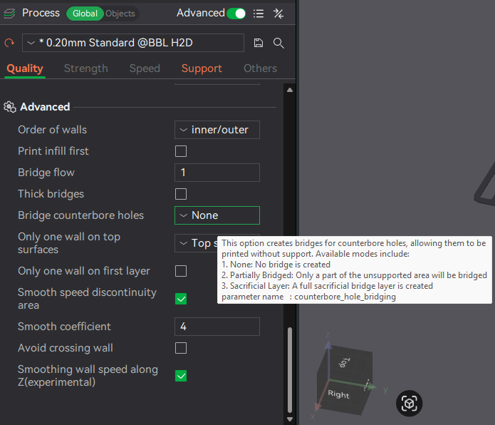

Where is this bridge feature? Did it just get put in??
To be honest, i don’t know if it is new. I’m running windows Bambu Studio V 2.8.1.55 (Beta).
[update] I checked the release notes:
It is introduced end of June in V2.8.0 also a beta. Not in a public release yet.
It is under the Quality Tab, in the Advance section.
