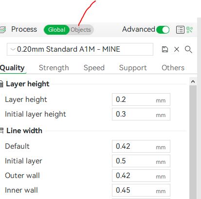

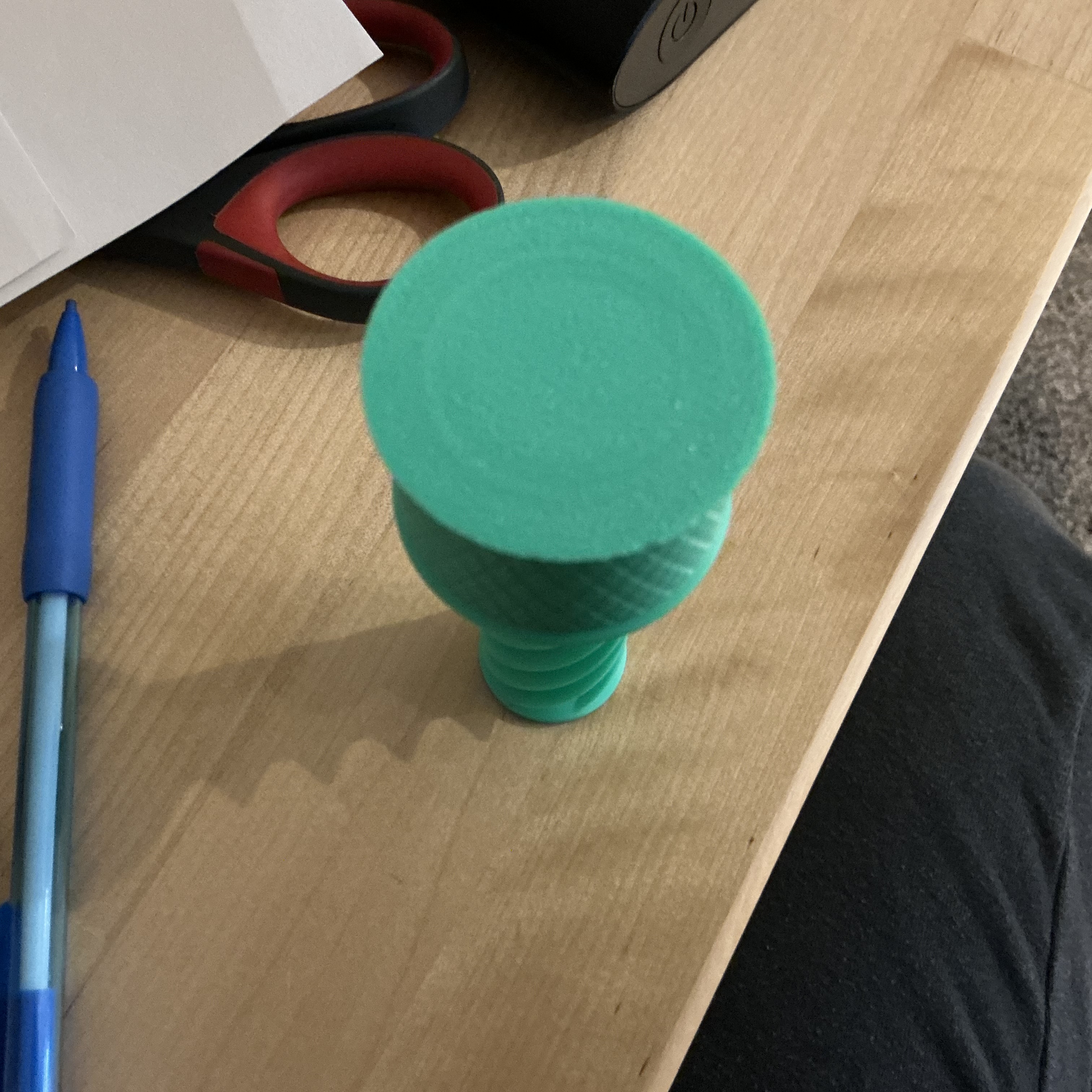

I tried to print a print in place screw, but it had an unknown brim below it causing it not to move. I never set a brim.
The Brim was probably set in “Objects”.
