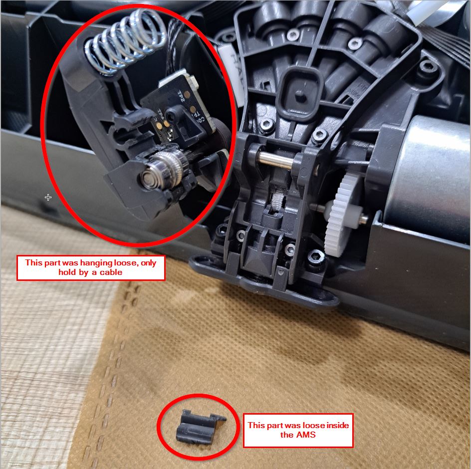

For me the opposite side broke. As I am not in US or EU, I had to deal with a local shop to get a replacement. Comment from support was “We cannot deliver to your country”. The AMS was still under warranty :sob:
As precaution for the next failure, I printed AMS Internal Hub Unit – Reinforced Replacement, which is the part that broke on your AMS and the AMS Internal Hub Unit Tension Leve, which is the part that broke on mine.
My tension lever fall appart:

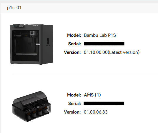

I forgot to mention, Bambu will ask you for your serial number before sending replacement parts. Serial numbers are stored electronically in each device and can be read out with Studio or Handy. Read these out before you disassemble everything.
