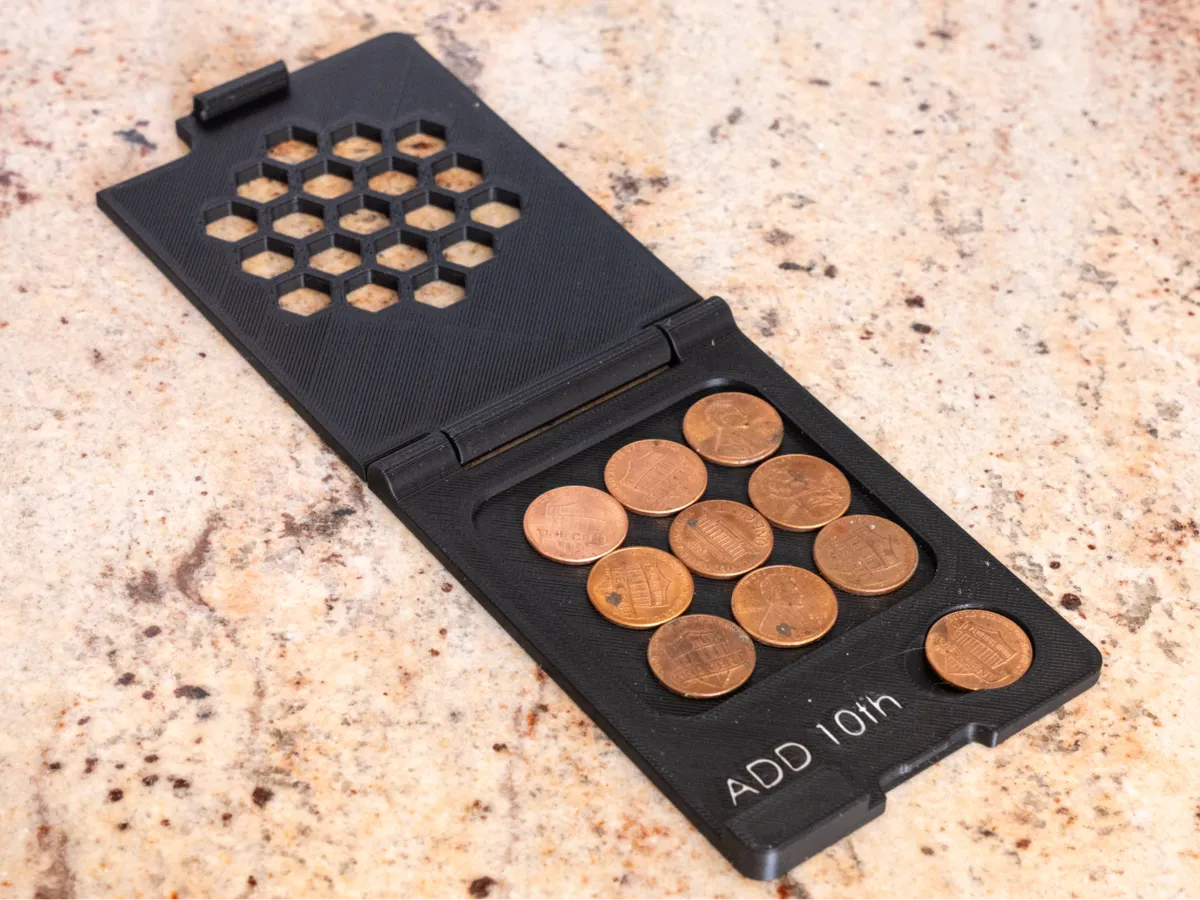

I have a model on MW that relates to the size of pennies. The model can’t be scale and work.
