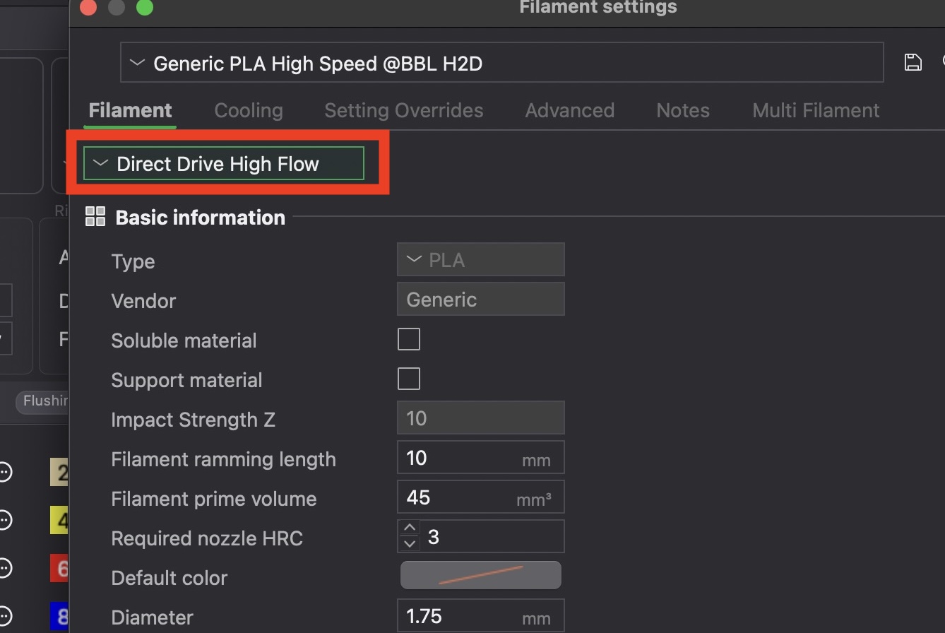

I’ve logged 180 print hours on my H2D so far and I’ve started noticing some odd behavior from the machine. I run it in Lan only mode with no network connected, manually transferring sliced files from Bambu Studio to the machine with a flash drive. I’ve noticed that even when I create a custom filament with custom parameters, the H2D will take the default filament profile from whatever is loaded in the machine. I’ve tried increasing and decreasing nozzle temperature for a few different filaments but the machine seems to just ignore my settings and do its own thing.
I’ve mostly noticed this when I’ve tried to print ABS. I have a few spools of non-Bambu abs. One of them prints great with the default abs profile but the spool of hatchbox abs I have is printing too hot at the default 270, when it should be around 240-260.
Is this expected behavior or some kind of bug? Is there some way to load my custom profiles on the H2D so I can select the correct filament in the slicer AND when I load the filament? This is my first Bambu machine so I’m new to the ecosystem.
Are you on HF hot ends? The temps and all other settings are separate for standard and HF nozzles.
So that’s what’s in that dropdown! Thank you!
