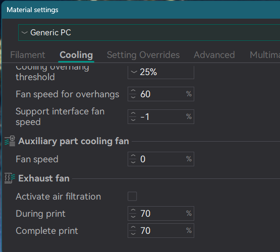

I have a BENTO Box installed, (BentoBox V2.0 Activated Carbon Filter by thrutheframe - MakerWorld) but I have been working on an external HEPA/Activated Charcoal box for my P1S to further reduce particulate and VOC emissions. However, I am concerned about the extra back pressure that my external filter/charcoal will impose on the Chamber air flow and how it will affect the build chamber temperature.
I did a few test prints to see what the fan settings were as function of filament type, and (for layers 2 and above) when printing TPU the Part fan = 20%, Aux fan = 70% and the Chamber fan = 70%. But for PLA the Part fan = 0%, Aux fan = 70% and the Chamber fan = 60%.
I donât know how Bambu decides on these Chamber Fan settings, but I assume that their settigs are making a crude attempt at controlling the temperature of the build chamber, and are accounting for the back pressure created by their internal activated charcoal filter.
In an attempt to compensate for the additional back pressure my filter system will impose, I am adding an external fan and using a 4-wire fan control module with a temperature sensor inside the build chamber to control the speed of an external fan attached to my filter. Without active heating, I wonât be able to get the temperature of the build chamber above that of the Build Plate, but I will be able to prevent the build chamber from getting too cool.
The P1S enclosure is fairly porus, so higher Chamber fan speeds means more external air is pulled into the build chamber, overriding the heating effect of the build plate. I am also assuming that with the additional back pressure imposed by my filter, the internal Chamber fan will basically be ineffective, and the chamber exhaust air flow will be determined by my external fan.
Any thoughts on this approach to the problem would be appreciated.
