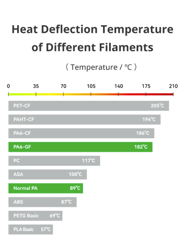

I am going to make a little candle holder for my brother… I want it to be kid-safe and easy to use. I am thinking about using a Target brand glass candle, and a 3d printed futuristic fire pit to surround it. Any tips for making it top-notch quality and safe for him to use?
I plan on using PETG around the main candle area for better heat resistance, and wood filament for the rest. For the lid, I will try to glue aluminum foil into a PETG lid that is wood PLA on the outside. It will look like a cover for the fire pit.
Any constructive feedback is absolutely welcome; this model will likely be available on Makerworld soon.

Plenty of shops sell plastic candle holders. There is no reason you can’t print one. I would use a fire resistant filament - not just one that has high temp resistance, but one that melts instead of burns. Bambu has one, though I can’t remember the name PC-FR I think. The advertise it for electrical enclosures.
Dripping wax needs to not melt and deform your print, so make any features in the drip area thicc [walls,tops,bottoms] and out of something that can take some heat ideally.
It could be a fun excuse to use some wildly over the top engineering filament designed for high heat,
src:bambu
And then there’s like fiberon PPS-CF that rings like cast iron if you strike it, and can take 250C heat.
