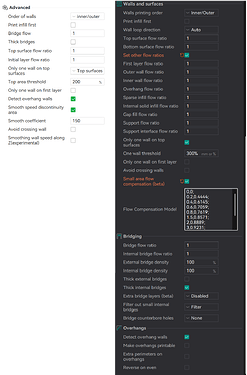

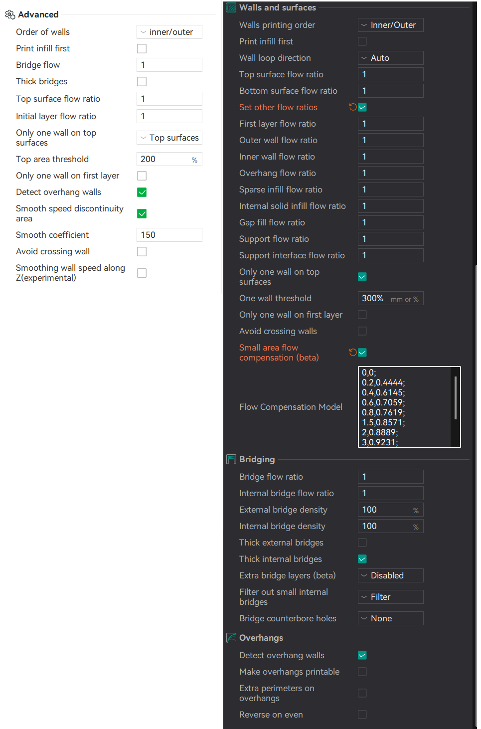

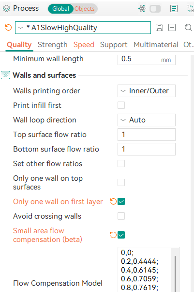

Do you happen to have “Small flow compensation” enabled? I find that setting [or at least its default value map] to really interfere with 0.2 everything since its already at such low absolute flow.
Where is this setting in bambu studio, I can’t find it
Unless Studio uses a different term, I’m pretty sure Small area flow compensation is only available in OrcaSlicer.
Not sure if orca exclusive, but its under quality→walls/surfaces
Orca does offer a little bit more control.
:grin:
Studio left, OrcaSlicer right:
OKI do see option on Orca… But I’m not really sure how it’s addressing my question. My question is what are you guys using to actually ascertain what the correct flow and PA numbers are with the .2 nozzle, since the built in tests are designed for .4 nozzles.
I mentioned it because if you have it enabled, all your 0.2 calibrations will print looking the same, since that setting makes large changes at low flows. Feel free to share more/pics about the issue
