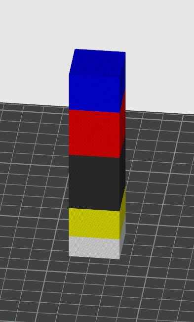

Let imagine your model is looking like this:

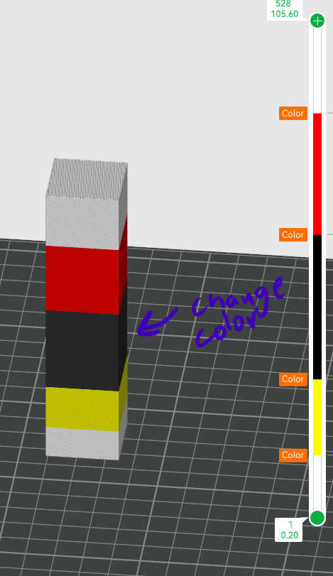

What i would do is set the last and first color the same (turn blue to white) and change the roll of white mid print from the AMS to blue.

Thanks for the answer. Yeah, this seems to be the only way. But I think its silly that Bambu Lab force us to do this ‘sleight of hand’ to make it work.
