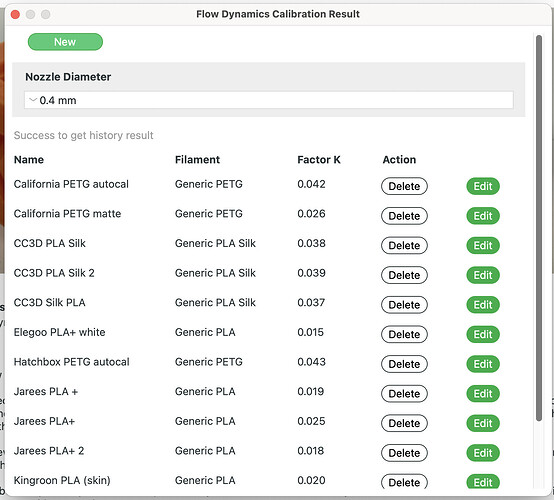

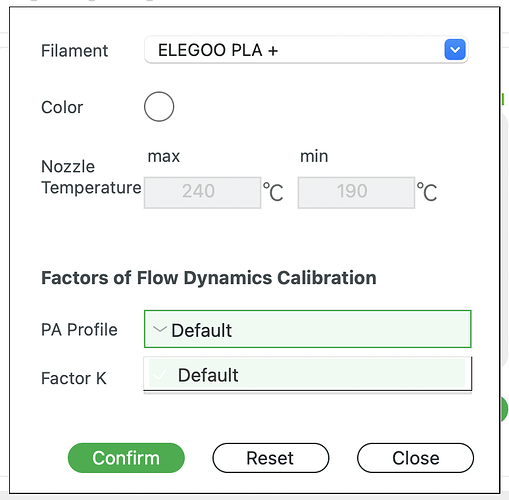

I am struggling with filament management on my X1C. I have spent tons of time calibrating my filaments, but the PA profiles don’t appear selectable anywhere. When I click the PA profile pulldown in the AMS filament selection under the devices tab, it shows only the default profile. I can’t edit the value directly either. Can someone point me in the right direction?
The filament has to be defined and the calibration profile has to match the filament name.
Only matching file names show up on my P1S.
Thank you, getting the names matched up has allowed me to see and select the profile finally. I wouldn’t have figured that out on my own.
