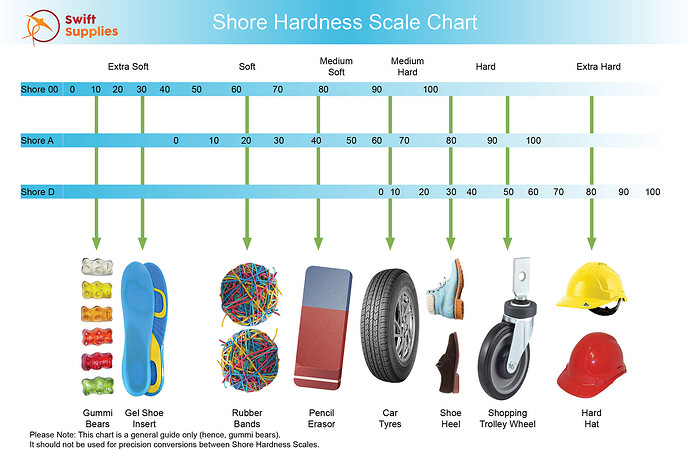

There is TPU for the AMS - I use it regularly in my original AMS with no issues.
That said, I do not know how it compares to a regular TPU but suspect AMS TPU is more firm that regular TPU.
You are correct, it is. It is rated at 68D Shore hardness, similar to that of a common softwood. That’s somewhere between a shopping cart wheel (which is softer) and a construction hard hat (harder). Its main advantage is that it won’t break easily; it is more of a “flexible” or “tough” material than a “soft” one. Use it for impact resistance, not softness. :slight_smile:
Chart from Durometer and Shore Hardness Explained
@Bratling - awesome, supportive info - thank you!
