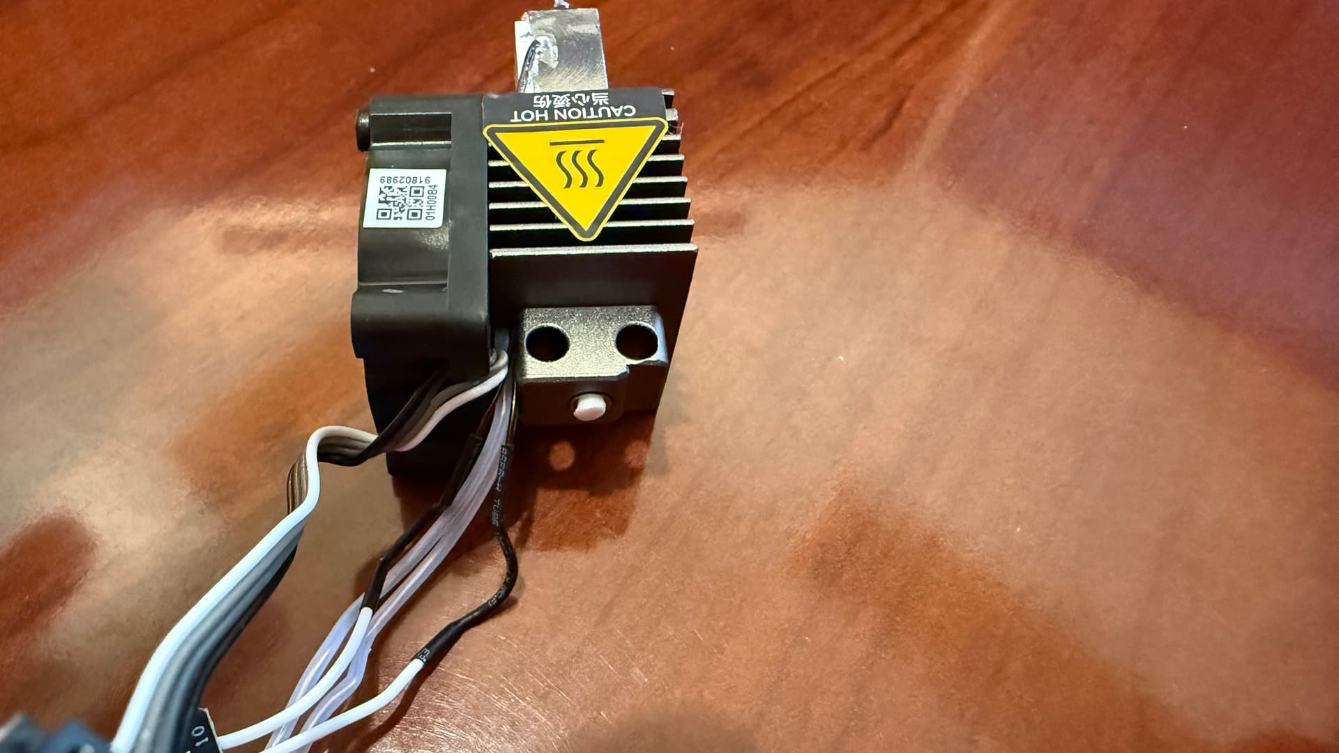

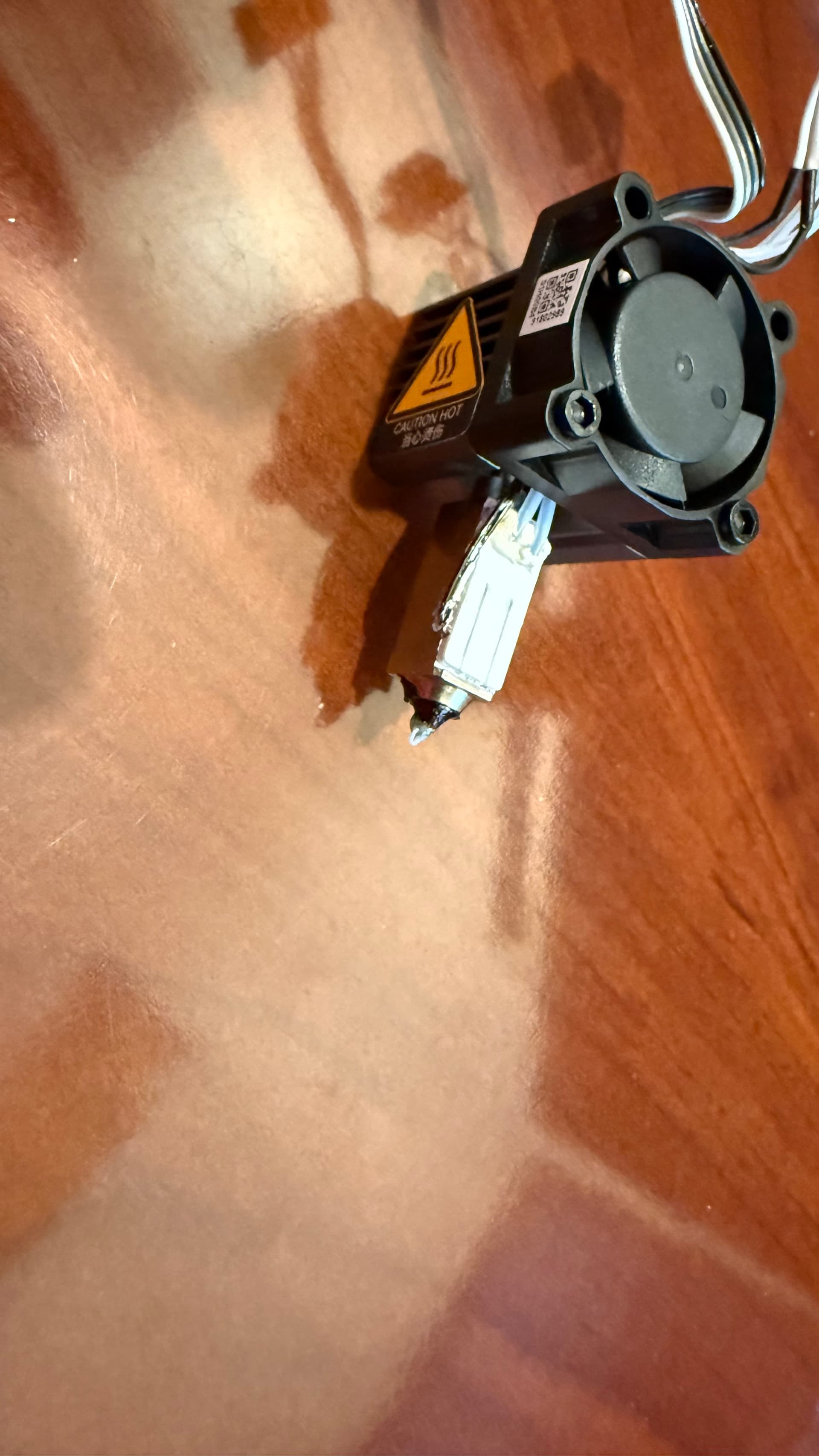

Can this hot-end be saved? Filament cut and stuck :(
I have some filament that is stuck in the extruder mechanism, and I made the horrible mistake of cutting the filament in the hopes that the AMS would unload successfully, but of course I wasn’t thinking through everything and now have a hot-end with filament that I cannot grab on to.
Not sure if this is useful, the filament stuck in the hot-end is Bambu PLA Basic White.
Thanks for any suggestions!

Thanks, this helps especially the second link. I suspect the first link is the cause as well, likely causing the filament to deform too early.
Update: I have been able to clear the jam from the extruder, now back to re-assembly and following the process to unclog the hot-end. Will post results once done.
Update 2: clog removed using the hex wrench method!
