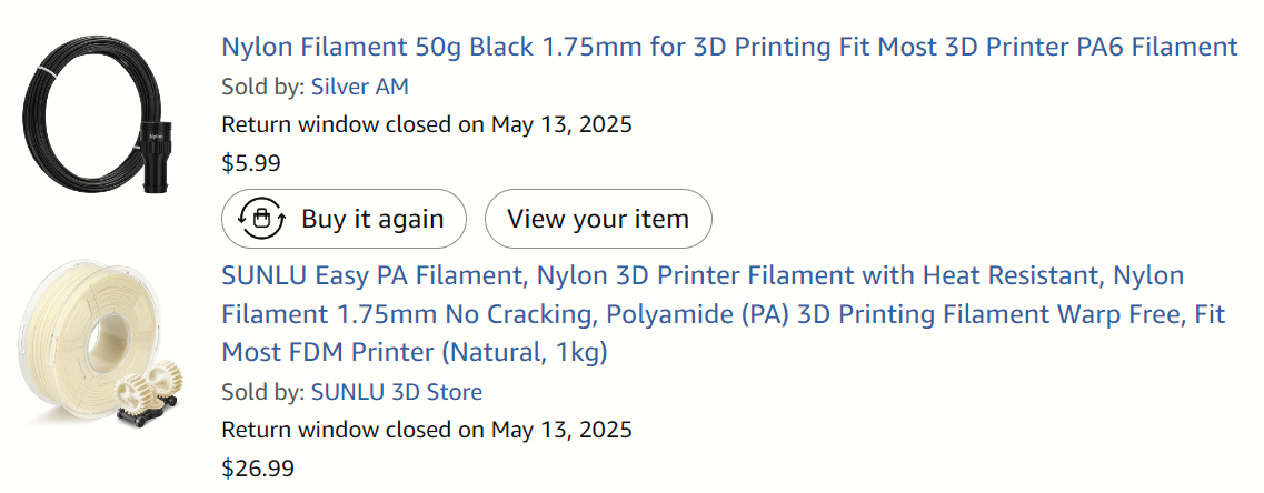

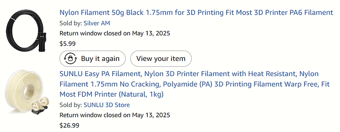

Over the past two years I’ve purchased several 50g PA6 nylon filament samples, and most were garbage, very hard to print and overpriced for a 1kg spool. If you can still find it, the one that stood out for ease of use was Sunlu Easy PA. I barely had to calibrate it; I think I just used the Bambu Lab PA6 profile and made minor tweaks.
I bought the older formula a few months ago on sale, but now I see it’s no longer stocked on Amazon. From their website, it looks like they may have exited the plain PA6 business, since all of their current PA6 options are now either -CF or -GF. You may still be able to find some stock floating around online. Either way, it was the only one I had used that wasn’t “fussy”.

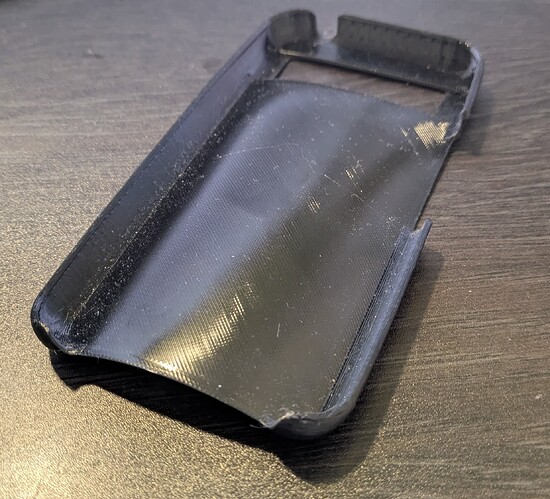

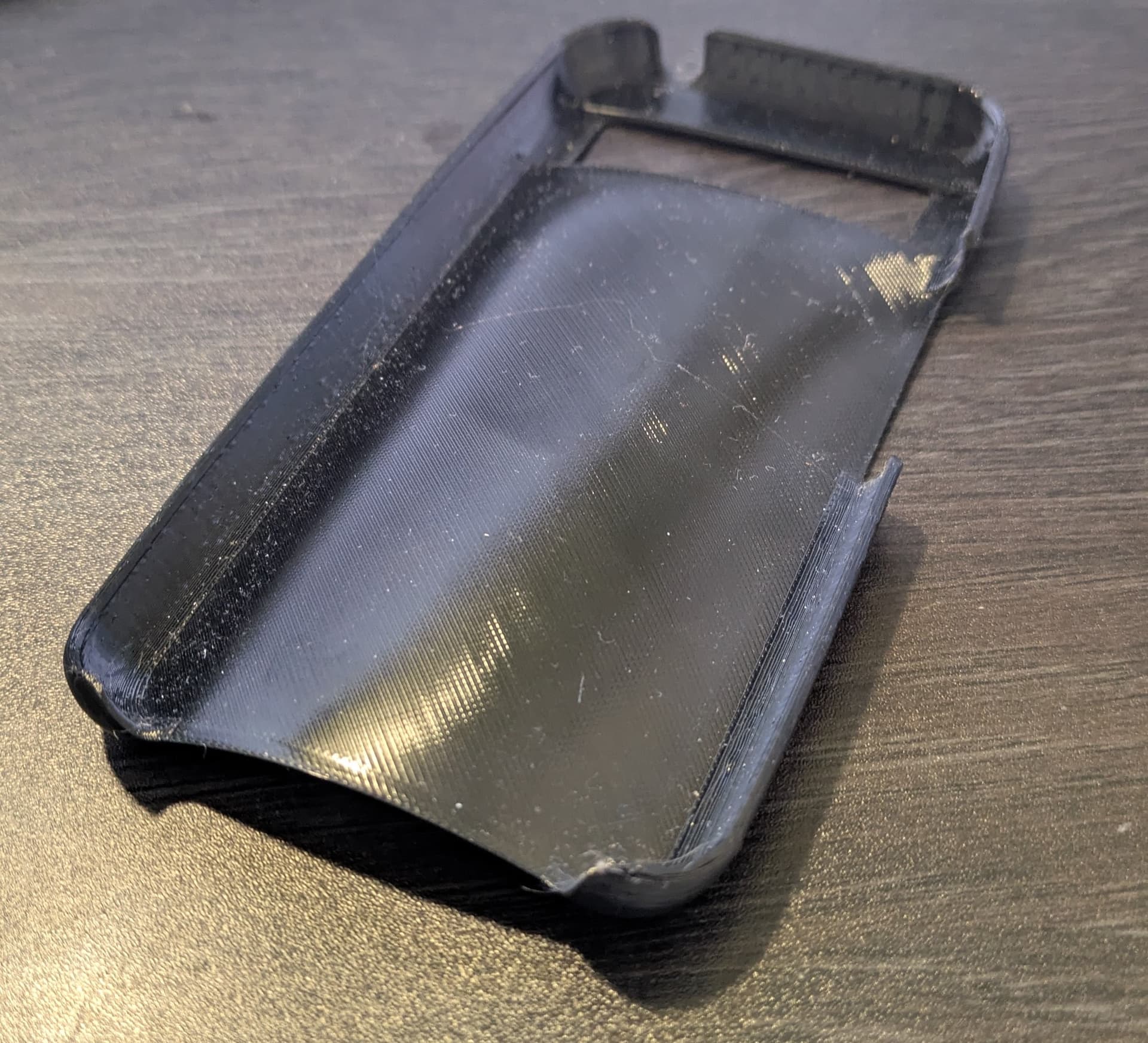

My part was printed correctly (EasyNylon) - I printed a phone case for a test,
but warped and bent horrendously in a next few days… what to do ? how to stop it ?
The case was flat when I printed it and fitted a phone.
1-2 days later:
Did you anneal it? Temp definitely got to it over time, specifically when charging. Would be a very tough part to print and anneal, have it keep correct form without a negative helper piece or something. Maybe a different material.
no I didn’t. should I anneal pieces straight after the print ?
I’ve also used Sunlu Easy PA, and I generally like it. It’s really easy to print, even on an open printer (at least for small objects).
What I don’t like is that without annealing, it has low heat resistance, and when annealing, it often warps unpredictably.
Therefore, I unfortunately can’t use it for some of my planned applications.
Yes all nylon should be annealed for a few hours. Overall 2-4 hours.
Since it wasn’t annealed it was still holding tensed up energy and what little moisture was left.
I just printed some rather large models for my SUNLU A4 and I annealed them for a couple hours and they were drastically stronger and more reliable.
