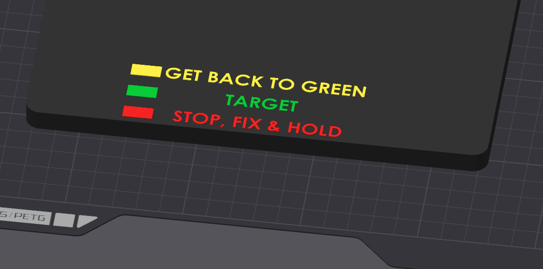

None of those options seem to work. Here is my part, normally when the file comes in all the letters and the main body are all the same color filament. I need to assign each letter a specific color. When I do the Shift and window drag, it selects the top main/top item in my Objects tree, not the individual parts that were broken out when I did the split to parts function.

The first screenshot has four obvious objects, three text and one background.
There is no painting, so that is not the issue.
You said you have previously experienced file allowing you to individually access each letter separately.
It does not look like this is the same this time.

Your issue is that the parts are already merged into an assembly. (See the little green plus mark on each part)
So the Shift drag will only select the top level.
GIF 2025-11-05 11-20-48 AM
What you need to do is select the assembly, then select the the individual part from the side menu and the use shift/ctl to add each additional part.
GIF 2025-11-05 11-24-00 AM
I designed the model. In the CAD model every letter is a separate body. I do this so i can ensure that each letter gets properly colored. The entire model is saved as a single STL file. When I bring it into bambu, i orient it and then select split into parts. I then go through the Objects list and select which ones I need and assign the filament color I want for them. So you are correct, no painting is done.
Yeah, this is what i’m already doing. The part that stinks is the letters are not always sequential to the sentence or with any rhyme or reason to their order. So it takes a few minutes to sort through them all and assign the filaments to each. This can take even longer on more complex models with 3-5x as many letters.
