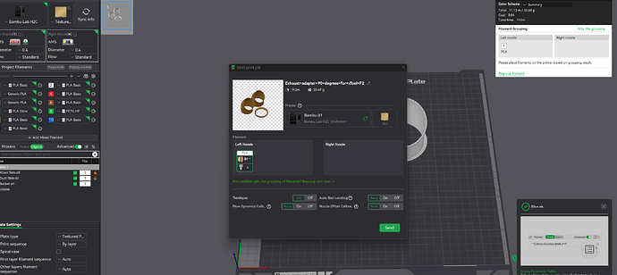

Every time I go to print after selecting the color of filament I want to use the slicer selects a different filament? this started after the last update. If you look in picture to the left I have the white filament selected, however the white is in the right AMS not the left as seen in the right window and it is selecting the brown in the Left AMS. I am very confused.
Just click on the filament in the left hand window and drag it to the right hand window.
I do that now, however before the update it did not do this. When I selected a color it changed the color of the object and selected the proper AMS with that color automatically. I was just wondering if there was a setting I am missing

Are you slicing the file in ā€œsavingsā€ mode, vs ā€œconvenienceā€ mode?
Just because you have the filaments loaded a certain way, it doesn’t automatically use the configuration. It will make suggestions to save on filament waste and time.
I’ve submitted a bug for this. It’s being investigated
Yeah latest bambu studio version always tries to push for left hotend, very annoying, pretty sure it’s because of the x2d where they’ll want to always prioritise that left hotend, but it makes no sense on the h2c

Update released today: Release 2.6.0 Public Release(Hotfix) Ā· bambulab/BambuStudio Ā· GitHub
Listed in bug fixes:
  1. Fixed an issue where H2C slices always assigned to the left nozzle in filament-saving mode.
-Max
This solved my issue! Thanks to everyone that put some brain power into helping me with this. Thank you
