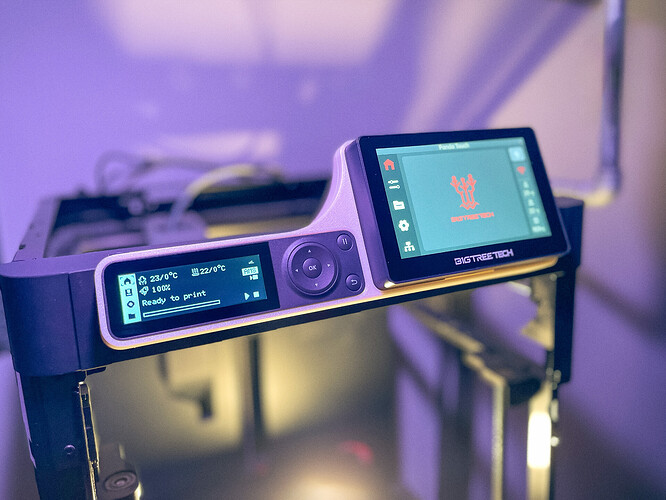

I have a P1S and replaced the default controller interface with a BIQU Panda Touch. The Panda Touch has never been an issue but it lacks the ability to set the nozzle diameter or nozzle type. This has never been a problem before because I always specify this in Bambu Studio, however now it seems Bambu Lab have removed the ability to do this so after putting my 0.2 nozzle back into the printer I can no longer use it.

One suggestion, use a mount that lets you mount the PT and keep the stock screen for situations like this. Heres the one I use:
I don’t use the Panda and I had no idea you could actually keep both connected to the printer. Good idea!
Thank you. Yeah, the Touch only monitors the printer through wifi so you can really mount it anywhere and not modify the printer at all. I’m glad I kept the stock screen because not just the nozzle size but you also can’t turn the AMS 2 Pro drying on from the Panda Touch.
