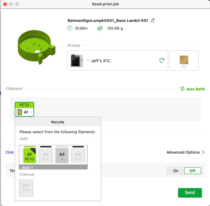

The last 2 updates included some changes to the AMS and a Mac fix but I can’t figure this one out. I cannot change from the PETG in slot one to the black in slot 2 or 4 (photo included). I’m sure I’m missing something simple but I’m just not getting it. Also, does anyone know what the small checkmark is in the upper right of slot 1?
Unless I am missing something from screenshots not provided, it likely means you have selected a filament from the filament selector that is PETG.
If you do this, you can only select PETG when you get to choose the filaments during the print dialog window from your AMS.
If you wish to use PLA on slot 2 or 4, change the filament used in your model to PLA.
That did it, thank you. I knew it was something that I must have forgotten!
