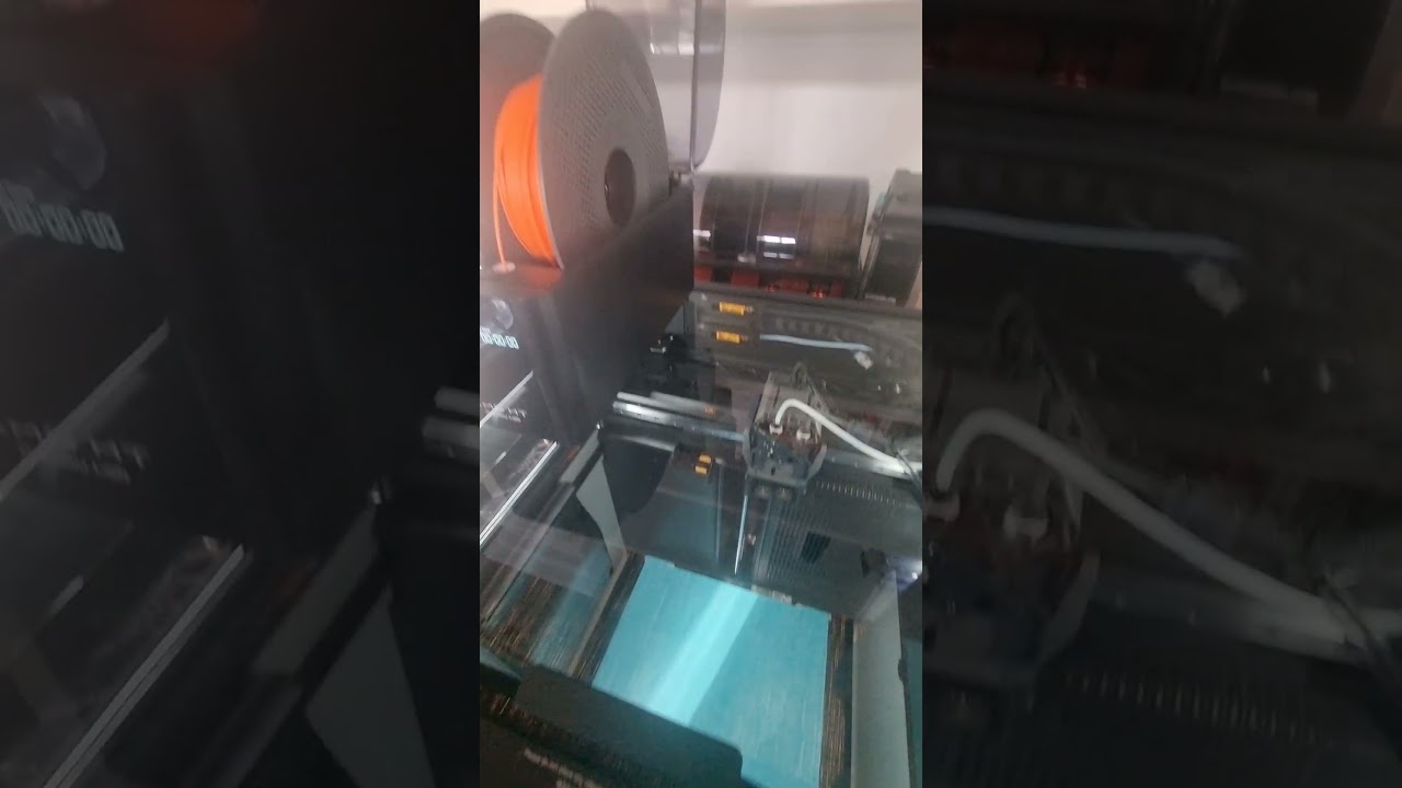

This started with broken filament in my idler yesterday evening. I fixed that but this morning the printer has stopped again mid-print. I unloaded the filament but it won’t load again.
I cannot load filament on my left extruder. The filament is pushed through the ptfe tube and when it reaches the toolhead there is a clicking noise (Which Im guessing is the servo motors trying to pull it through).
Has anyone see this before? Any ideas?

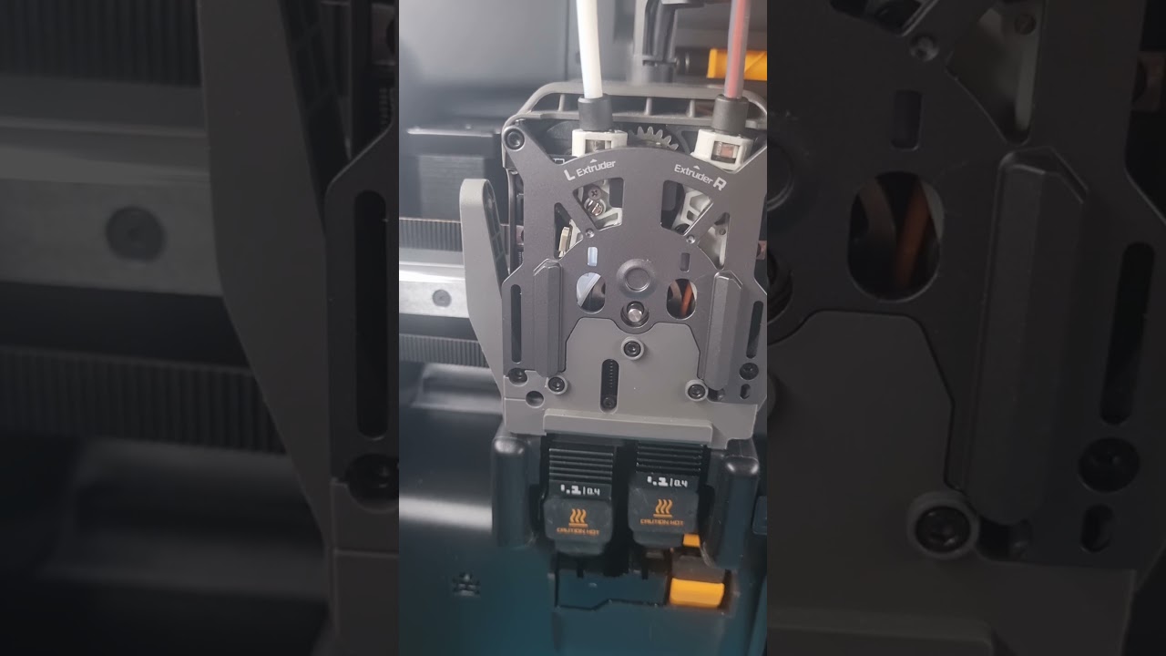

What have I tried:
  • Confirmed that a piece of filament passes easily through the idler when the toolhead was stripped.
  • Swapped AMS-HT and AMS2. Both fail on the left extruder. Both work fine on the right extruder.
  • Changed the ptfe tubing.
  • Stripped the toolhead again and checked for filament around the gear and in the idlers.
  • Replaced the dual extruder gear.
  • Tried different filaments.
  • Raised a support ticket.
I have a spare extruder servo motor, but the right extruder is working fine so I dont think there is any point stripping the toolhead again to replace that. :confused:
Your nozzle is probably clogged.
Fixed! There was a blockage in the black connector inside the filament guide! Thanks.
