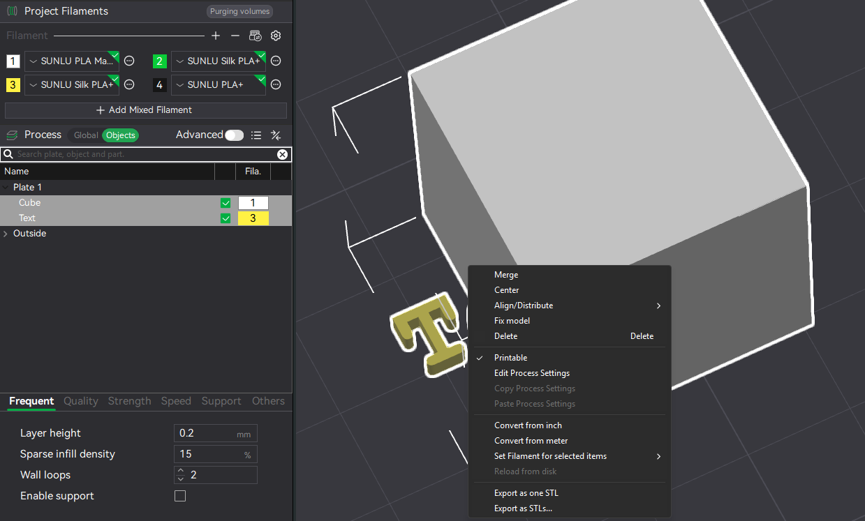

I have chosen several objects (lettering and a primitive cube to cover the lettering). After I select the objects, I would like to merge them into one object. When I right-click, Merge is not listed (see attached pic).
I am covering the letters with a primitive cube as I would like to have other text there.
Is there a way for me to do this? If not, how can I cover the current text with my own? TIA

Unfortunately no, I have no assembly listed on the side bar.
I guess I will just put my new text on top of the primitive. Normally I like to have as few objects as I can.

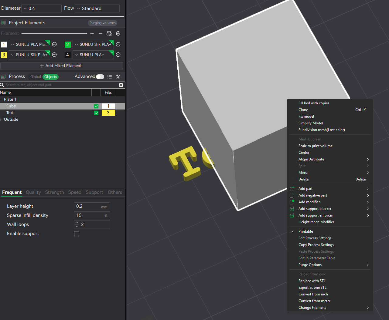

What version of bambu studio?
Are you sure you actually have both selected? My Bambu studio does not allow me to “Clone” when I have more than one object selected.
Your right click menu suggests that you don’t have both selected:
Compare this:
To This:
You are correct. I finally put the object on it’s own plate, added the cube and selected everything on the plate and merged. I have just upgraded to 2.7.1.62 and it seems to have some different ways of selecting, moving and resizing primitives.
