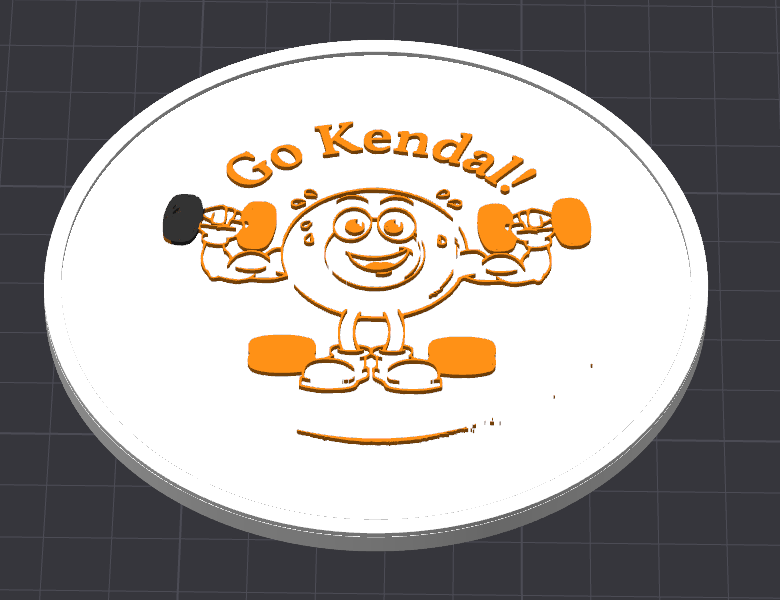

I am trying to make a drink coaster with an image I converted to SVG. The SVG converter broke the image into over 50 parts. When I imported it into BS after creating the coaster base it of course put it on the plate. Good luck on trying to put it on top of the cylinder. I merged all 50 plus parts but still cannot change the Z axis. No problem moving the Z axis on the cylinder.

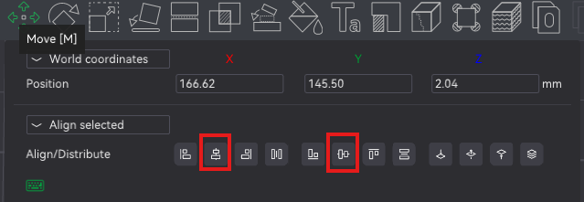

Click the Move button in the top ribbon, and click the center align buttons in both X and Y to move the whole object to the middle of the build plate.
Switch to Object view in the left panel and select the logo object (Called “merged parts” in your file).
Click the Move button in the top ribbon and click the center align buttons again to move just this part to the center, which will center align it on the coaster
Wow! Thanks. I’m not nearly that smart. I deleted the SVG then selected the coaster base cylinder and went to the top tool bar and selected “Lay on Face”
then imported the SVG and adjusted the size and that worked.
