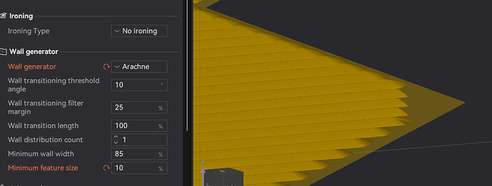

Anybody knows how can I make the slicer try to make this as pointy as possible?
Arachne wall generator with a low minimum wall size
lower line height
if its on the bottom layer: elephant foot 0.00
Layer height is 0.08 and Arachne is enabled, the result is the same if I lower the minimum wall width from 85% to 15%:
It’s not the bottom layer, I don’t care much about how sharp is the first layer.

I’m not asking for the printer to give me a wonderful result, I’m asking for the slicer to, at least, try. 4 layers with the exact same geometry is not what I expect from the original geometry.

I don’t need help cutting tape, thanks, this is a software question, the slicer is not following the original geometry, it’s rounding the saw teeth making them blunt. A 0.2 mm nozzle with 0.06 layer height has the same issue:
In this example I can see 3 consecutive layers with the exact same path, effectively rounding the teeth of my geometry instead of following it, I’m not even printing anything yet, it doesn’t matter how big or small is the nozzle or the layer height, the path created by the slicer is not following the geometry of my model.

Do you have “Detect thin walls” on or off? If Studio thinks something is too small for the printer it will just disappear. I made some Christmas ornaments that came to a sharp point and it was happening for me too. I ended up rounding the very tip. When I printed them they still looked pointed unless you looked at them very close up.
I’ve tried “Detect thin walls” on and off. Also tried Arachne on and off. There is no difference.
Would remove small overhangs help ? assuming you havent already tried disabling that
When you turned on Arachne do you remember what you had “Minimum feature size” set to? 10 is the smallest I’ve ever been able to get something to show.
Try this, just as an experiment. Scale it up and slice it just to see if it looks correct. If it does it’s probably too small for Studio to show.

I don’t see any difference between “Minimum feature size” at 10% or at 1%:
