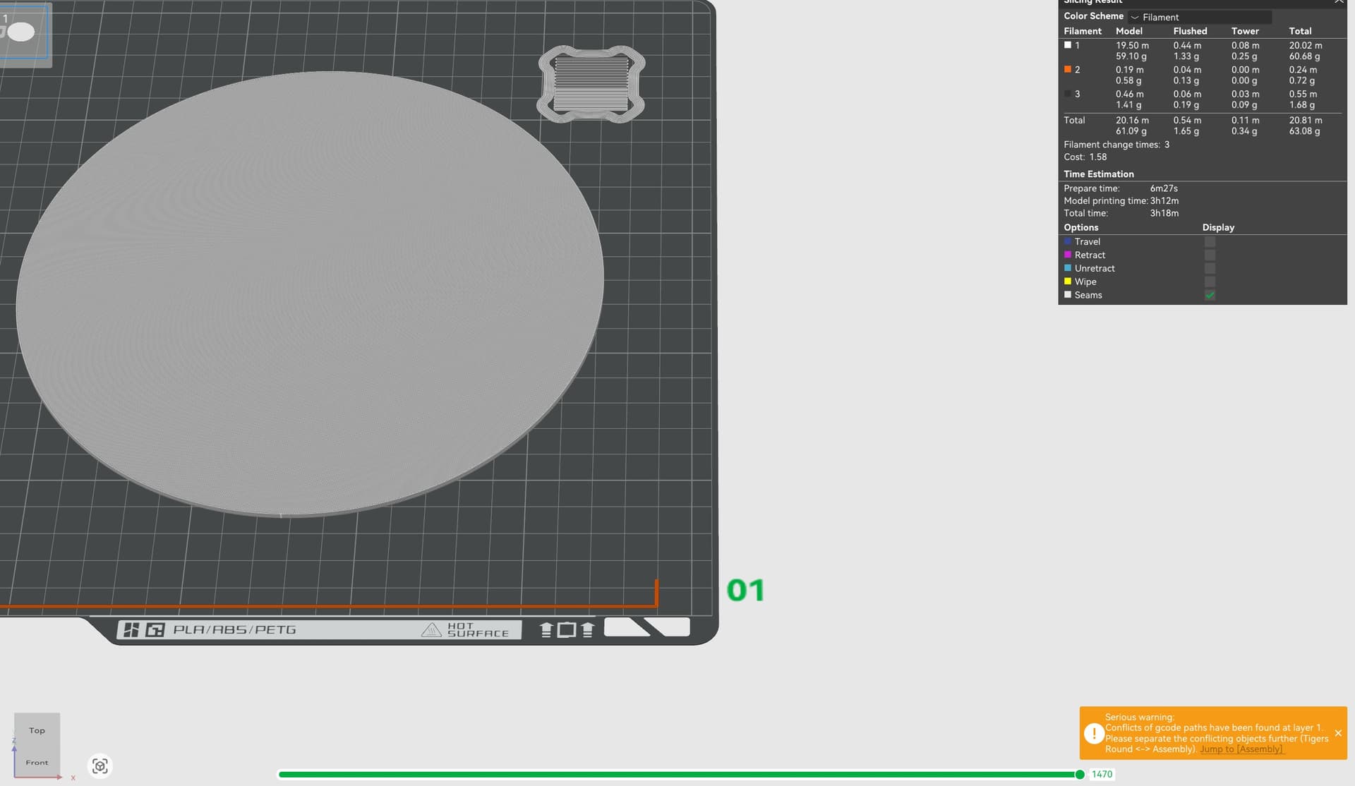

I’m a newbie and probably have bitten off more than I can chew. :wink: I’m uploading two photos. I have designed five SVGs. Three are three-color SVGs making the tigers face. A fourth is a text SVG and then there’s a 185mm circle that covers the other four. The SVGs are designed with a vector program and exported as SVGs. Then imported into Bambu Studio, size is corrected and thickness added.

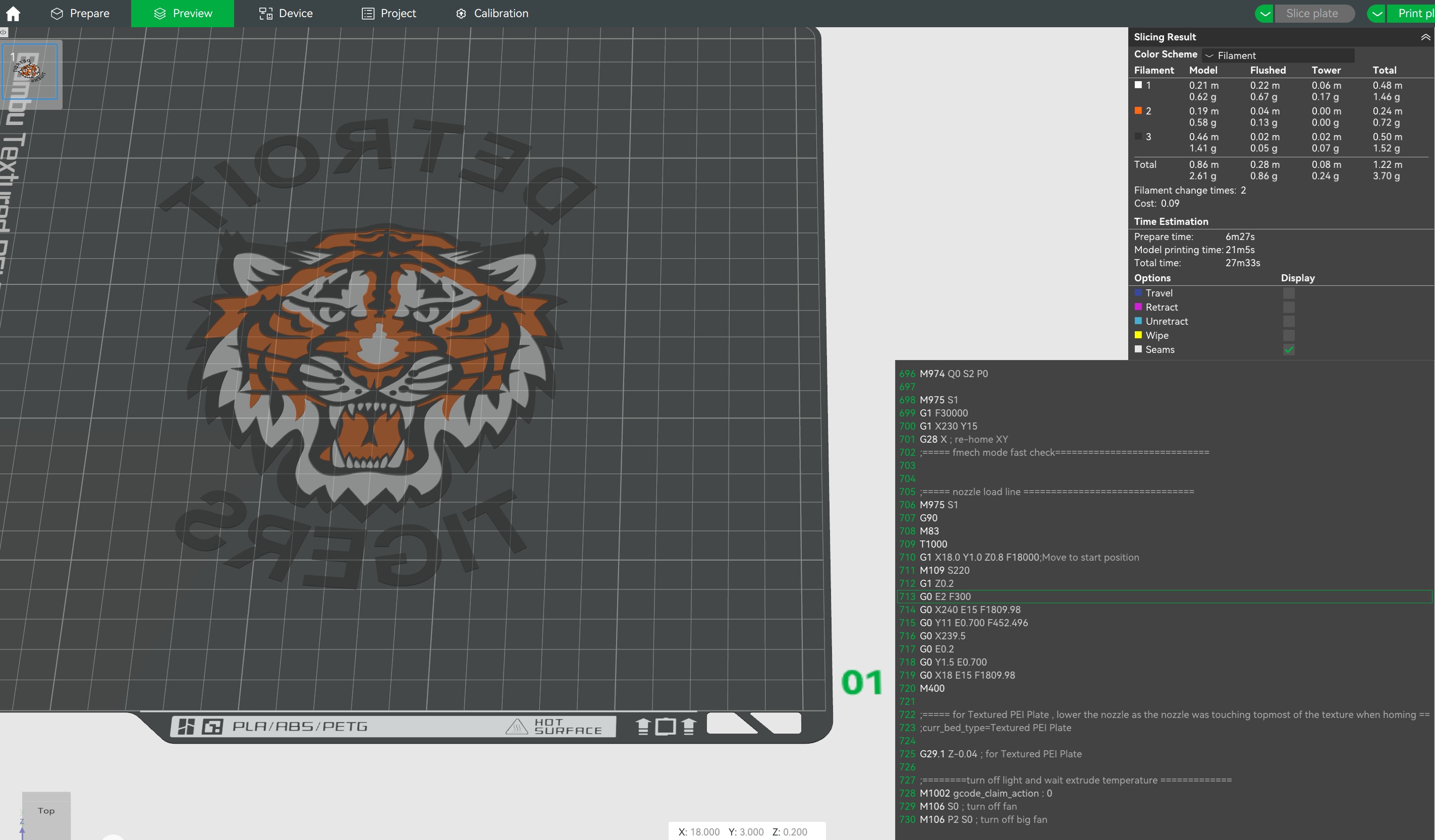

Before adding the circle base I Previewed the three tiger and text models, (all are .4mm thick) and there were no errors.
Adding the 2mm circle is when the error occurs. I watched a couple YouTube videos on modifiers but I don’t see the connection how to use them in this case.
Watching replays in Bambu Studio I can see where the first printing begins with orange filament in the tiger’s face then skips printing
the white and black in the face but does cover the entire disc surface with white. That would be an error as those face portions would be covered.

You’ll want to toggle the Global ↔ Object slider on the left to diplay the build tree. You can then select all 4 objects by clicking them while holding shift, right click on any of the four, and select “Merge”. That places all four of them in an assembly.
Next, you can reorder the assembled objects in the build tree by clicking and holding and then dropping them in a different sequence in the assembly.
Try moving the circle to the top (or bottom? Soryy can’t recall atm).
Modifiers are even easier and more fool proof. But they are best used per color (i.e. one white part, one modifier per addituonal color). Keep in mind that you can change object types between positive, negative and modifier pretty freely by right clicking on them and choosing “change type”.
This worked for me when I needed to combine 2 pieces together
