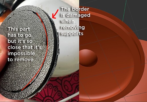

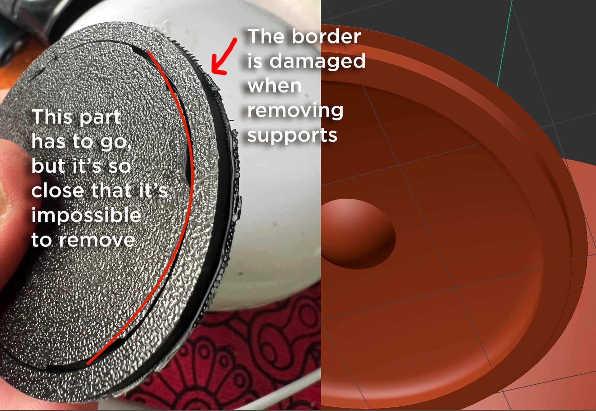

Hello everyone.

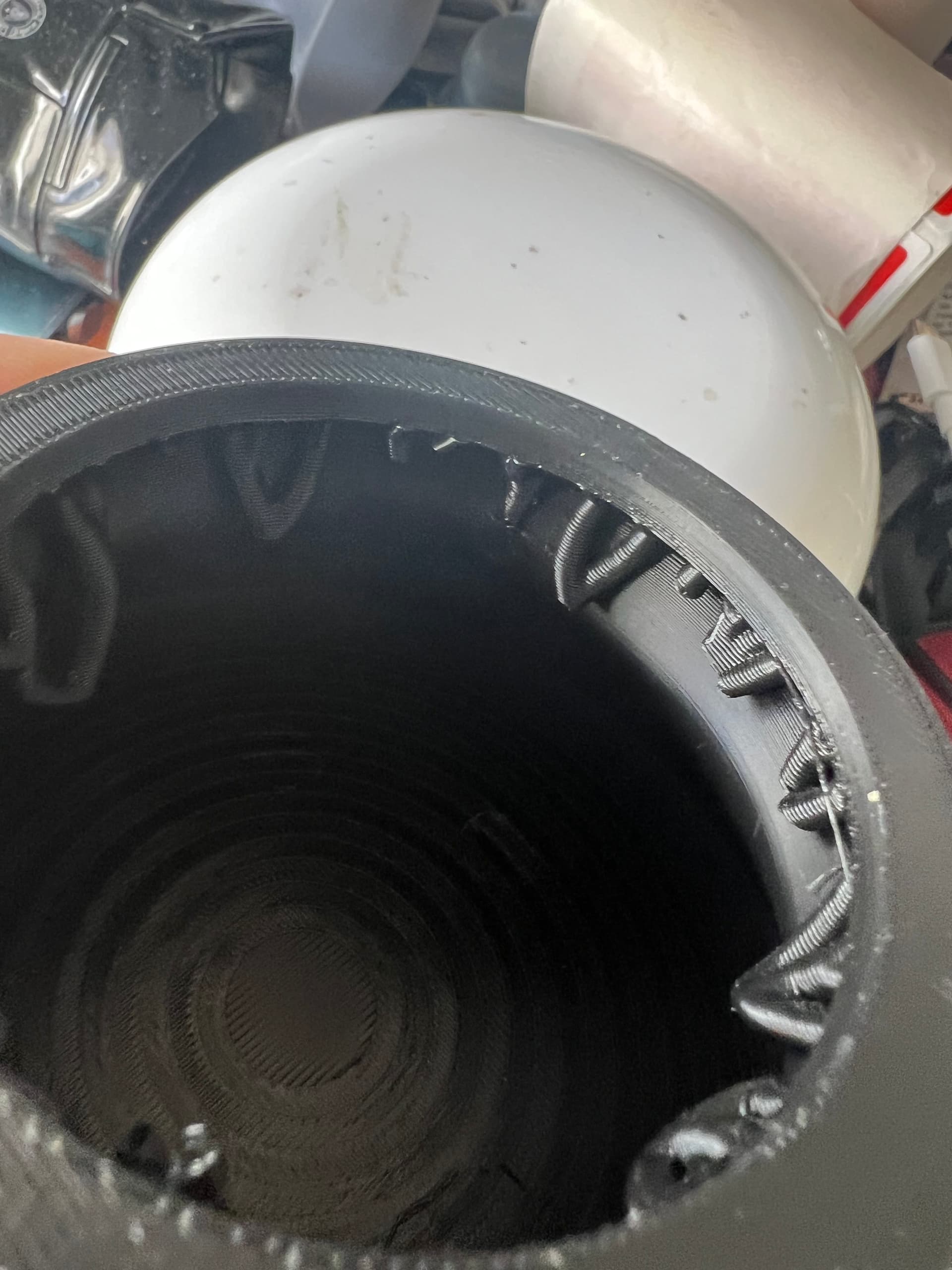

I’m printing some containers that are divided into three parts. The print was done with the pieces lying flat on the build plate.
However, the supports can’t be removed properly. And the ones I do manage to remove leave marks on the surface of the piece.
Please have a look at the photos.

To less walls. Your part isn´t stabil enough to remove the support without damage.

No. It’s the model’s issue. With this model’s geometry, without an H2D or multi toolhead printer, you’re gonna suffer a lot with no doubt. Even with H2D it’s still challenging to make high quality print with this geometry, but at least it’s now doable.

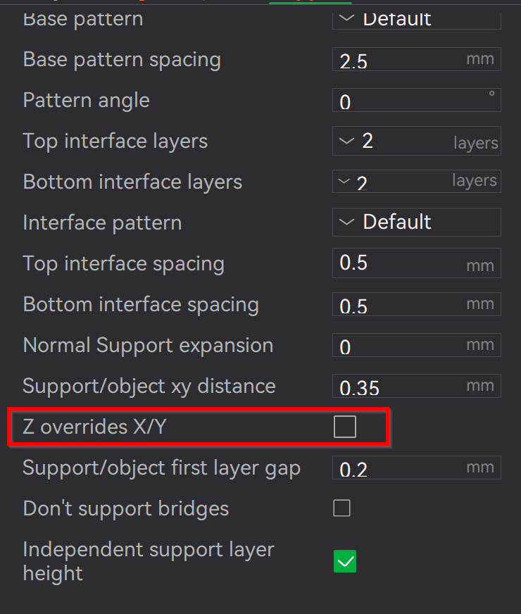

Check if this setting is disabled:
If this is enabled, the XY offset is equal to the height offset.
If you are printing with specific support material and zero Z-offset, your XY offset is zero also and fuses definitely to your part.
This setting is new in the latest Bambu Studio, and I already noticed that .3mf files that have been created before, sometimes get this toggle enabled.
