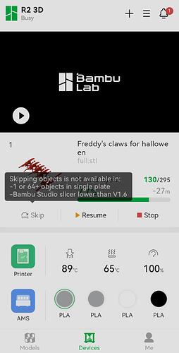

I dont know why i cant skip object in a multi object print.
I did use it yesterday without issues but today and a few other times i am not able to.

Did you merge your objects? Then, there’s only one on the plate.
oh! it was a file i DLed. Now that i think about it, it was most likely that all the parts were merged.
If it happens to me again, i will check if the parts are merged.

I dont know, sometimes skip works and other times it does not.
i know it does not work if items are merged.
however, i cloned 1 item 61 times and send it to print.
sometimes i am able to skip items on a print, i was able to do so a week ago.
today i had to skip but was not allowed too. its the same file i used before
