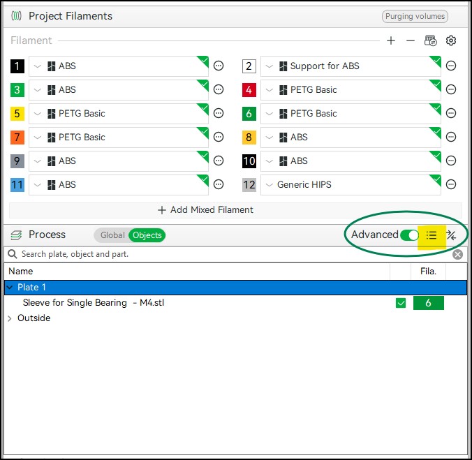

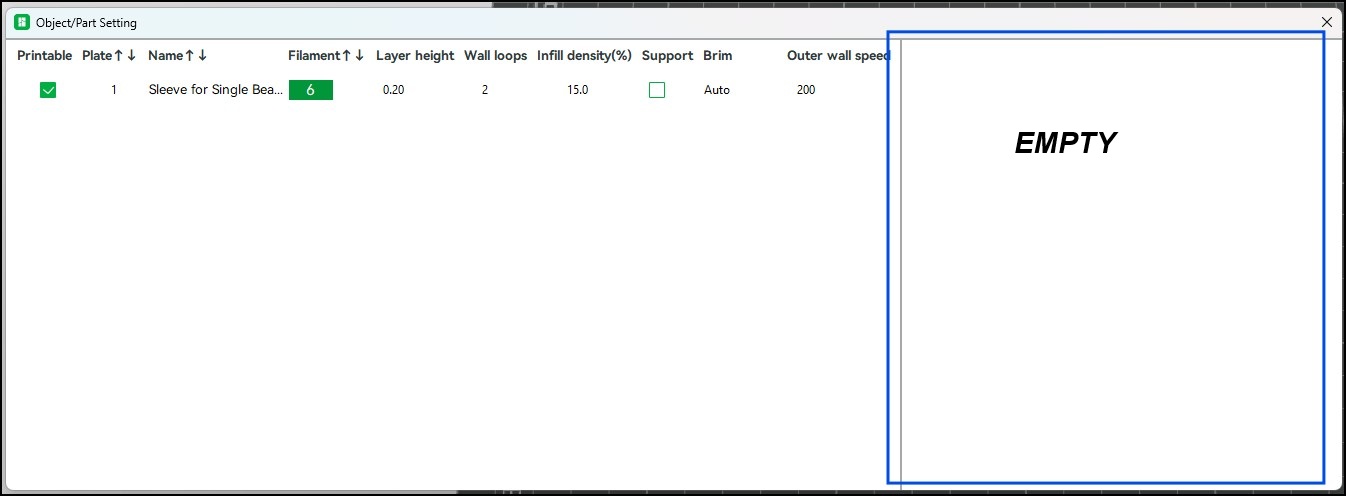

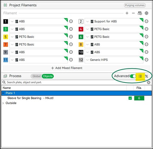

This is what I am looking at.
View all objects settings, here.

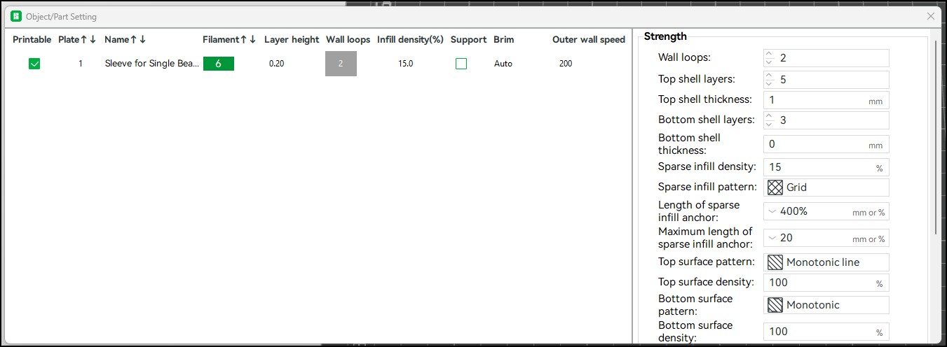

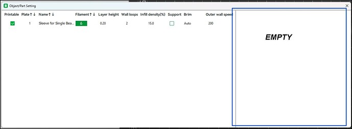

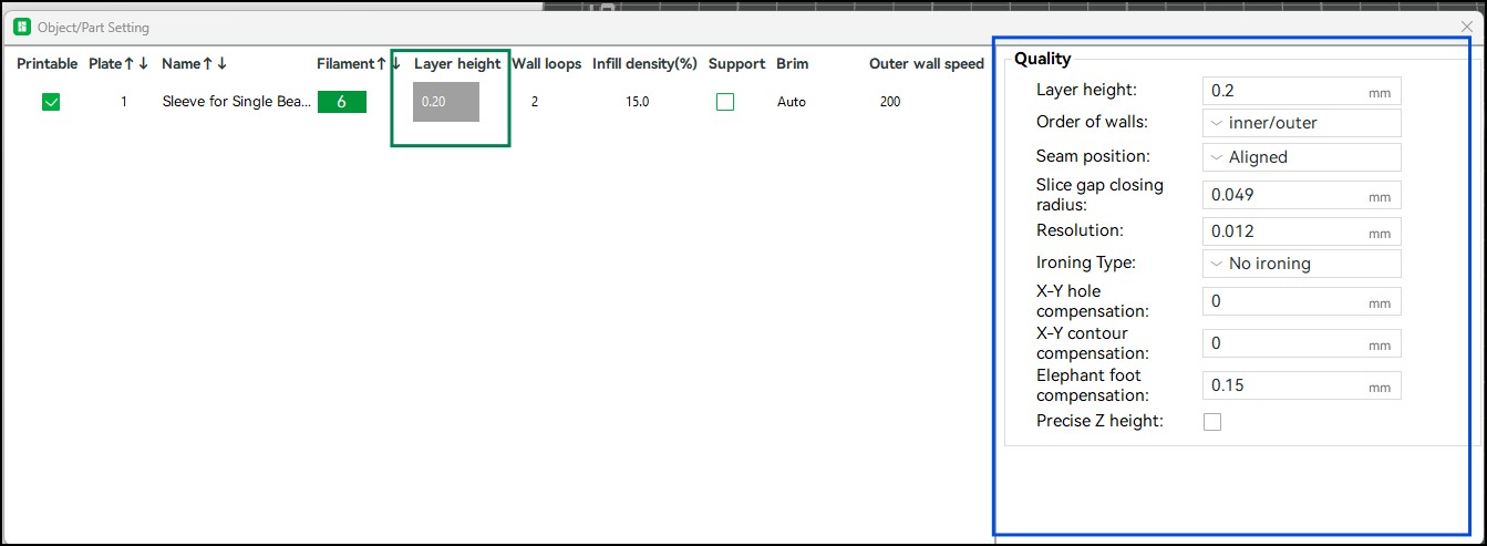

Once the table is up, it shows Object settings, here. With nothing selected, you get a table but not everything in the Quality or Strength tabs, as shown here.

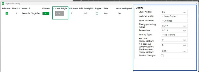

Choose CELL and one of the table items on right side, as shown here. In this instance I selected a cell that is contained in Quality.
Here is Strength.
Seems like it is a table of some variety but so far very labor intensive as far a Copy/Paste and OCR.

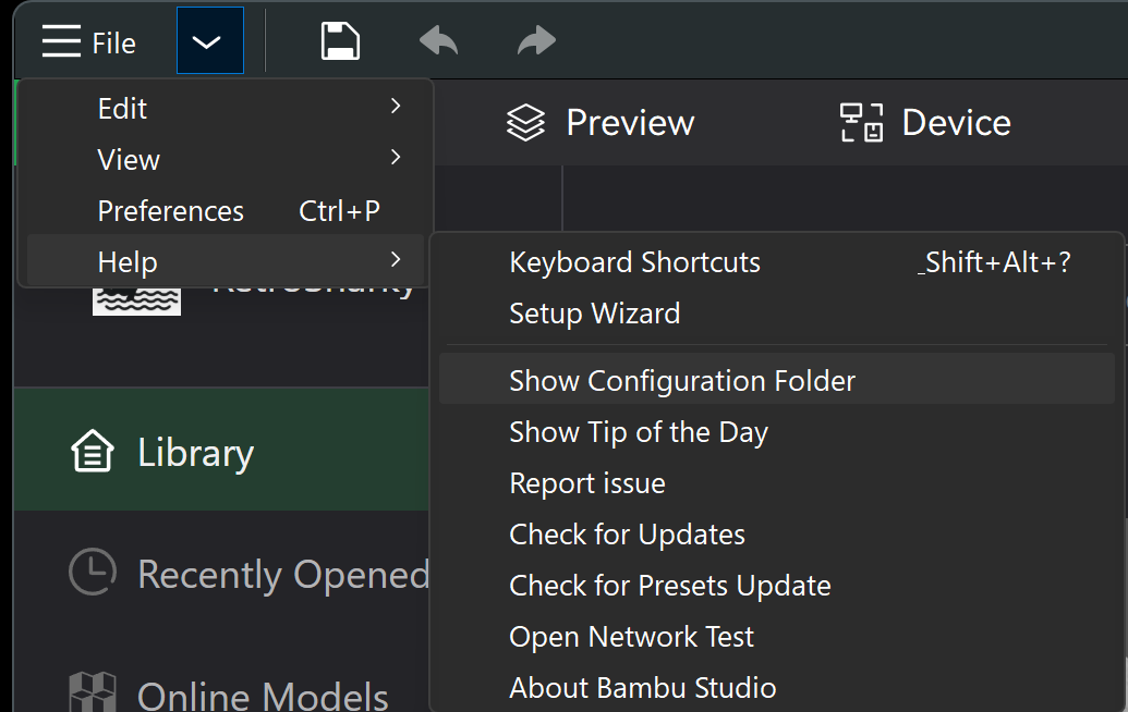

You can do the same with the profiles saved in the slicer by access the configuration folder:
There you’ll find profiles such as “Bambu Lab H2D 0.4 nozzle.json” or even ones you’ve created yourself. By the way, this applies not only to print settings but also to filament settings.

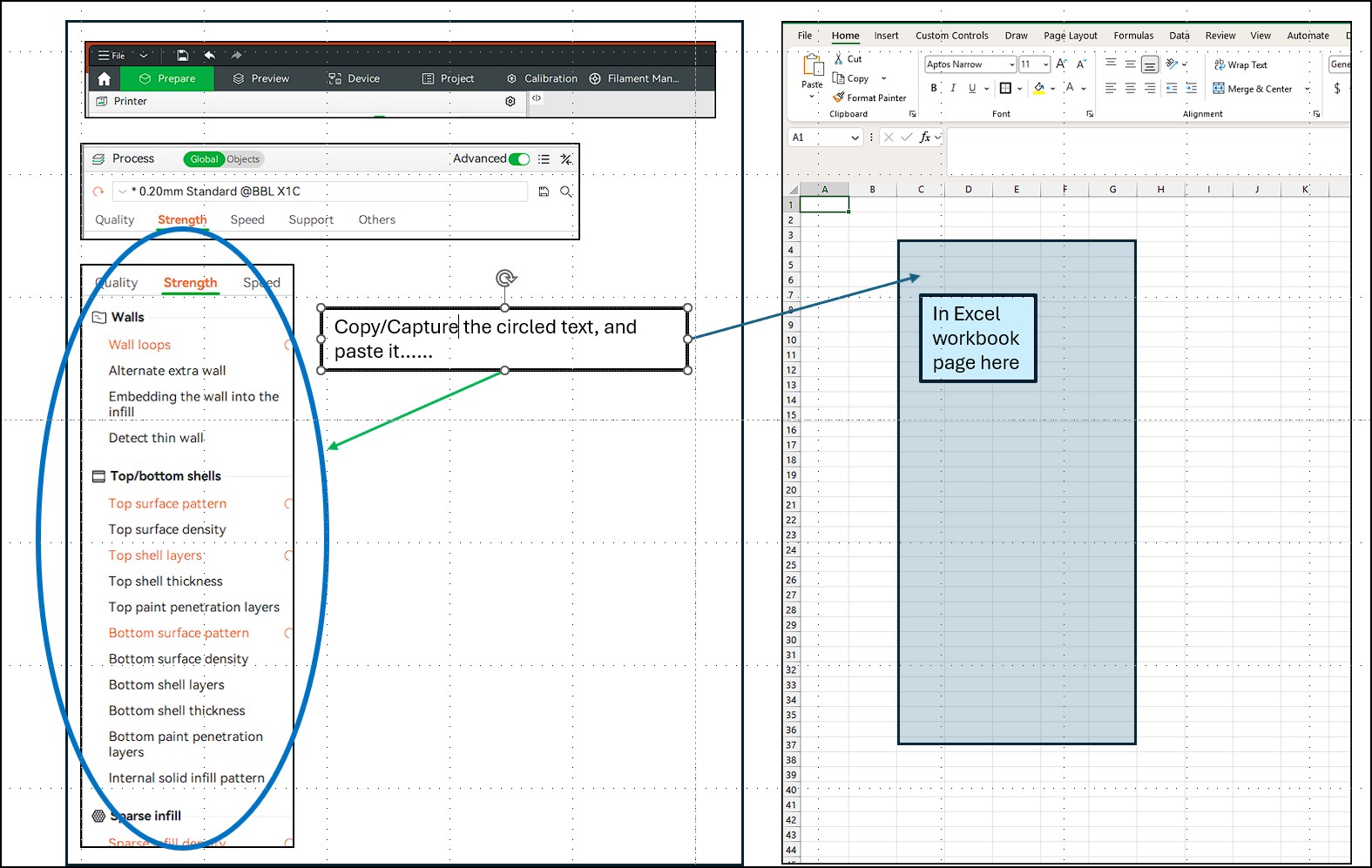

Right now, while not the ideal solution, but I snag a picture of “Strength” for example, run that picture through Acrobat’s OCR tool which fishes out the text and just rebuild it in Excel.

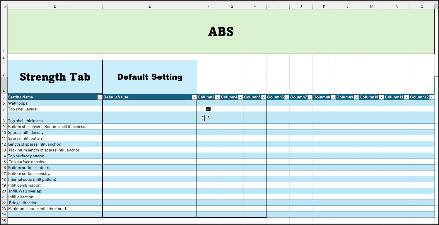

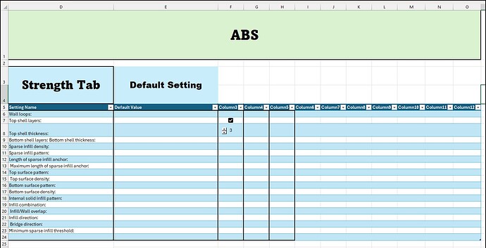

The reason I want to do this is to be able to more efficiently keep track of when I tweak those settings.
Here is a picture but this is very rudimentary. The baseline setting will be in this section and to the right I will replicate the left side but log each change. This is Alpha not Beta

For ease of description I will use my printer and all filament is Bambu Labs filaments on Bambu Labs spools which have RFID chips. I may leave out steps but broadly speaking, the way I perceive Studio to work in conjunction with a printer and AMS is as follows:
In Studio you set the following
  • I have P1S Printer
  • I have a hardened steel .4 mm nozzle in that printer
  • I am using the Engineering Plate build plate
In the AMS, the RFID chips have been read and I’m guessing stored in some bucket in Studio
You then execute File------> New Project------>Import .3mf. .stl etc.
You then tell Studio to print the model in ABS, PLA, PETG, lots of options here. This gets even more complicated if you bring other brands into the mix

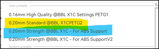

I want to end up with a long list like this. Here is why. Say I buy a cardboard spool of Proto-Pasta copper infused PLA ,which seems marketed for appearance and not a strength additive. Put a saved BL PLA RFID on an empty BL spool, rewind the filament off the cardboard spool onto the BL spool with the PLA RFID mounted and then chose process setting from the User Presets dropdown shown here. The difference being that should I want to print some Proto-Pasta copper, one click and it is ready to go. the process user preset is configured such that all I need to do is click on the following: 0.20mm Standard @ BBL X1C Proto-Pasta Copper
I’ve already done that for when I use the Support for ABS material highlighted in blue.
As a error prone and very slow typist, I would prefer to be able to just drag across the text, highlight it and do a copy/paste it into Excel for the initial testing.
