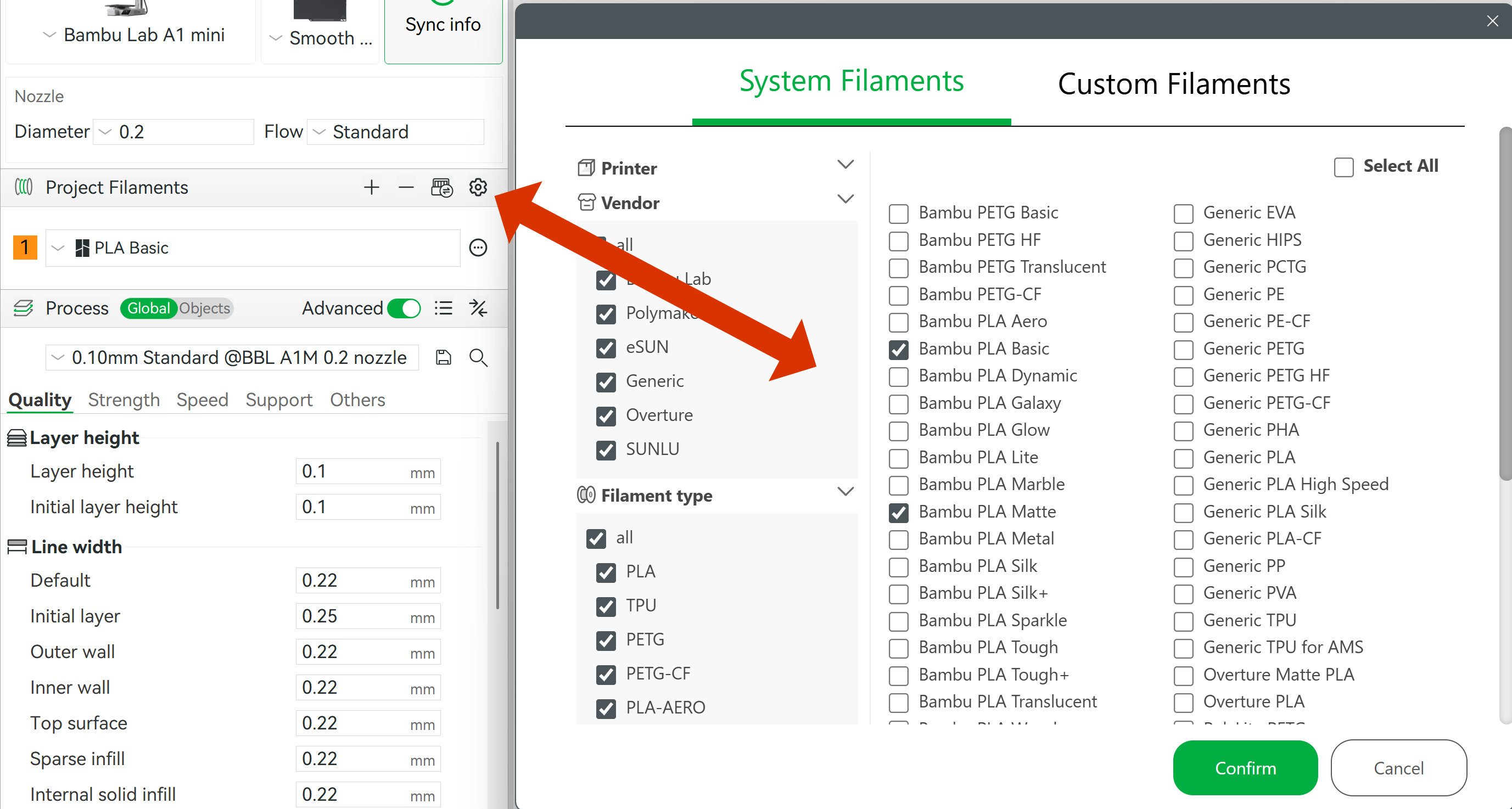

I accidentally bought a reel of carbo fiber, not PLA. Can this printer use this material? Seems there are no Carbon options. Would I need a hardened nozzle?
Thanks
Yes, you need a hardened steel nozzle.
You need to enable it:
So no way to print using the carbon? Could it cause damage, or just will likely not print correctly?
